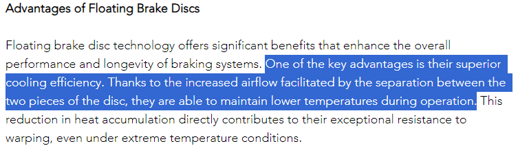

Since I am just some rando on the internet who probably knows nothing, here is a little article from a rotor manufacture.
https://www.tritonmotorsportsusa.com/post/what-you-need-to-know-about-floating-brake-discs
The cooling advantages it mentions are a result of it being 'floating' or ventilated, which the stock rotors already are. Z1 does use directional ventilation, which would help, but... once again... the effects of this on road or mild street use would be barely noticeable.
