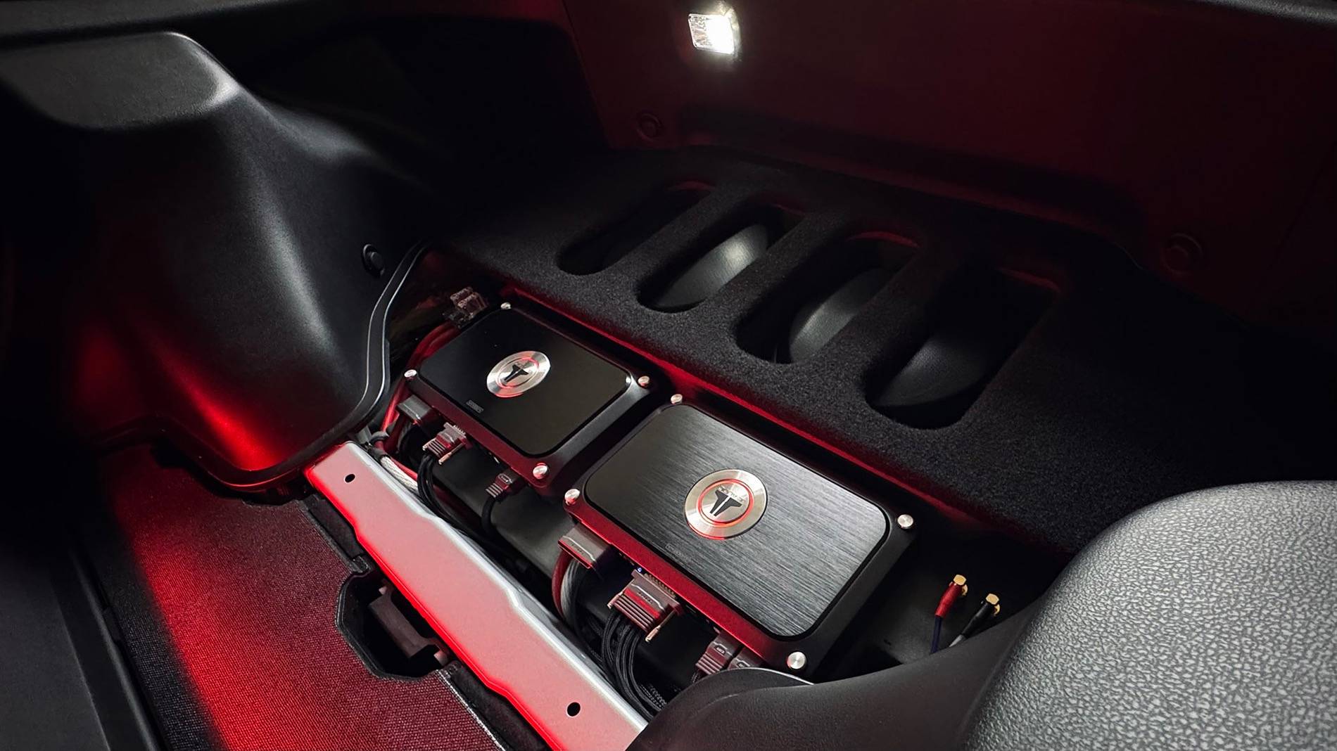

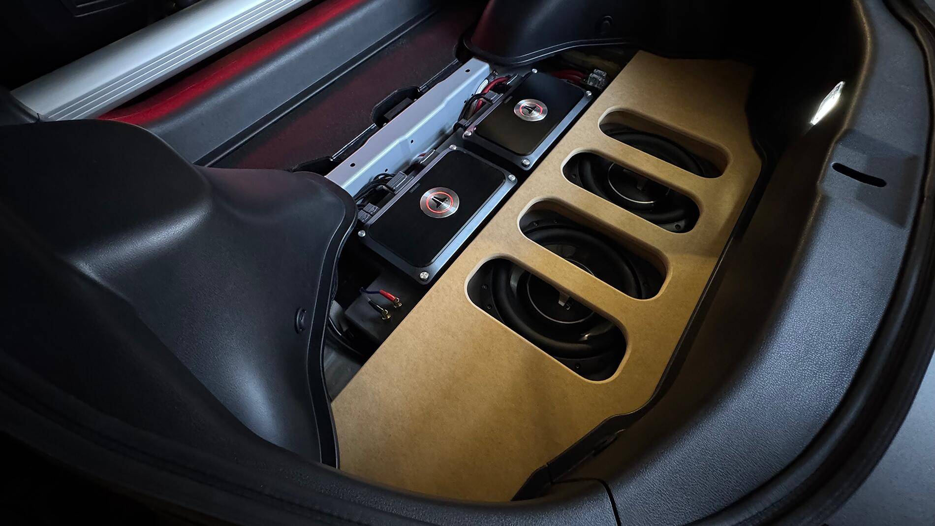

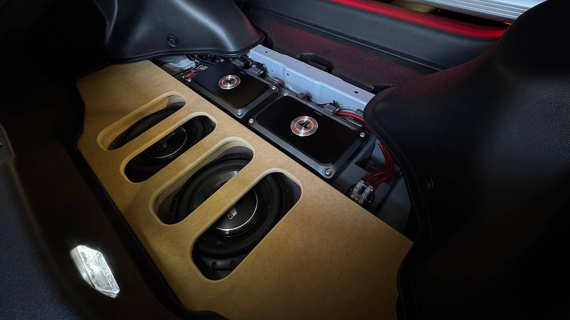

Update to stealth enclosure design since system was first installed. Redesigned the support frame around subwoofers to accommodate an extended trim panel that runs entire width of cargo area, tucks under interior edges of trim panels, and also now has supports over the subwoofers themselves with just enough space for maximum excursion. This way any heavy luggage that may be placed on top when covered by factory cargo carpet mat won't sag where voids under carpet mat used to be with original design.

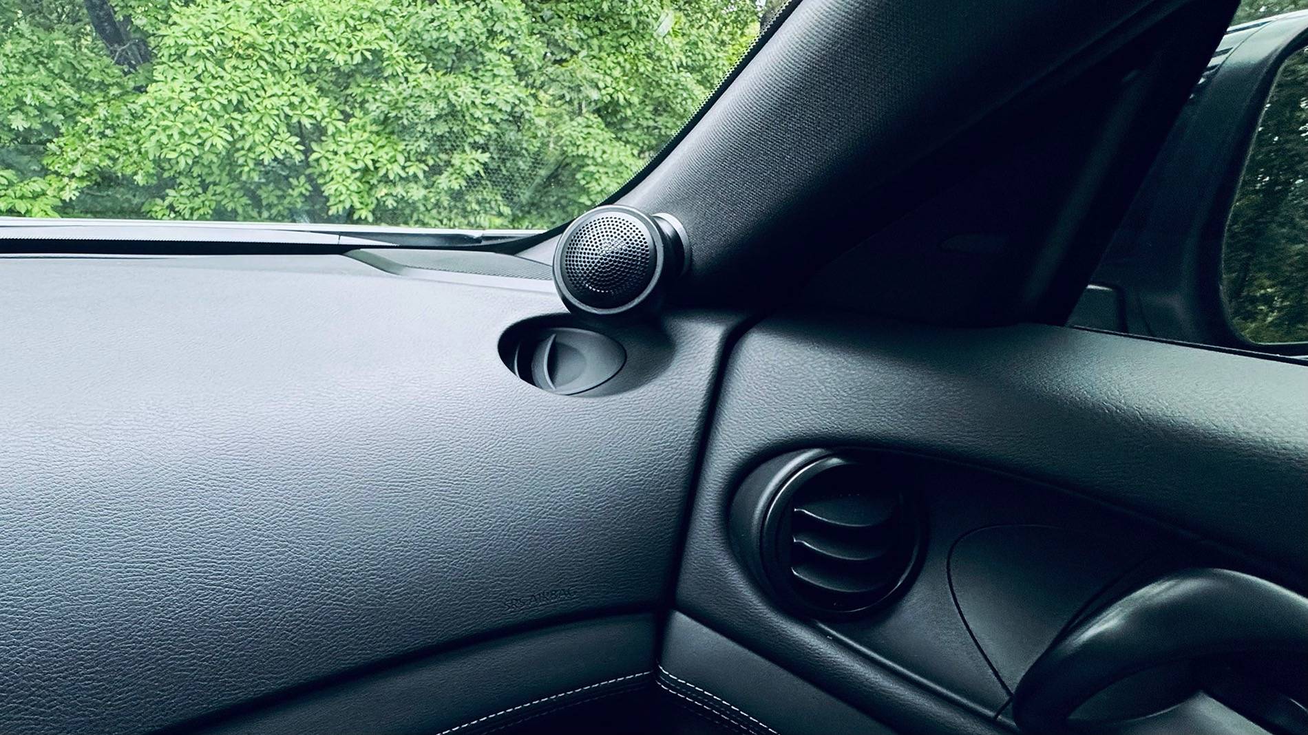

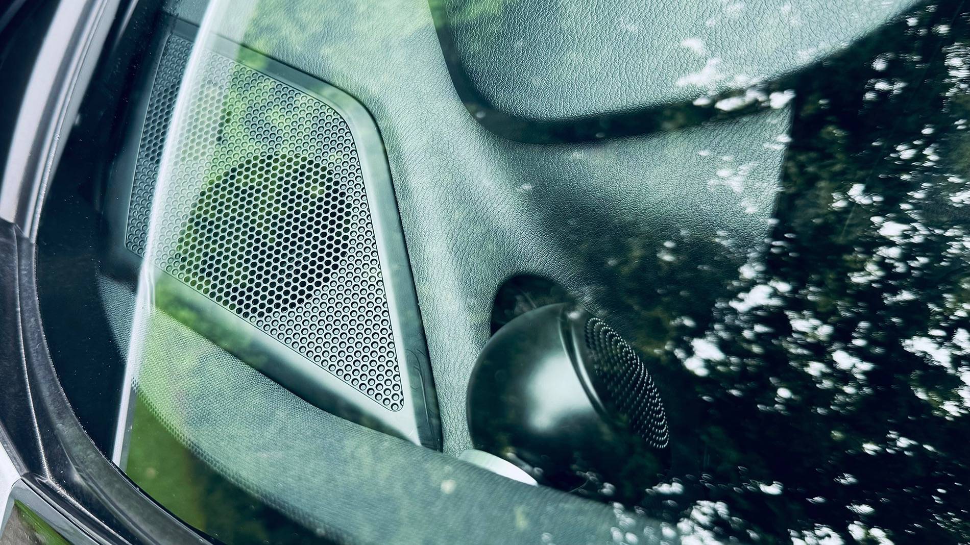

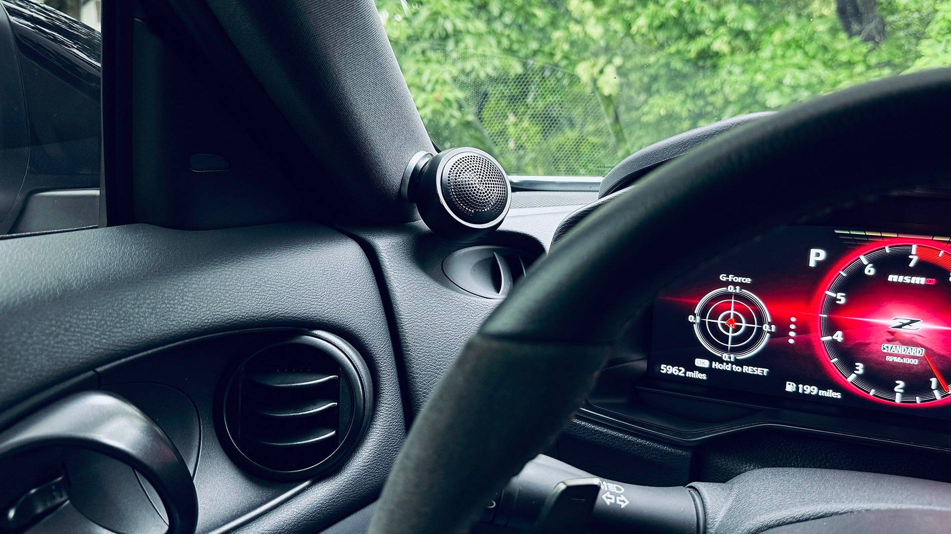

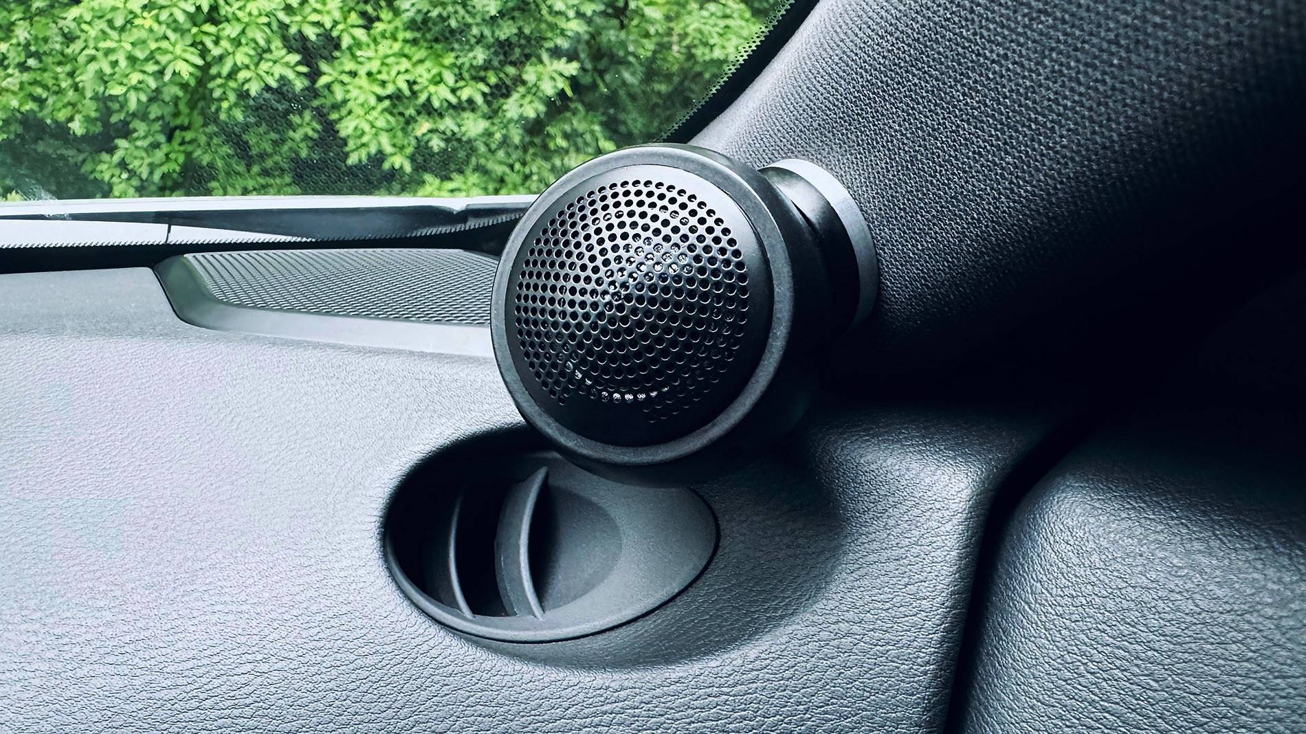

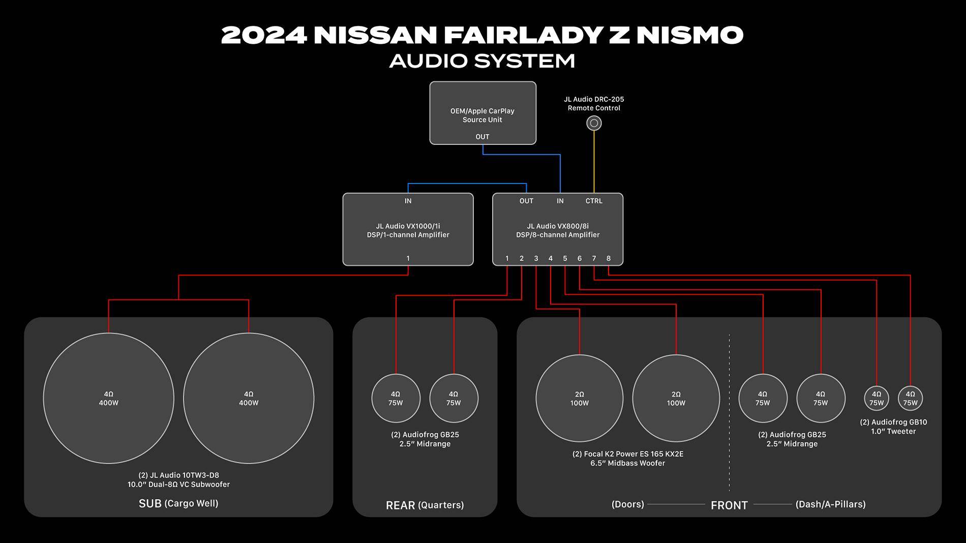

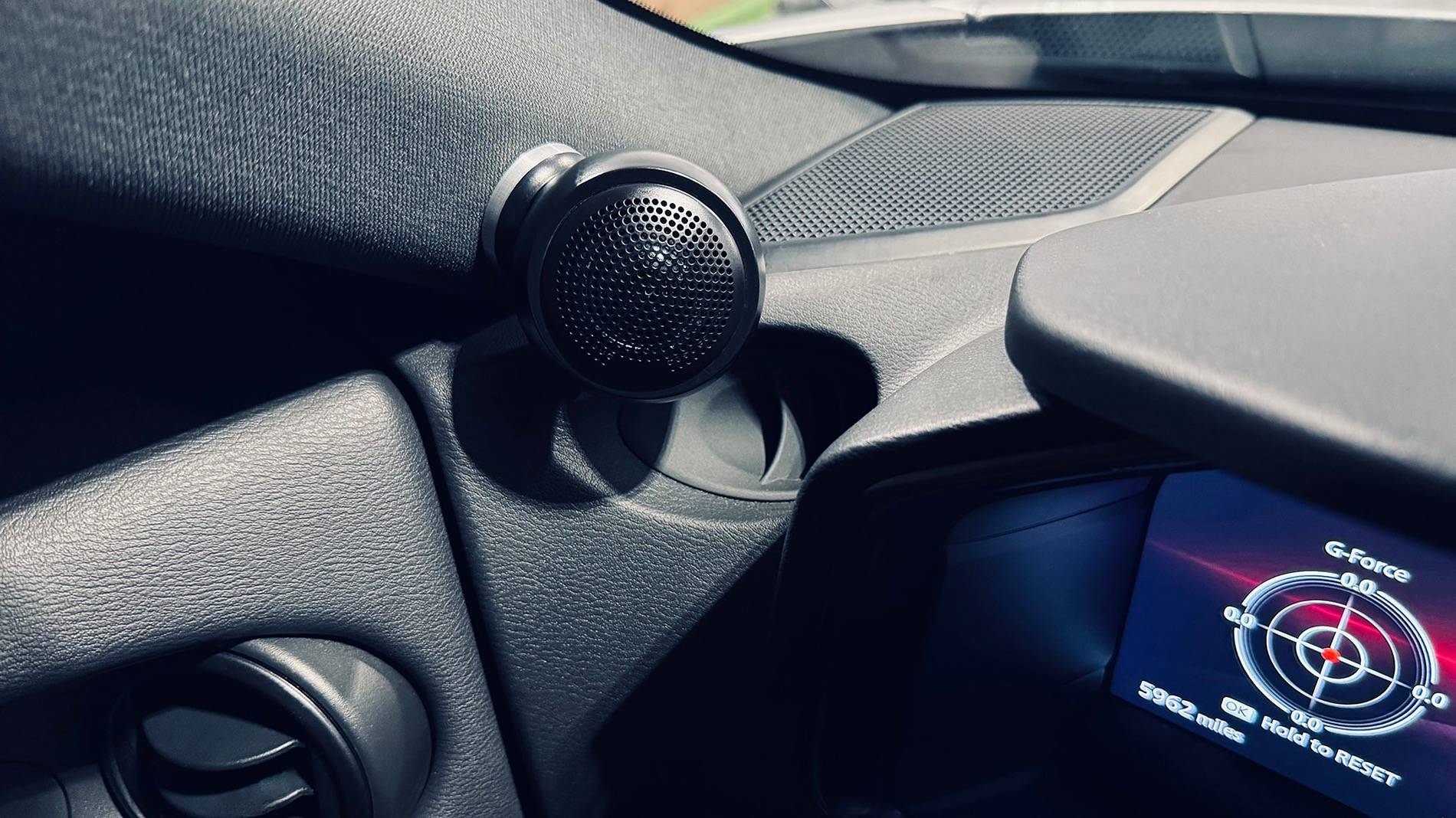

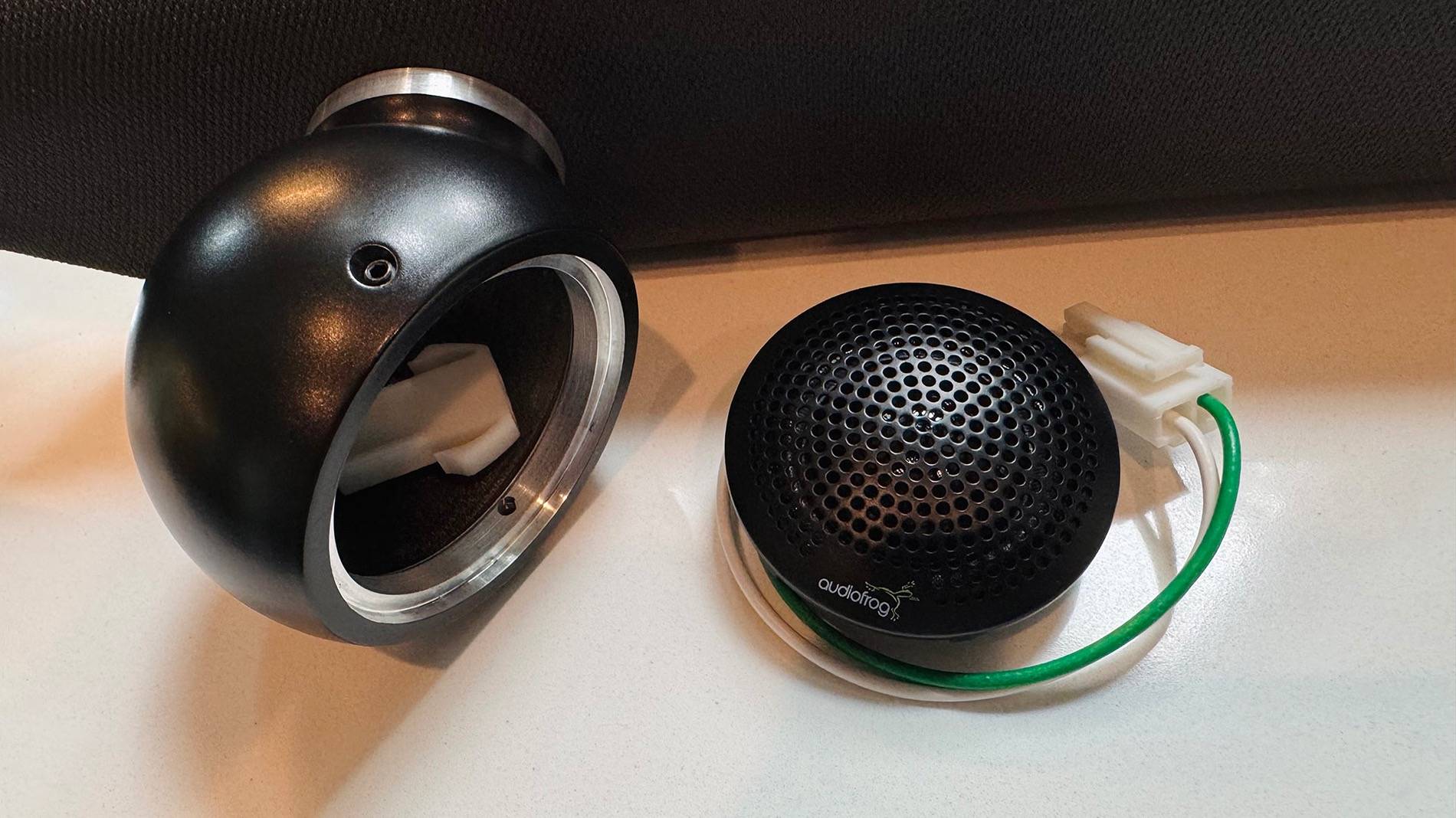

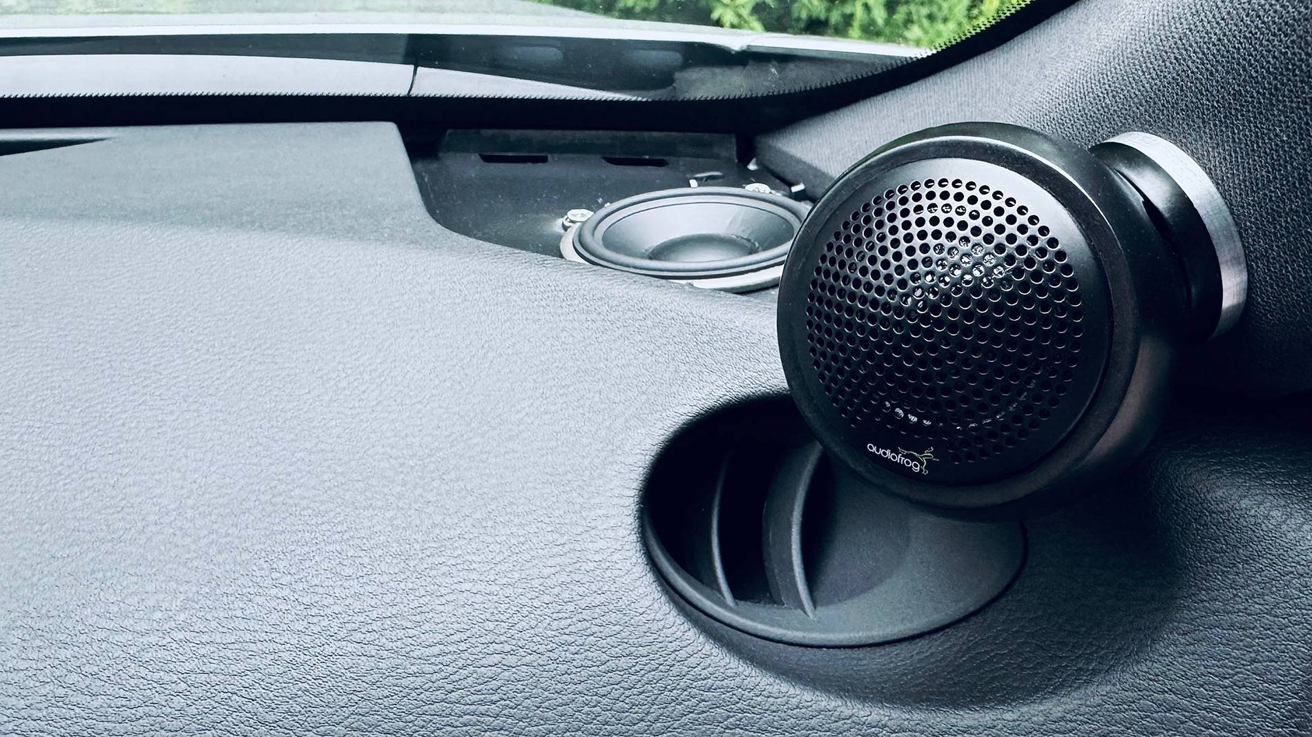

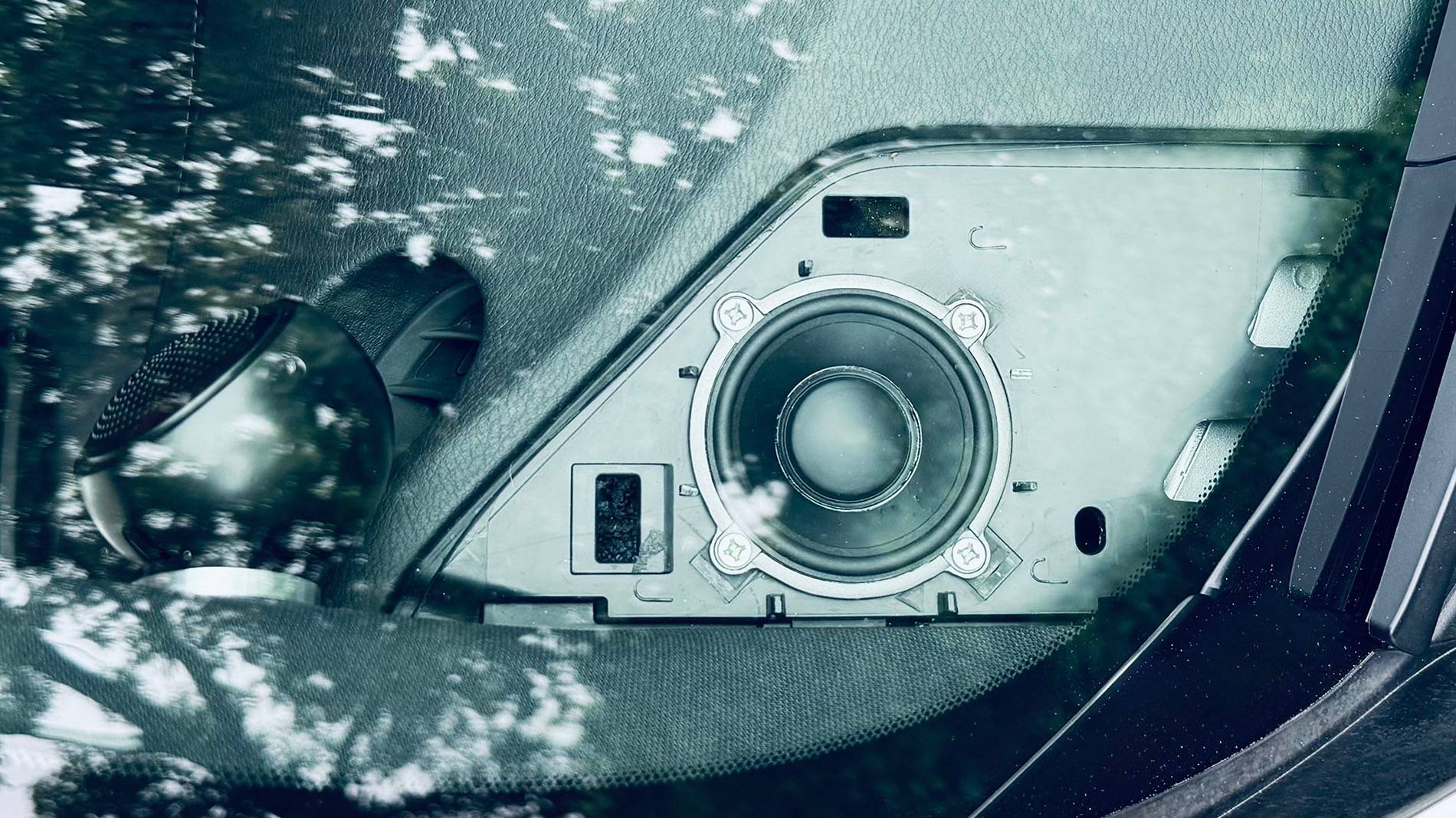

Hey all. UPDATE: I've since moved from original fully active 2-way front stage setup detailed in OP to a fully active 3-way front stage. The original 2-way was fantastic, but over the year I've been listening to it I’ve picked apart little nuances that made me yearn for just a bit more fullness, airiness, and detail, especially with sustained sounds found in certain strings and synths.

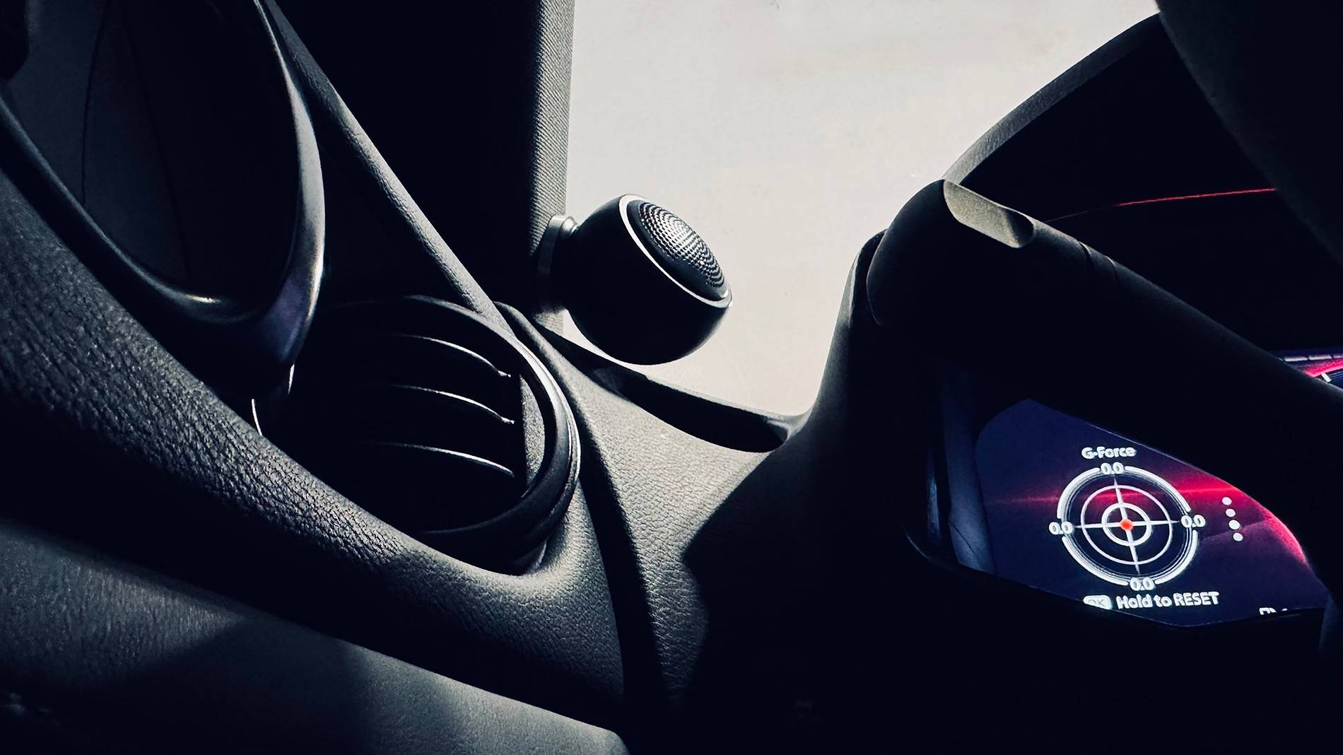

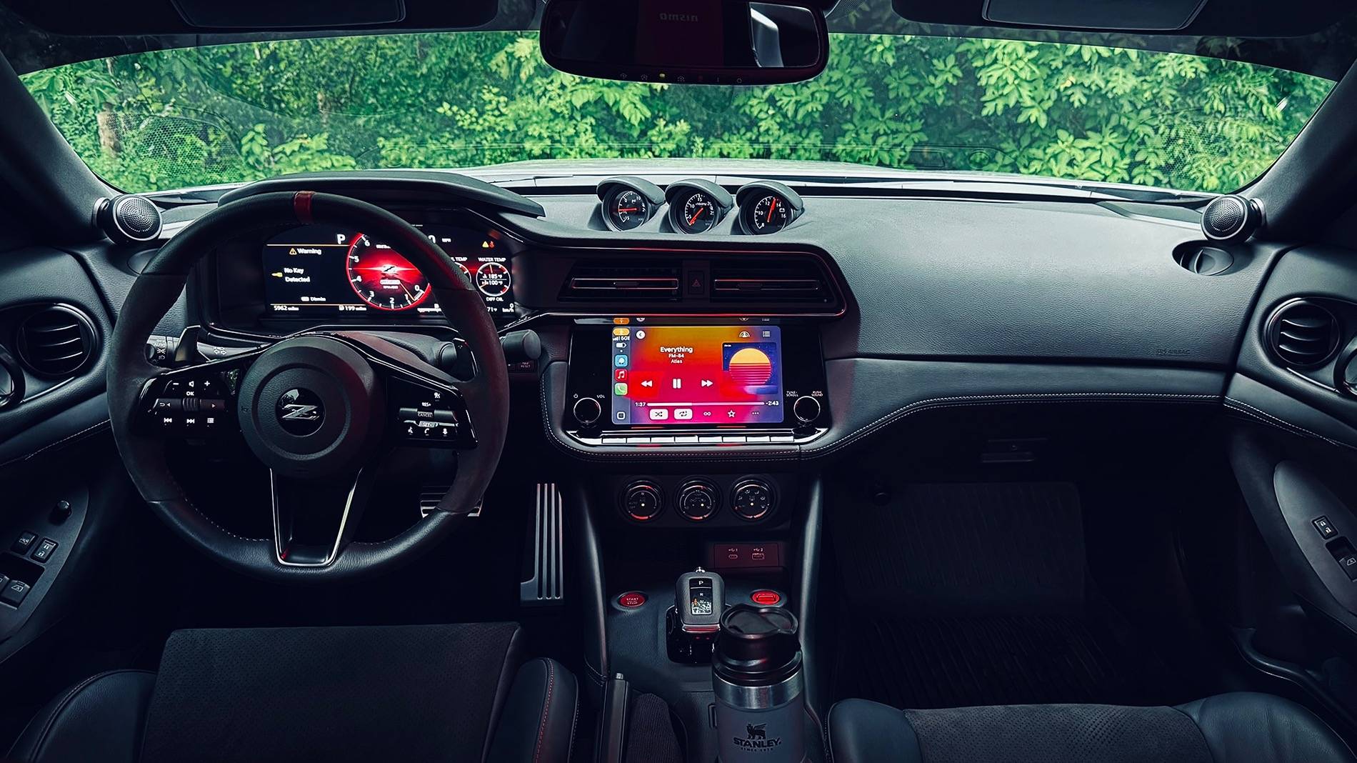

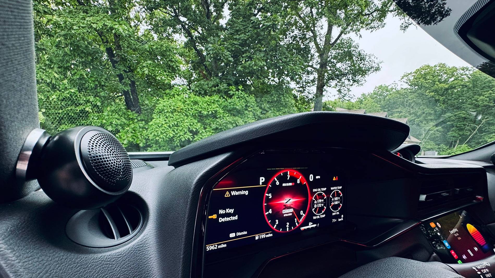

This has now be achieved by having custom aluminum pods made that house Audiofrog GB-10 (OE-0001 version) 1.0” soft dome tweeters. These pods mount directly to the Z’s A-pillars with concealed wiring path, and can be freely articulated for precision positioning. The factory dash locations, which previously housed Focal FRAK wideband tweeters (which are amazing btw), have been freed up to accommodate Audiofrog GB25 2.5” midrange drivers. Everything else about system remains as before.
The end results are exactly what I was after from past year’s critiquing and provide the icing on an already delicious cake. Staging, imaging, accuracy, and overall OOMPH have all been elevated to the point I can now confidently say she’Z now done for good. Any other improvements over this would require much more extensive redesigning of the cabin, fabrication, etc., which I’m not willing to do on this particular vehicle. Happy as a pig in sh*t and ready to enjoy more fully soundtracked cinematic roadtrips. A few shots of the updates have been added here.
PS: Still need to get the tweeter pod bases re-anodized satin black due to the exposed raw aluminum along their outer perimeter edges from CNC process getting them the exact size to mate with flat area of A-pillars (purely an aesthetic issue).
