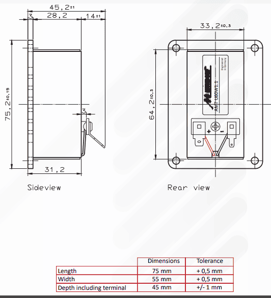

It can go down to 2.5 K. I am thinking about using the Mundorf AMTU60W1.1-C Air Motion Tweeter: https://www.madisoundspeakerstore.com/amt/mundorf-amtu60w1.1-c-air-motion-tweeter-4-ohm-94-mm-round/
And this unit in the doors: https://audison.com/product/th-6-5-ii-sax/ These can run up to 1K. My rears will fill in minor valley between 1K to 2.K
Any thoughts?
I have no experience with those Mondorf tweeters so can't really comment on them other than 1) at 94mm (3.7-inch) highly doubt they will fit in the factory dash locations without possibly major surgery (if that's where you're planning on installing them). And 2) even if you do somehow manage to install them in the factory dash locations I would first fully vet with those who have experience with them that they are suitable for off-axis performance. My Spidey senses tell me that type of tweeter may not perform well off-axis, but I could be wrong.
My other thought is that you do not want to have a gap in frequency range in the front stage thinking that it will be filled in by rear fill speakers as that would highly compromise staging and imaging. My personal opinion/taste is that rear fill speakers should only be used to slightly augment the front stage using filters and time delay so that the front stage is lifted and broadened while adding a bit of ambience. Rear speakers should never be used to fill in front stage gaps (talking midbass and up here of course, not subs).

Mr Mac. Thks again for your attention. They are just under 3.00 without the round bezel. I was planning to mount horizontally. Over on the diymobileaudio site, there are many fans of this design and some are highly recommending it. Its critical that the door driver fill in as high as it can. That's the big unknown for me right now. I will ask them about the off-axis performance.

Ok, here is one users experience:
AMTs usually have great dispersion left to right when they are installed vertically but have a smaller sweet spot height wise. The inverse is true when mounted horizontally. I have seen them used both ways successfully in a vehicle, run some tests and be careful of your final aiming

zermatt – No sweat. Please let us know what you learn about the off-axis performance. Would definitely like to learn more about that.
Regarding "critical that the door driver fill in as high as it can" – Just keep in mind that the higher the frequency the door speakers play the more directional/locatable they'll be heard by your ears. This may or may not be important to you depending on how high/elevated you want your front sound stage to appear. Time delay can certainly help with getting things sounding how/where you want them to beyond their physical locations, but there are limitations.

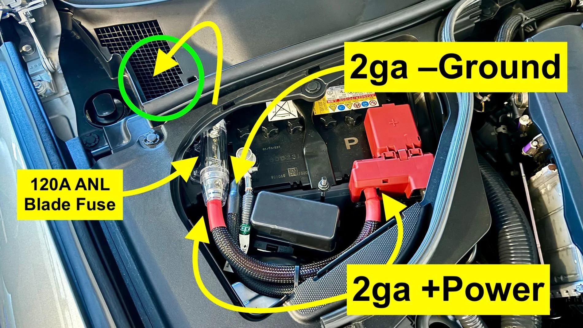

The battery cable: what gauge did you use and how did you fish this into the interor of the car?
After my total current requirement was calculated I arrived at 2-gauge for both + and – power cables (like speaker cables also JL Audio) being more than suitable for this system. >>> https://www.jlaudio.com/collections...roducts/xd-rpw2-50-car-audio-power-wire-90345 and https://www.jlaudio.com/collections...roducts/xd-cpw2-50-car-audio-power-wire-90349
There's a large rubber boot located on passenger side firewall directly behind battery that provides very easy passthrough access for routing + power cable from engine compartment to interior and on back to cargo well. Just pop off the plastic panel frame shown here (see attached pic) and you'll find it where the green circle is. That 2-gauge + power cable meets a 2-gauge fused distribution block next to amplifiers where it splits into two individually fused 4-gauge cables, one for each amplifier. Each amplifier has a short 4-gauge ground cable that runs directly to a prepared chassis ground point in cargo well.
About a 10-inch 2-gauge + power cable connects battery to master system fuse. There is an open factory +12VDC stud located underneath the protective red plastic cap. I trimmed an opening in that cap to allow this stud to be used for connecting this cable that goes directly to master fuse. (see attached pic)
To ensure optimum current flow I also upgraded that factory ground by running a short 2-gauge cable (~1.5-feet) from battery's negative terminal to a prepared ground point on chassis as the factory ground cable is a bit small. (see attached pic)
