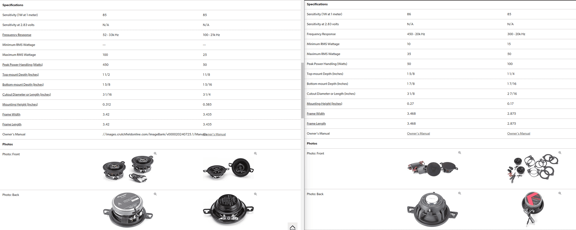

Mr Mac, thanks for being our audio advisor.
Can you confirm the Pioneer TS-A879 fit in the rear, Cruchfield says otherwise? Idealy I would put the JL Audio CF-350mt back there if we have extra room.

Can confirm Pioneer TS-A879 does fit as that is what I have already installed. As far as I know, JL Audio CF-350mt will fit too because it is also a 3.5-inch, and in fact that's what I was originally going to go with for rear fill, but chose TS-A879 instead because they are substantially higher power handling than CF-350mt.
PS: Crutchfield unfortunately does not have their ducks in row when it comes to many vehicles in their database. They are notorious for having bad data on this sorta stuff.

Oh thats fantastic! Depth space was the concern. If it fits the JL CF-350m would be ideal. The Pioneers are backordered for a few months, plus I have the JL Audio C3-600 and JL Audio 10TW3-D8 as the other speakers. I know it isnt important but for some reason I prefer to unify brands. I was just regarding these rear speakers as filler.
