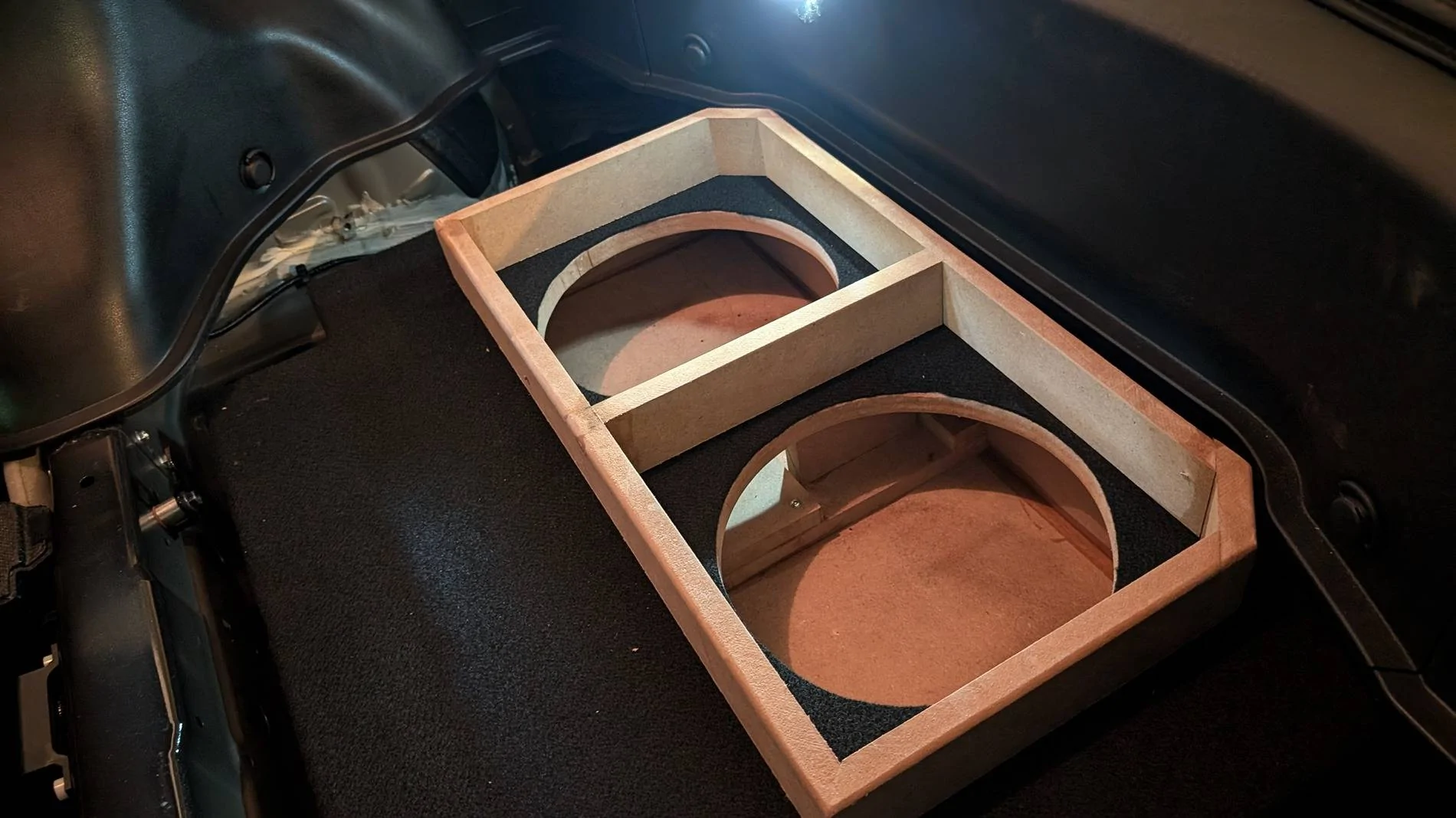

Below is my concept sketch of the amp platform. I will have two levels, lower level, will have the 4 awg wiring and distribution blks (22 x 32 inches) . The upper level have the electronics (22 x 34).
I see that you blot into the central Bose subwoofer post.
1: Does the bottom the your sub cabinet rest on the floor of the truck area.
>>> Yes, bottom of enclosure rests on floor of spare tire area, which has been treated with sound damping material (as shown in one the photos), and the recessed notch in bottom of enclosure also mates and rests on spare tire mounting nub which has a rubber gasket between them. The entire enclosure is bolted to the vehicle using that same spare tire mounting nub and a matching bolt/washer (also shown in one of the photos).
2: Its looks like that the top of of your sub/amp cabinet is flush with the Horizontal cross frame, and, the stock 1/4 plastic/cardboard truck cover rest on those surfaces.
>>> No, enclosure is much lower than the cross frame to allow space for the amplifiers and subwoofers' top frame support. This way the top surface of the amplifiers is below the cross frame height when mounted, and so that there's a tiny gap between the two when the cargo carpet layers are installed. I don't use the stock plastic cover any more that the factory puts under the carpet layers. Put it away in storage. No reason for it since the subwoofer top frame now provides support for the carpet layers, not to mention plastic like that tends to rattle, which I of course didn't want.
3: Base on your box dimensions there is about 7.5 inches of height (bottom of truck to the 1/4 plastic/cardboard truck cover).
>>> Total outside height dimension of the enclosure itself is 5.4-inches. Total height of the subwoofers' frame is 2.25-inches. So when the frame is secure to the top of the enclosure the total height is 7.65-inches, which places the top surface of frame about 0.125-inches below the surrounding plastic interior panels, which is dead-on perfect because there's no contact between them when all is completely installed (including the thickness of the sound damping material underneath the enclosure).
The attached drawing shows greater detail.

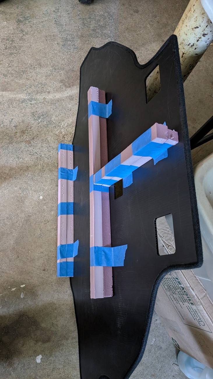

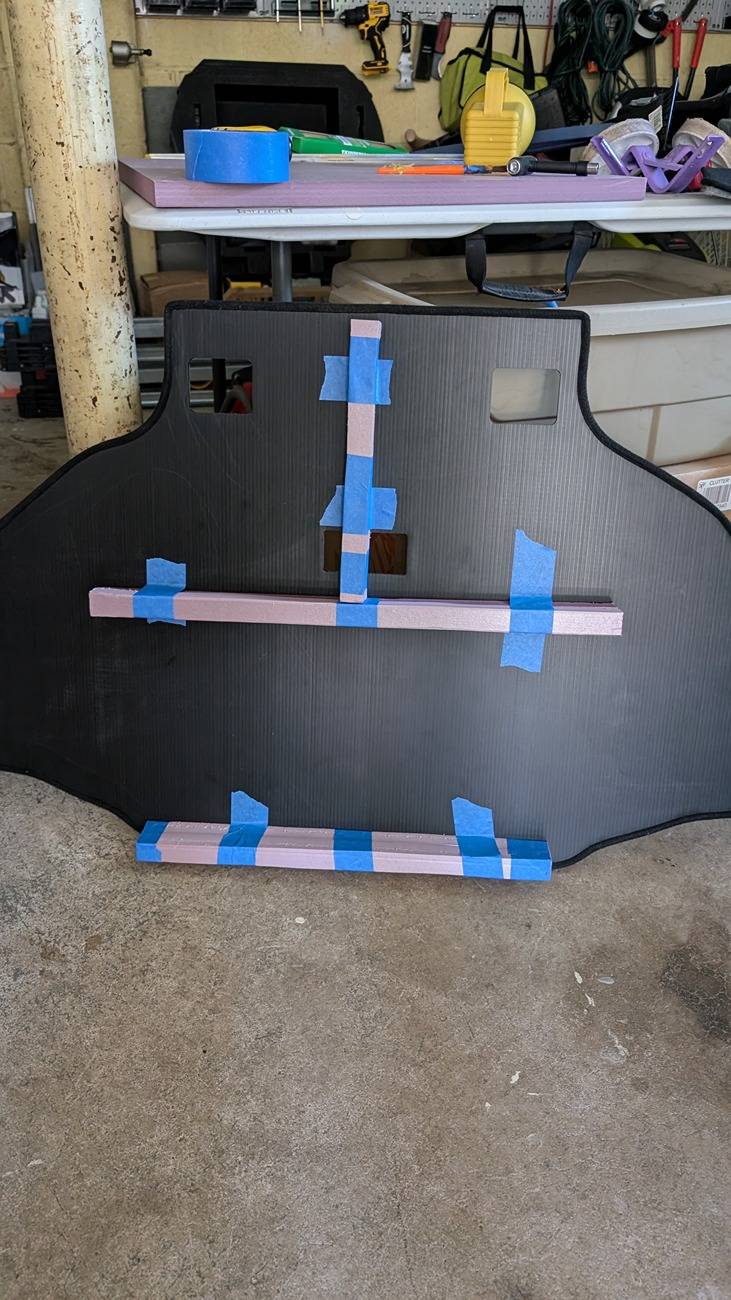

@Mr. Mac can you give me your opinion on this?
Similar to yours, I made this frame to mount onto the sub enclosure to protect the speakers and keep the trunk floor flush. However I am considering instead mounting 2" of foam to the underside of the trunk liner. My logic is that it would be cleaner because it lifts out with the trunk liner piece. However I am unsure of the acoustic ramifications and would love your opinion on it.
Mr. Mac
Mr. Mac
Mac
Mar 1, 2024
237
506
Z® NISMO®
Hi – Immediate concerns with this approach are...
1) Potential for unwanted noise (vibrating, rattles, buzzing, etc.) by using the solid, rigid factory plastic panel on directly overtop of subwoofers (which is also not acoustically transparent).
2) Potential reduction in strength/support for carrying any heavy cargo on top of carpeted cargo mat(s) due to using foam instead of solid wood frame.
3) Potential damage to factory plastic panel depending on how foam is attached if concerned at all about returning vehicle back perfectly to stock without trace of system ever being installed (although a replacement panel could probably be acquired if you go this route and this is an issue for you).
Not seeing how this approach would make finished install any cleaner if a solid frame around top of subs is already executed cleanly. That solid frame not only provides great protection for subs while directing all the subs' acoustical energy upward, it also provides great support for any heavy cargo as mentioned above, and also creates a nice border for amplifiers/processors to mount against.
Hope this helps. Lookin forward to seeing what ya come up with!

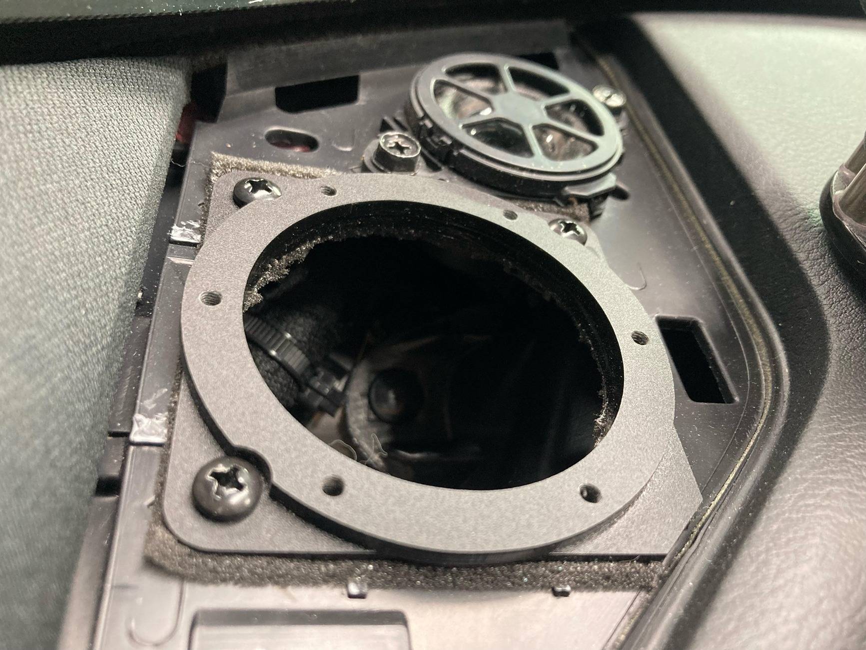

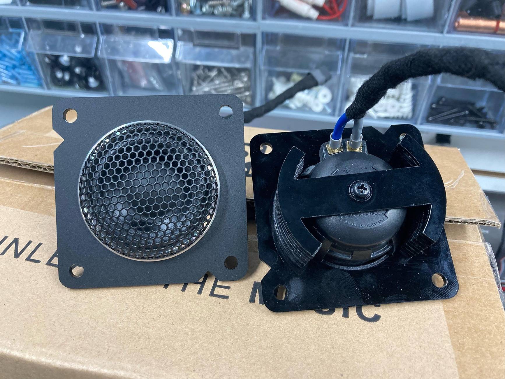

Very nice! Did performance turn out to what you were shooting for? I'm very curious about those BLAM MS2 drivers you chose for dash in a 2-way front stage setup. Can't seem to find them anywhere in the states. Did they come with the square-to-round mounting plate, or was that something purchased 3rd party (or did you by chance make them)? Anyway, hope you're enjoying. :)

The Blam's 2.0 sig. M/T speakers. They are very neutral due to the carbon fiber cone, 3d imaging is good. I like them but there probability a better 3 inch driver out there. Give soundworks audio in Pasadena Maryland a call.
