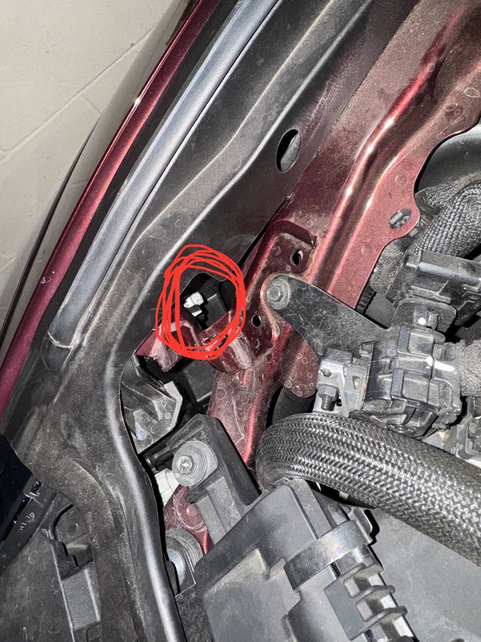

Mine were aimed down pretty badly. I was able to adjust them up very easily. The adjustment screw is accessible behind the front of the fender to hood seal, 10mm ratcheting wrench works best.
Hi. I'm trying to adjust mine too. I can't find where the screw is located. Can someone post more pictures to show its location to help me find it. Thanks ?

Not the easiest thing to adjust with big hands and kind of tucked under the body behind the headlights. On the other side its kind of behind where you fill the washer fluid - but accessible.
I used a soild wrench, could not get my ratchet-wrench to move enough. Can adjust a little at a time and a little is all it takes. Just dont drop your wrench or it may fall into oblivion. Keep a long magnet nearby :).

Thank you very much for the response! I'm going to adjust it after work this evening. I have big hands too so I should pick up a long wrench. Thanks for the heads up ?
You can also use a P2 phillips head screwdriver in the top section in the grooves
