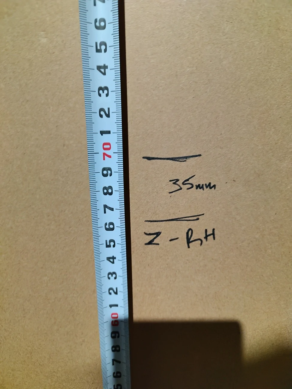

I don't have that much room to play with for the settings, so I just marked a board for each one, and went up an equal amount. If it's still too low, or too high I'll have that reference point to go off.
Nailed it first go apparently! Ha
For anyone's reference, this was my beam height at 1m away at the peak of the beam. Raised both sides 35mm from where it was set from factory.
I'd say I got it pretty much bang on where I would want it, maayybbee a teensy bit too high, but I'm happy where it is.
