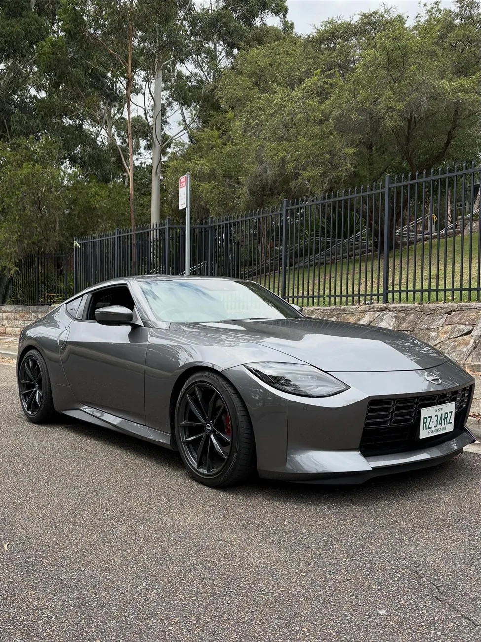

Hi pals, I'm new to the world of aftermarket wheels and tyres and hoping some of you knowledgeable folk can help confirm my research. Many thanks in advance!
My Z (I think it's called the Performance model in USA) has the stock wheels and tyres, which I believe are as follows:
Front: 19x9.5 +40 with 255/40 tyres
Rear: 19x10 +30 with 275/35 tyres
The stock tyres have a sidewall of 102mm front and 96.25mm rear.
I've lowered it with HKS coils and added the Z1 lowered spacers which I think are 25mm and give a pretty aggressive fitment - the photo is before alignment, there is less camber in the rear now.
I'm thinking of going with Work Emotion ZR10s
Front: 19x9.5 +23
Rear: 19x10.5 +15
This should give a bit less wheel poke, and more scope to go lower?
Then for rubber I was thinking of going pretty thicc with ps4s in
Front: 275/35
Rear: 305/30
I believe that's maxing out the rubber relative to the wheel width, but it should give sidewalls of 96.25mm front and 91.5mm which is the closest I could get to stock (2.1% speedo difference).
Am I on the right track here, or am I smoking crack? Any help is super appreciated.

Those sizes are better than stock
They will look ok
They are very far from whats possible.
For reference Volk recommends 19x9.5 +22, 19x10.5 +12 with 265 front and 305 rears for the Z34 a decade ago for stock fender fitment.
If you wanna play with aggressive sizing let me know and we can play
