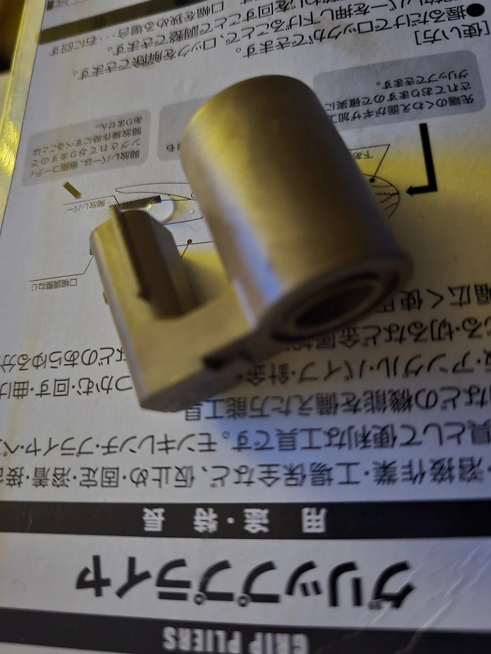

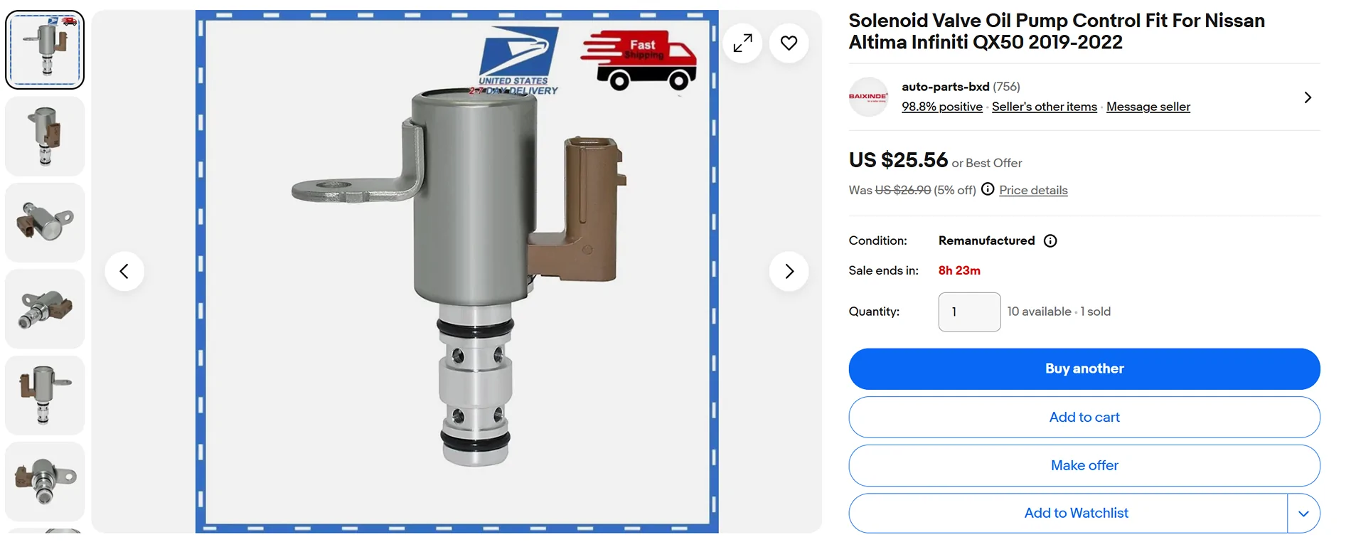

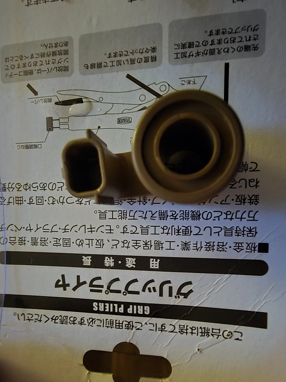

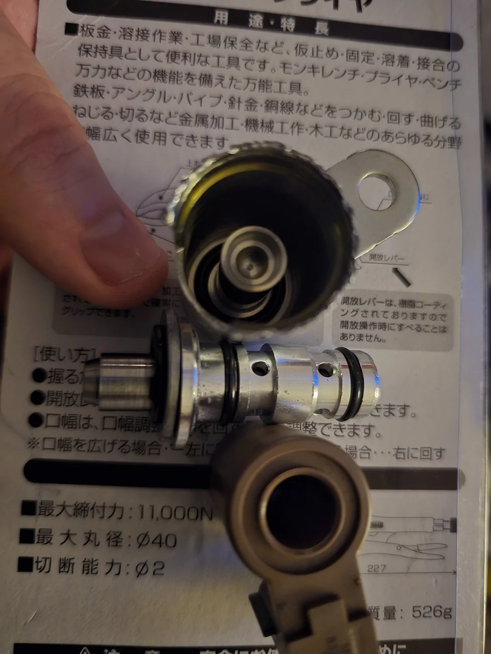

Just use a core from a cheap ebay solenoid. See my post on page 1, zero issues running it. You'd need a high wattage resistor otherwise, like 25+ watts.
