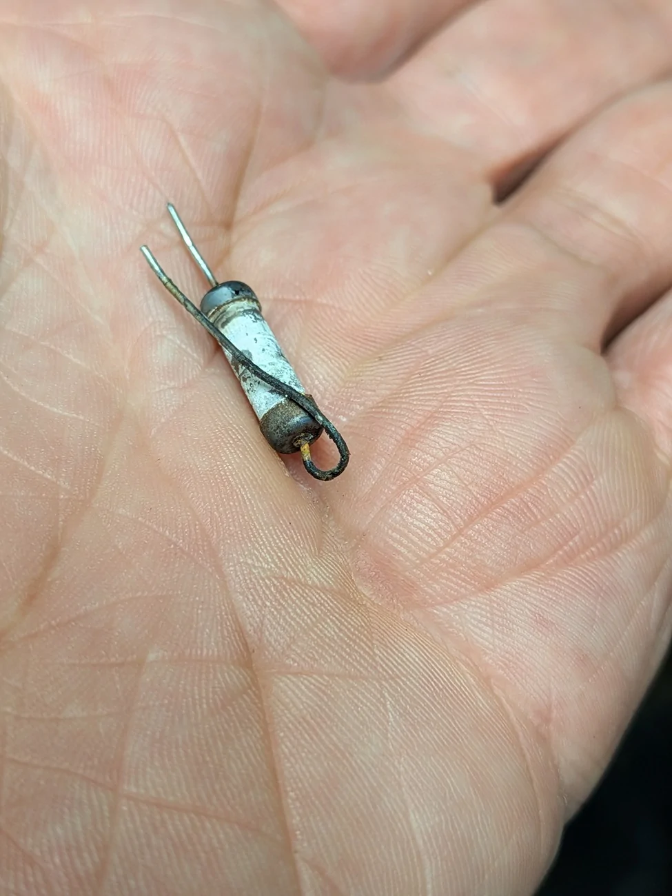

The solenoid had a resistance of 25 ohms out of the package.
How it started:
How it ended up after about 3 months:
I have NO IDEA how those 2 little wires to the solenoid can carry that much amperage to burn/heat up a fuse like that. I had it wrapped with plastic, and sealed with electrical tape and a zip tie, so it wasn't moisture. Resistance of that toasted little thing is now 433 OHMS.
Folks, do NOT be an idiot like me and stuff a resistor in the plug to keep the code from showing up. Get a real tune and have the solenoid error removed.
If you bought some aftermarket resistor. CHECK IT. I pull some shadetree mechanic shit, but this one could have really really hurt. I feel pretty stupid, and lucky that I checked it.

Honestly though, wouldn't the worst thing to happen with the resistor failing just be a CEL for the solenoid?
Very true. The connector got a little hot. The contact points were not damaged (It plugged right back in to the solenoid.) BUT, there's about 0.35" of slack in the wiring there, so repairing it would be a PITA.
