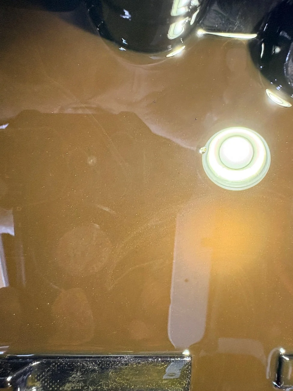

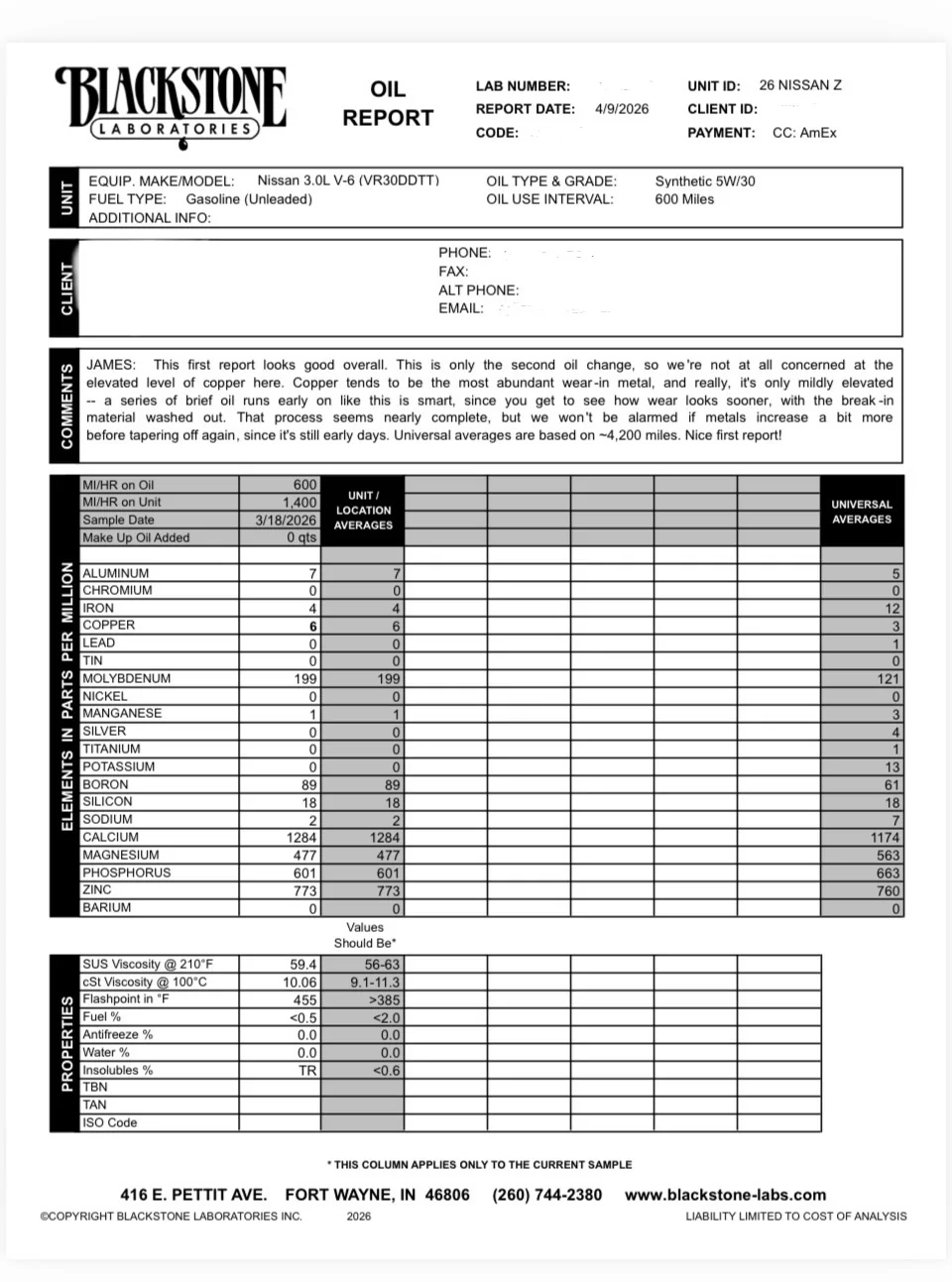

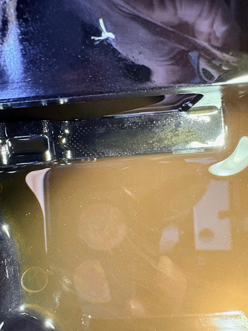

As promised the sample, and my oil looked like dark brown metallic paint, I had a few small chunks of metal the first change. I'll be doing another oil sample soon. I'm hitting 4000 miles so the next sample will have 2600 on it. Here's the importance of changing oil early on I think my first oil change was 400 miles. This is Quaker State 5w 30 I bought from Walmart, I was looking for cheap oil because I knew I'd be changing it early up until the first 10,000 miles. I'll probably do 4000/5000 mile intervals after that.

No water.
No lead.
Copper mildly elevated.
Moly elevated, but they didn't even mention it, so I assume that's 'normal' based on mileage.
That oil looks SO MUCH WORSE than this report says it is. Whew!!!

This is my first post but the picture looks worse than it is. This is exactly how my oil looked even after 2 oil changes and 3000 miles later, but got better with time and miles, there were brass and metal chunks at the bottom of my 1st oil change, Happens on all new engines, my new Kawasaki ZX10 looked the same way on the first few oil changes. I'll post my Black Stone report after I get it as well with the details. I wouldn't sweat it, it will subside by 8000mi as the automotive tech stated. It takes a while for new motors to fully break in, the piston rings will seat much quicker, everything else takes some time.
Honestly, I've never seen this in any new car I've ever owned or any other car, including engines I've built myself and broken in.
Glittery oil is a huge red flag for me that engine damage is occurring.

UOA looks for microscopic wear particles suspended in the oil, you don't need a UOA when the oil looks like glitter to tell there is severe bearing damage occurring.
Please read this: The UOA for this failed engine also has low "wear metals" and blackstone responds about why (largest they can detect is 5 microns and it won't catch "glittery oil" if caused by a sudden failure and not slow wear over time): What Can Used Oil Analysis Tell Us About a Failed Engine? | 900BRZ
I can't believe we're actually arguing on a car forum that glittery oils is "normal"...
Also, moly isn't a wear metal it's an anti-wear additive in the oil, but again, this isn't "wear" this is catastrophic failure.

Well I'll take a pic of my metallic brown oil, I'll continue changing it at regular intervals and overtime the metal will disappear. I'll continue to get oil samples and send it out to Blackstone and we'll see how long the motor last. I put about 20,000 miles a year on my car. It's just information it would be a fun experiment to track. I'm not arguing anything about oil, or metal on break in, or how much is normal. I'm just telling you what I see, and what I've seen in the past, if you think that's bad, look at a new Moto Guzzi, that thing pukes metal parts in its oil, and keeps on ticking like an old time X watch.
Do me a favor. Next time you change your oil or have it changed, take a flashlight and a screwdriver and stir it up. You'll see metallic in the oil unless you have over 8 to 10,000 miles which at that point the motor is pretty well broken in.

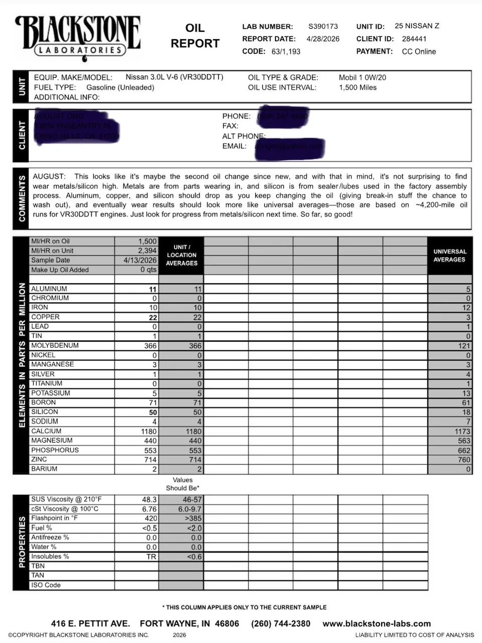

Here's my Blackstone report monitoring the VR30, as expected still breaking in gradually, metals still showing, second oil change at 2,394, first was at 980 miles. More upcoming oil changes soon, 1k intervals, until averages are met. Hotter summer weather coming up will move to 0W30.
'So far, so good!'
Certainly won't track it until averages are met!!

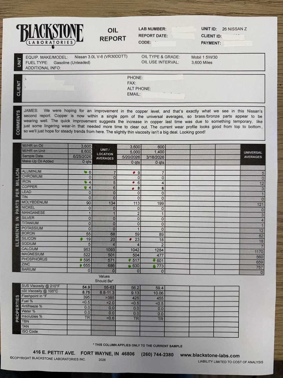

Just wanted to circle back, my oil doesn't show as much metallic gold particles. These motors take a while to break in here's my latest 8500 mile Blackstone analysis. The levels are good probably because of the early flushes/ frequent oil changes in the beginning.
