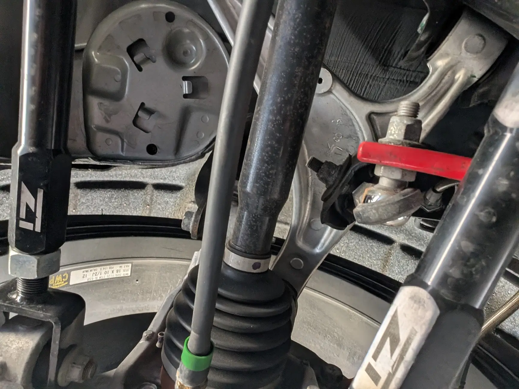

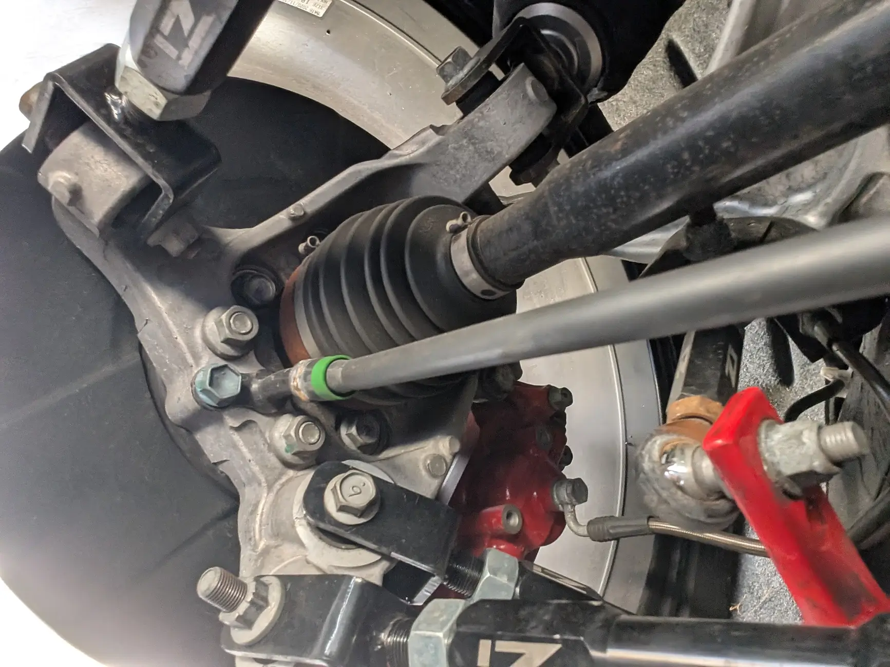

Turns out it was in fact the sway bar bushings and endlinks. The Z1 adjustable endlinks joints are not booted or so they're exposed to the elements and dry out and cause creak/squeak noises. I cleaned and relubricated the bar bushings and ball joints. I will be getting different endlinks that are booted.

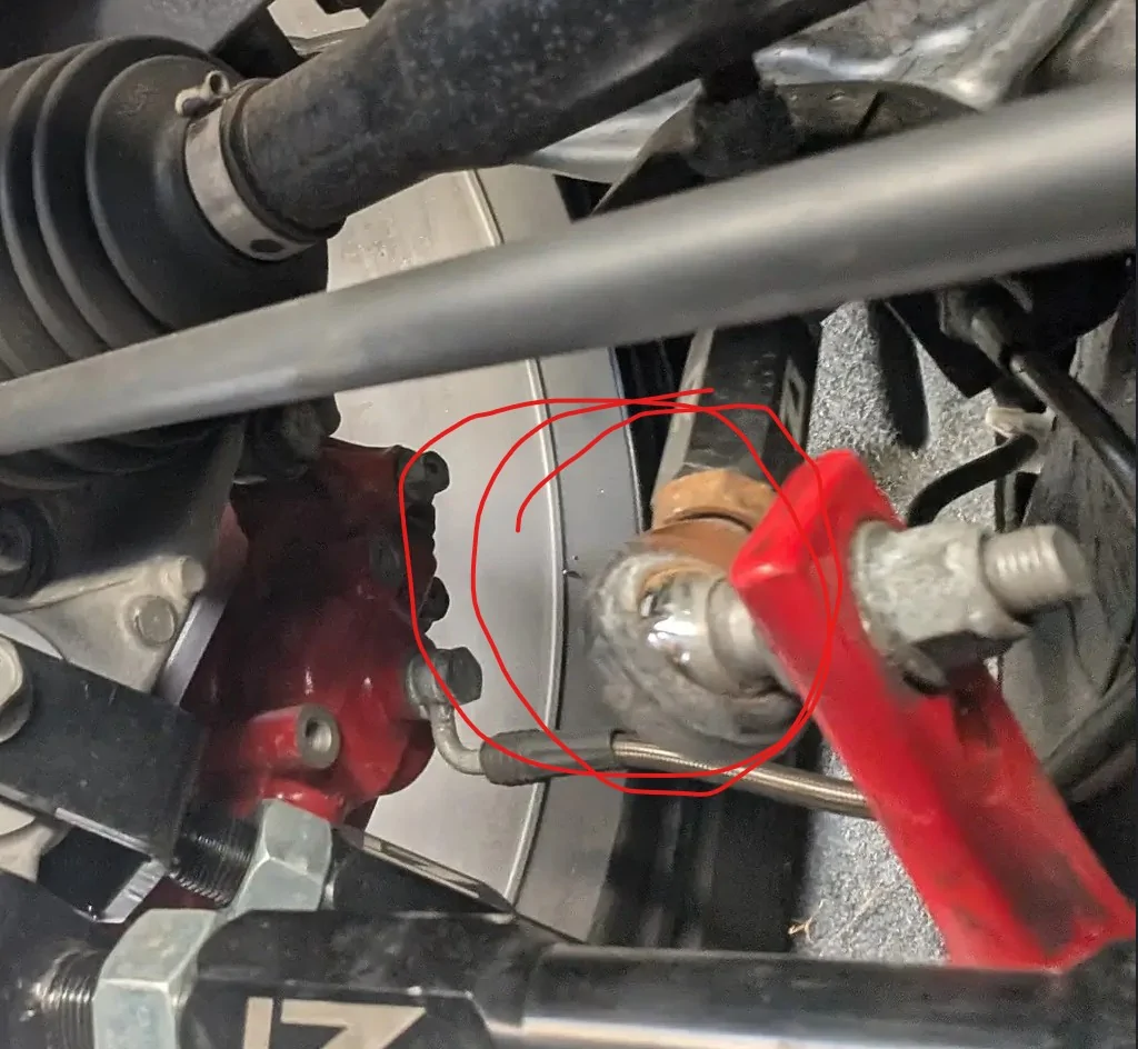

There should be some deflection but not nearly to that level
Z1 itself:

Well, it looks like it is chewed up pretty good. Might be the source of the noise? Do you have a way to check it out, OP?

It was in fact those ball/helm joints. I lubed them up and the noise for the most part went away. They were bone dry. Cleaned them with wd40 then greased them. Once in a while I'll hear the sway bar "click" when the weight of the car shifts a little while stationary. Z1 updated these end links to have boots now (go figure). I called them out and of course they deflected. "3rd party parts make noise" yeah then why did you boot the joints? Whatever. I'm gonna get SPL end links eventually, they're booted as well.
