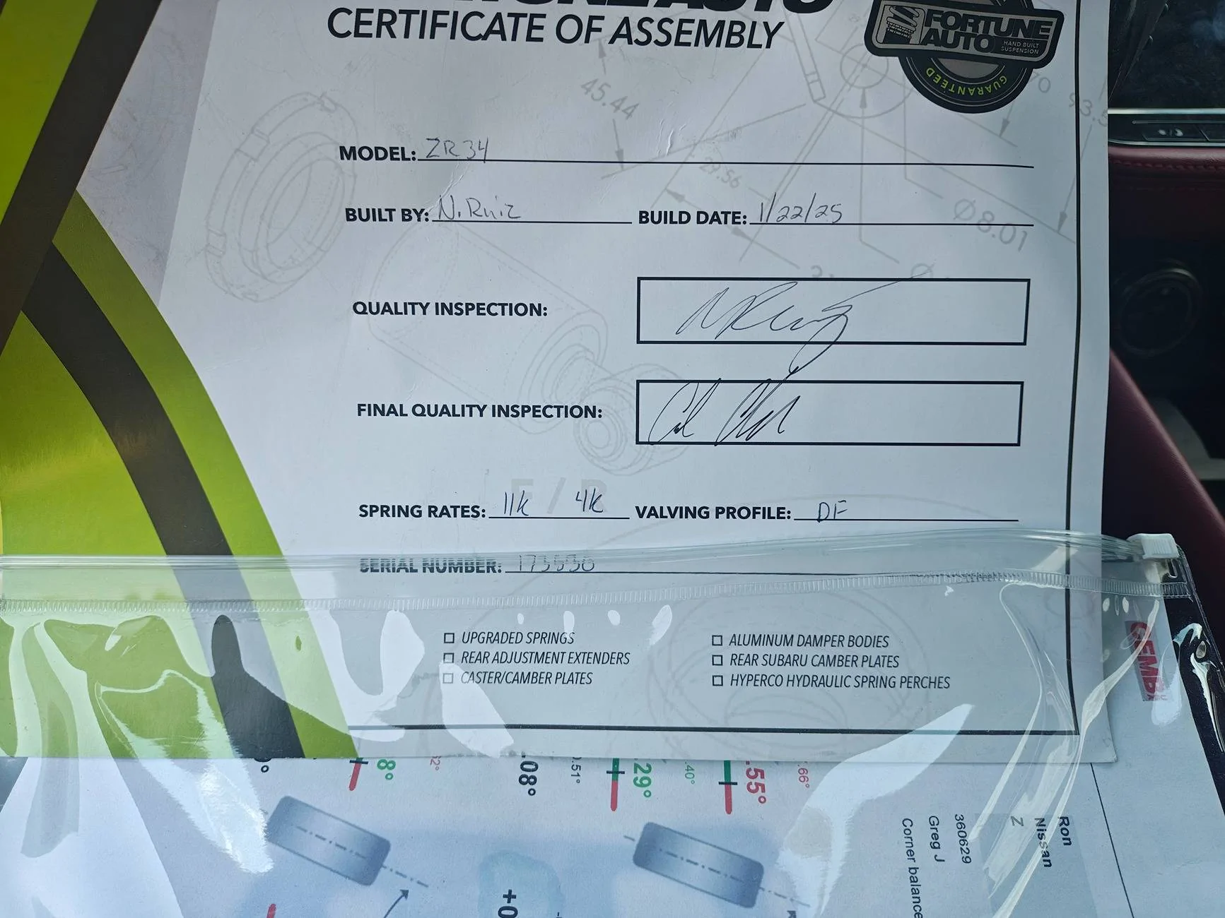

Fortune 500, 10 kg F & 9 kg R
I have a set of the fortune auto 500. For daily driving so far the spring rates are 11k and 4k... Very smooth not too stiff, even with a bunch of Z1 suspension arms
That was the Fortune Auto recommendation after I answered the online questionnaire. I also called them up and spoke with their Tech Representative.

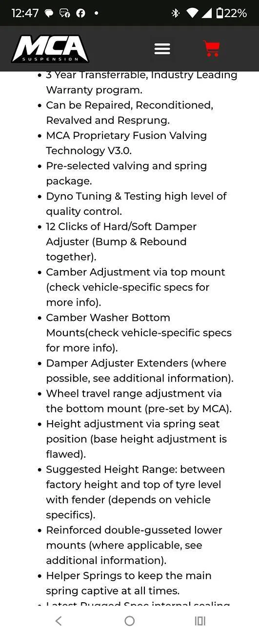

I had narrowed down my choice to these or Billstein's. MCA Pro Street Nissan 400Z Adjustable Suspension Kit
The specs look good. (18k sounds high vs Fortune Auto's piston tech with lower numbers. take that with a grain of salt) I've never heard of this company (since I'm American) if it's a brand you trust, keep it high on your list. Billstein's might be good too. I vaguely know of them. maybe im wrong but I don't think they get used much on our platform for daily driving....
kevinbonds
Apr 2, 2025
528
626
z34
MCA was started by Murray Coote who is a well known suspension expert globally. The last 10 years or so they have expanded to a broader market, they used to just do custom work. Very good quality, they also make a comfort series of coilovers which are a great street friendly product.
