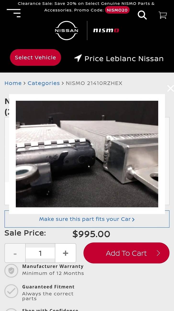

It seems that Nissan is coming out with competitive aftermarket** parts for the new Z. Does anyone have experience with the heat exchanger they have out?
All of the parts available through nismo seem rebranded?

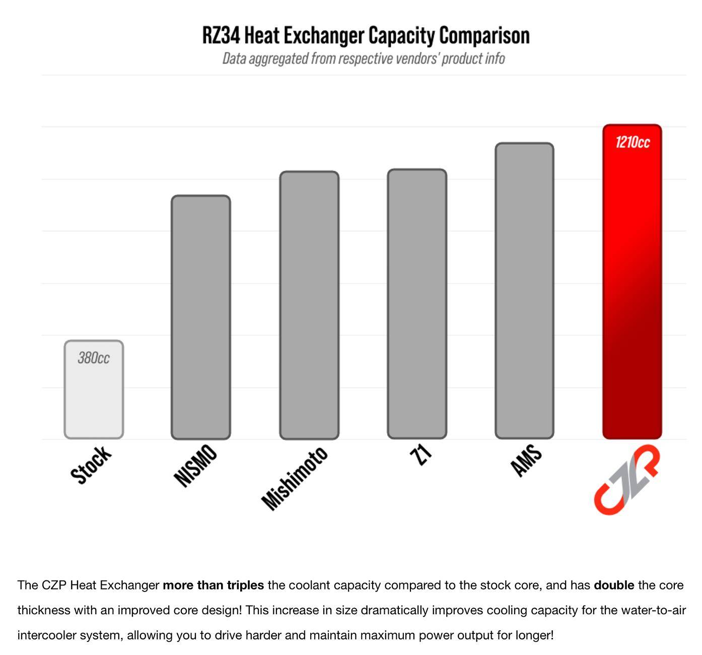

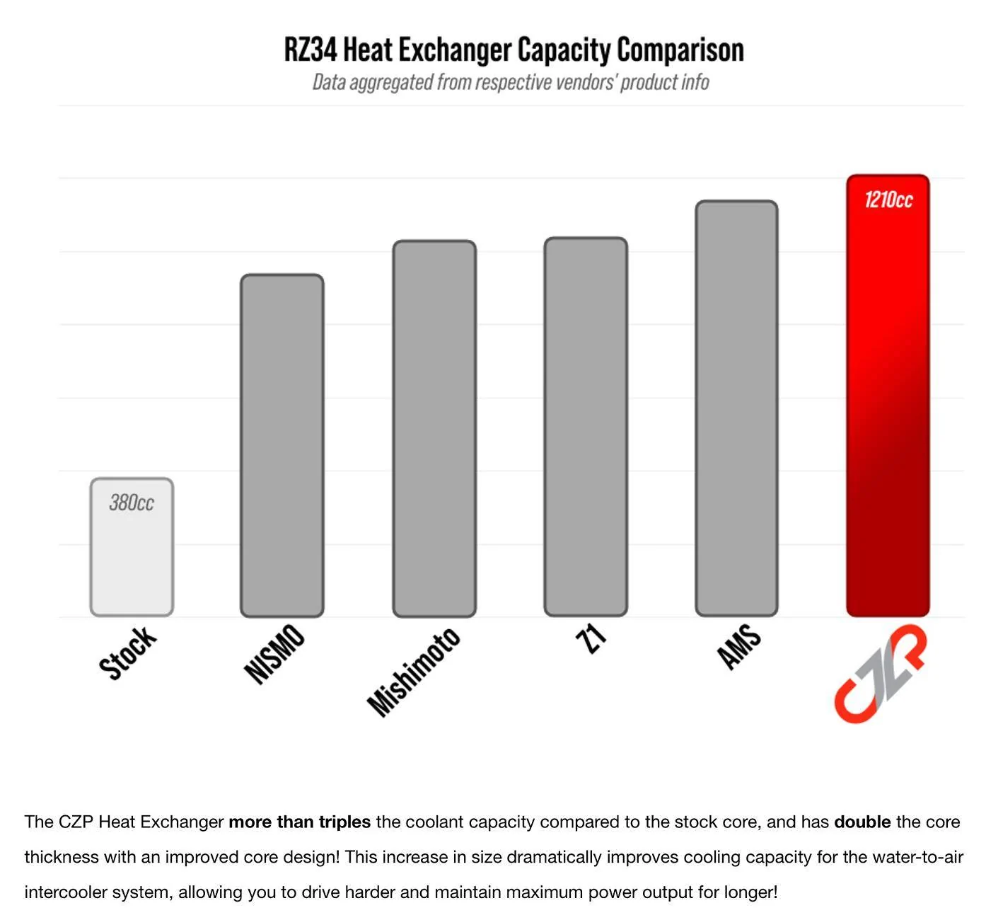

As I have no experience with these; quality, construction and structural integrity aside, the CZP appears to have the largest core, frontal surface area and coolant capacity, followed closely by AMS.
Chart below from CZP shows coolant capacity, which is important, bit I believe the core size/volume is the most important as that’s what’s doing the actual cooling. Descriptions specify ā€œvolumeā€ and I’m not sure if that means specifically the core.
My only beef with CZPā€˜s and Z1’s is they appear to be powder coated, and powder coating (and paint) affect thermal conductivity. Not sure how much exactly, but it does. And to powder coat the fins of a heat changer thats sole purpose is to transfer heat rubs me the wrong way. We do clear chromate conversion on our bare aluminum parts for corrosion resistance, its invisible, and the cost is comparable to powder coating. Our parts don’t see as much heat as these would, so not sure if that plays a part.

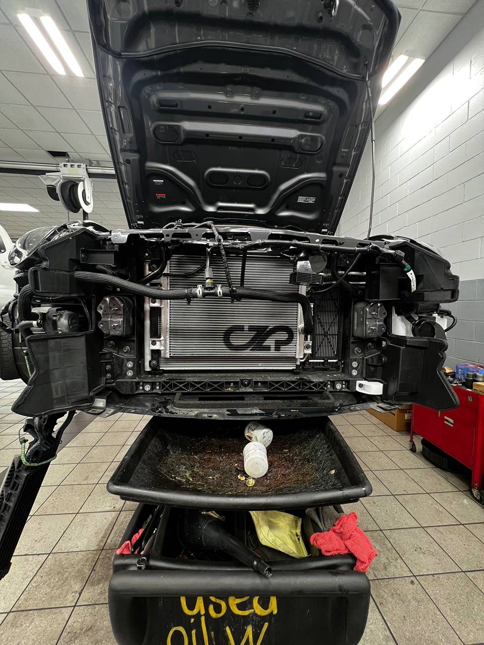

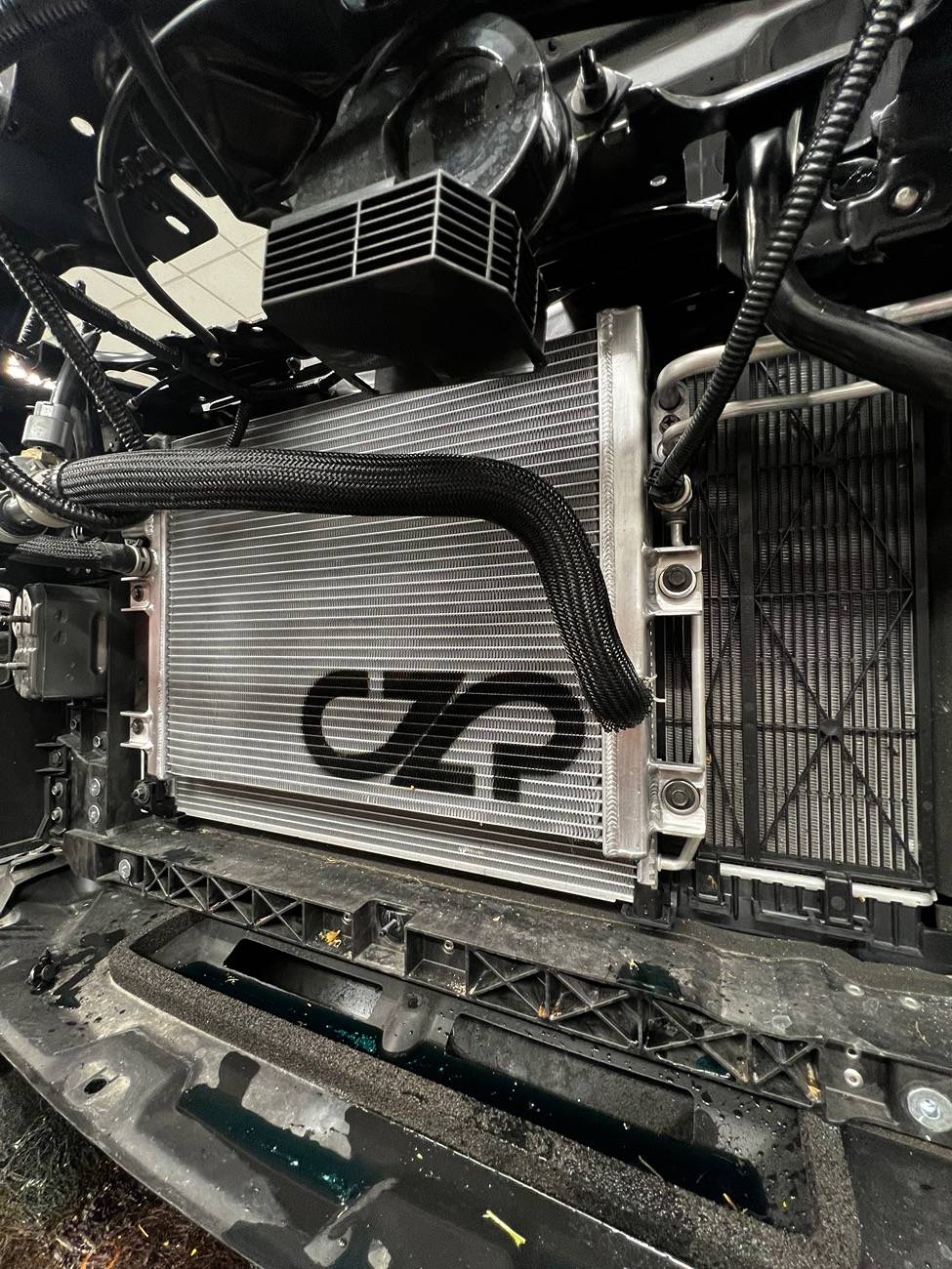

I installed the CZP heat exchanger last week, you can order it in the raw aluminum.
