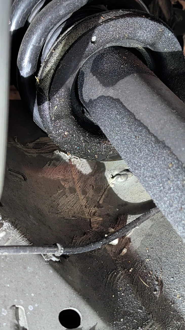

Got a better look at the leak today while waiting on parts. I think think all of fluid is gone as there is a bunch of fresh fluid pooled up now in different spots. Im surprised I can't feel it really driving around town.
1,776
2,063
Where on the car is this? I don't have a NISMO, but thinking I need to check more things at fluid check time.
163
3,127
5,879
The strut .The Tube inside the spring has hydraulic fluid inside the manage a smooth compression/rebound. Somehow a seal at the top of mine either had a leak from the factory ( could have pinched on the install) or it just failed

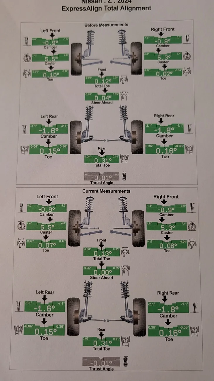

got the strut replaced and new alignment

The camber was weird as hell.
