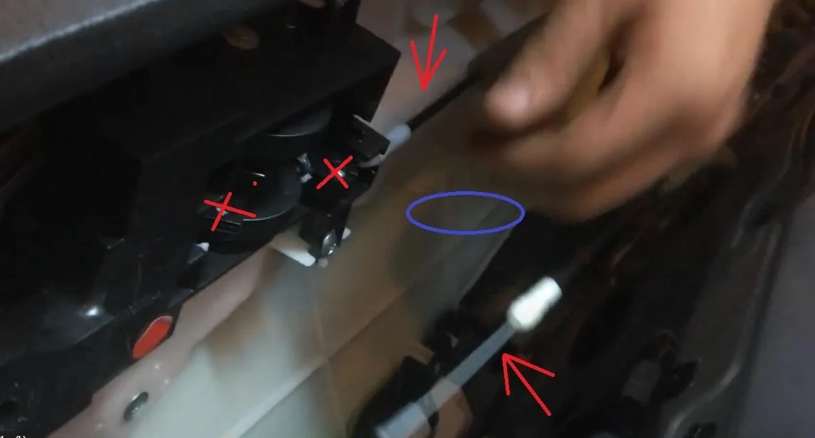

Took this pic as me and my buddy had to back the Z in to take the interior door panel off. Ever since I got my tint I had a light rattle and it turns out the Z now has this little plastic slit that the door cables run through and the tint place didn't run them back through. So good to know in case anyone has a door rattle...it could be something that simple

Did you get a pic of the cables themselves? Would like to show that when i get my tint done as a "look out for this"
I didnt it was really hot in the garage and we were just trying to get it done quickly and not scratch anything. im just glad it was something easy as it was annoying the hell out of me and it explains when I would pull the handle while driving it would go away as it was putting tension on the cables.
but here is the video I watched beforehand to take the panel off and I marked up for you where it would be
the cables (marked with the arrows) go where the X's are and the blue circle (its actually closer to where his hand is) is where on the Z there is a little piece of white plastic sticking out with a slit that the cables are run through to stop them from hitting the door when you go over a bump.

Perfect, thanks for posting the video/pic. Worse comes to worse I feel pretty good now about removing the panel to fix it myself!
yeah it was simple my buddy brought a little plastic tool to pop the bolt covers off and everything else just pulls off. when I dropped my car off for tint it didnt even cross my mind they were gonna pull the doors then a few days later I noticed the rattle and thats when it hit me they took the panels off
