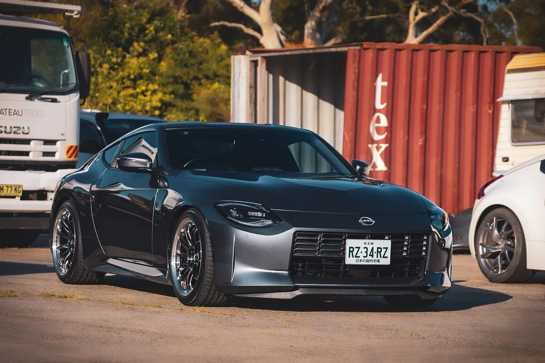

Yes I have the factory warranty on it. In the future if I go with a mild first stage tune do you feel I would benefit by a catch can? I was not going to change exhaust out or anything else except for K&N air filter. Really like the color of your car is that stock? It looks like a buffed out stainless look to it. Very nice.👍

Thanks! Yes, it's the stock gunmetallic colour. It gets an amazing liquid metal look in the right light.
