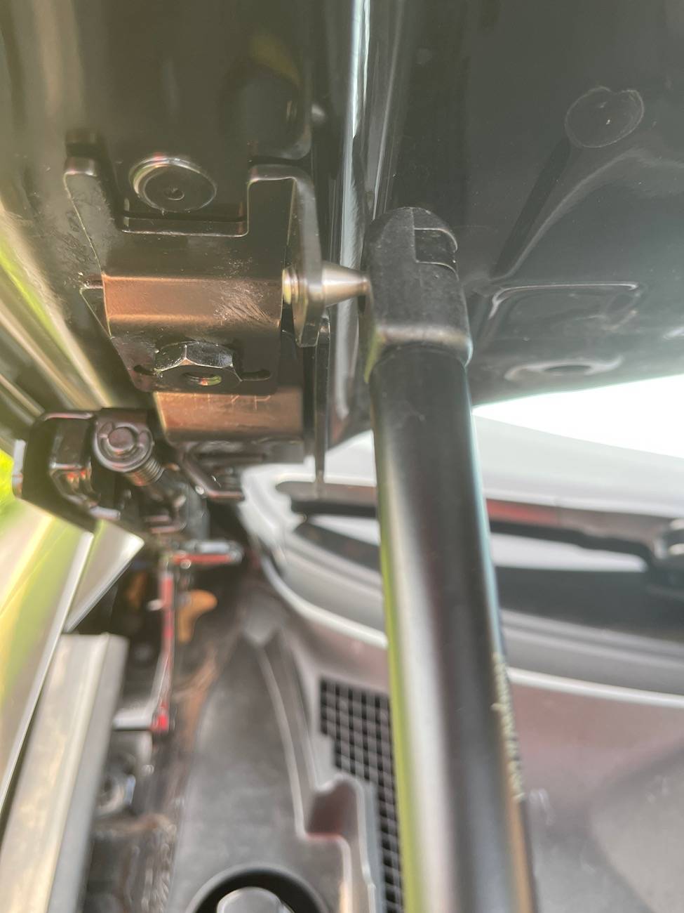

The brackets that came with the struts that attach to your hood are the ones I’m referring to. The end that holds the strut attachment is what bent almost immediately moreso on the driver side. The struts were very stiff on the first close but bracket went from a 90 degree angle to closer to 115 degrees. I was able to bend it back with a pair of pliers and a cloth but it was still somewhat unnerving.

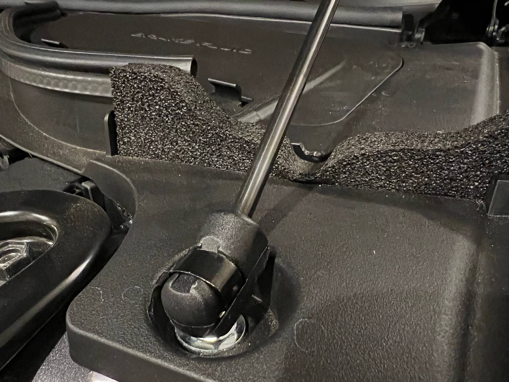

Here’s the latest pic I took just now. There’s still a subtle bend to it that I’m going to need to keep an eye on. Both sides are like this. It’s hard to see in the pic but you can tell the part of the bracket holding the ball joint is bent slightly upwards towards the hood. The video shows it more clearly.
I’ve contacted Kanjo to see if they have any feedback.

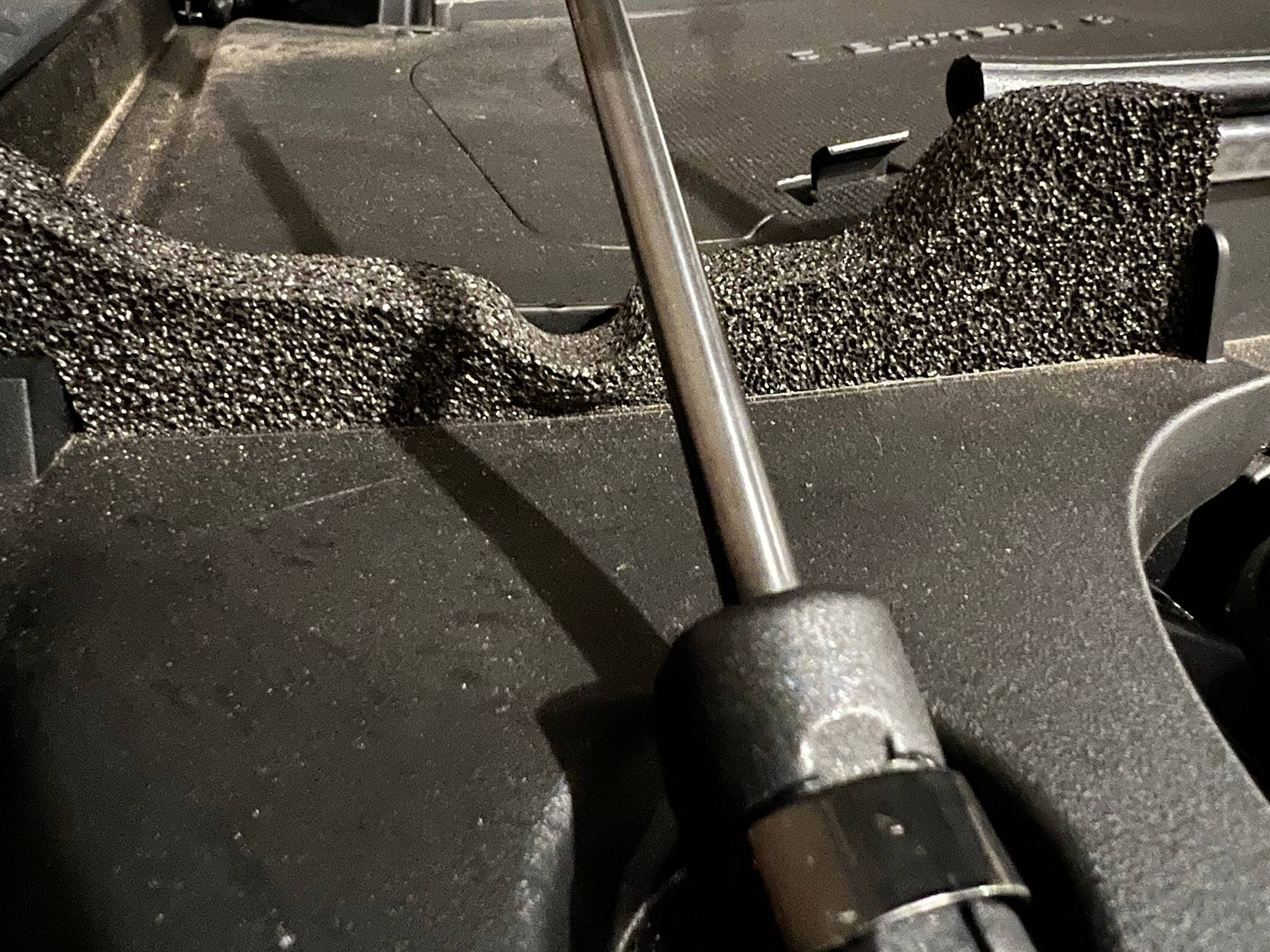

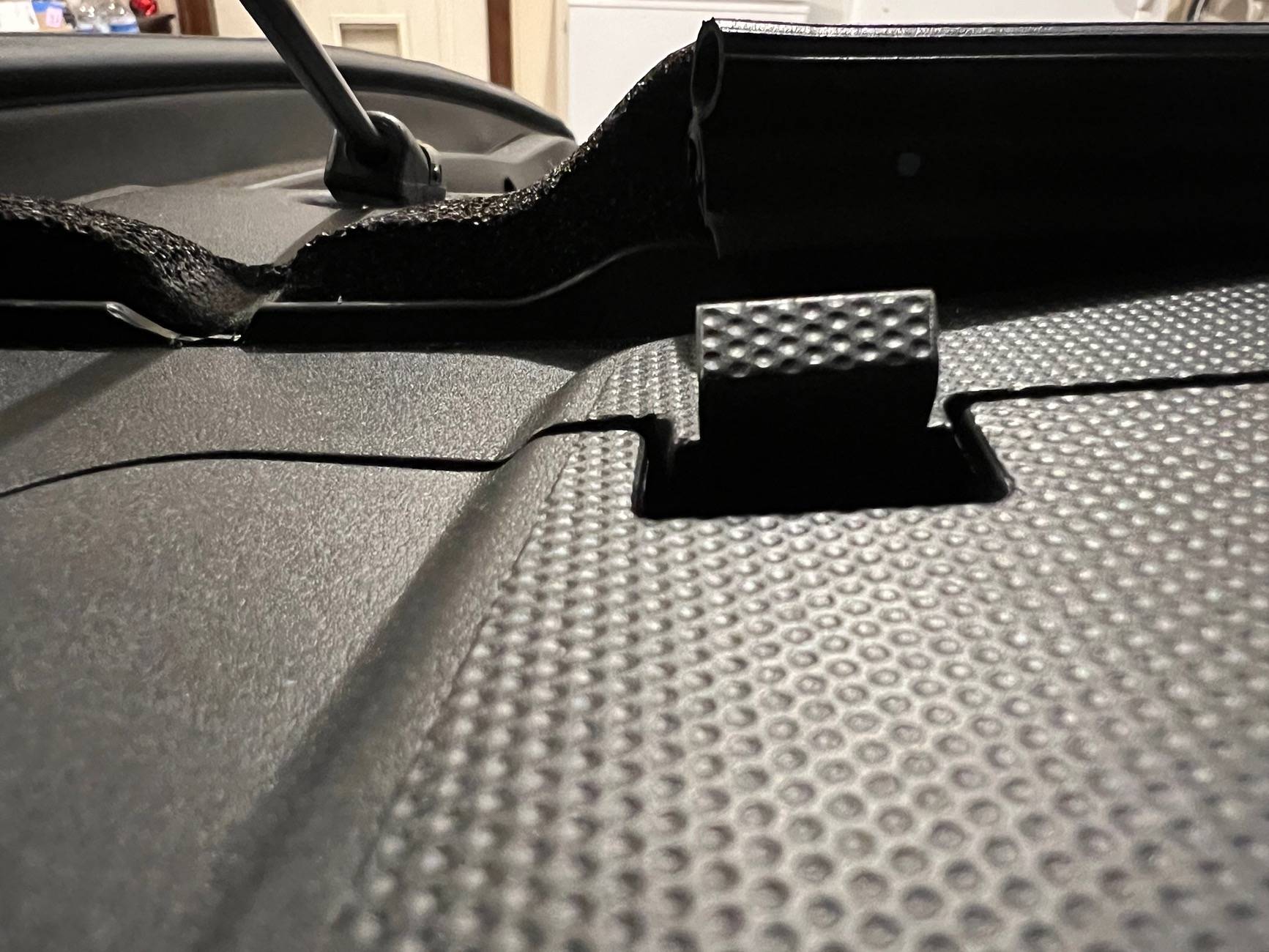

Here is where you MAY have to trim a little plastic. My passenger side required no trimming but the drivers side did. No biggie.

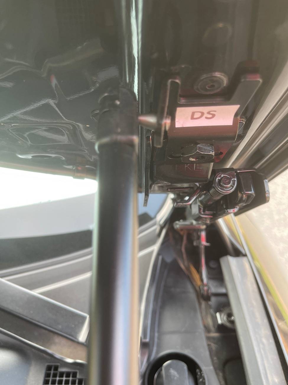

After reading your thread I went and checked mine, because I didn’t even think about it. Anyway just like yours the DS bracket is noticeably bent and the PS also looks less noticeably bent. The struts function without any issues, but I will reach out to Kanjo too.

Update I also reached out to Kanjo after also noticing my brackets were bent. I sent them pictures and they replied almost immediately. He stated they are working on updated brackets, but were willing to send me replacements immediately. I told them I would wait for the updated ones that should be out within the next month or so, unless the current ones bend out of spec more or stop functioning. Lastly they seem to really be customer focused businesses.
