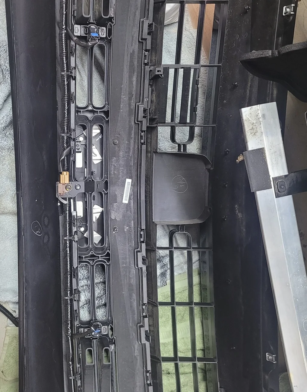

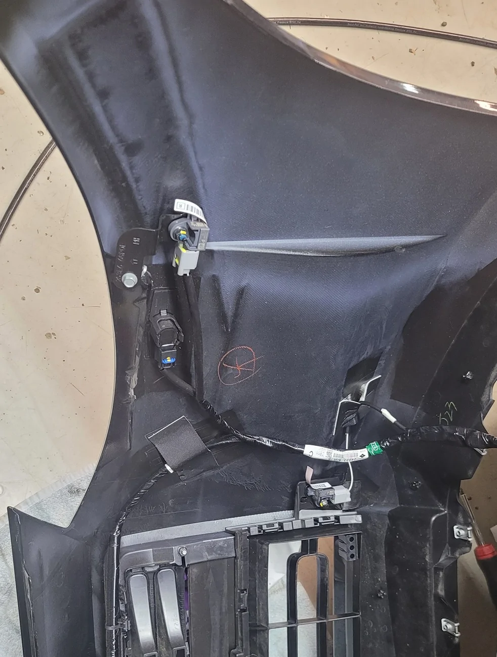

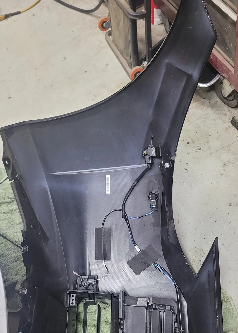

I finally received my sensors, and I pulled the bumper off to replace them only to find there are 5 sensors not just 3. Parts diagrams I found on Nissan site for ordering parts did not specify that there are 5. It just listed center, left and right. There are two each left and right. One upper and one lower on each side. This has turned into a very expensive nightmare for something that is completely unnecessary. If you look at attached images you can see them. Right side are grey, center is brown, and left side are black. The other sensors with blue wires are for parking sensors. It is no wonder cars are astronomically priced now. I just placed an order for two more sensors. That is now close to $1k in sensors for a worthless POS system. Including a picture of one sensor. It is just a small molded plastic piece.

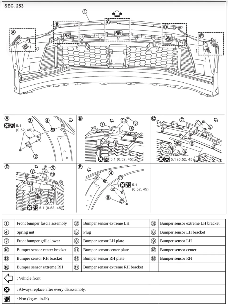

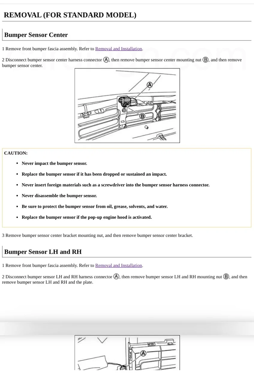

I don’t mean to contradict, and maybe it has changed… but there is no requirement to change every sensor.
Nissan mandates replacement if it has received impact or has been dropped. Additionally the bracket can not be damaged or bent. I can find no indication that these are ā€˜one time’ use items. It does say the bolts and nuts securing the sensor need to be replaced and torqued to spec every tine the bumper is removed, but I don’t think it’s an indication to replace every sensor prior to testing and clearing the ā€˜airbag system’ fault codes.
The repair information I have access to (i-Car Collision repair and Nissan Service Manuals) says to use Consult 3+ software to check DTC codes for the 5 sensors, and replace if they fail testing. You then check for the Airbag Control Module self tests and if that passes, no further action is needed. You *may* have to replace the Airbag Control Module if you can’t get it to pass self tests after hood poppers have deployed. BTW -You could have bought the correct ODBC cable and a license to use Consult 3 on a laptop (for a day or two) for less than the cost of all 5 sensors. If it was me, I probably would only replace the two sensors on the side that actually received the impact.
I would suspect (but do not actually know for sure) that a Nissan dealership would replace all 5 sensors, as it is a safety issue and part of the MRS (Multi-Restraint System) They wouldn’t want to be sued if the system failed to deploy after a repair…
There is s lot of BS about the poppers throwing a pedestrian over the car on other threads. What the system actually does is to let you have a sleek Z hood line. NTHSA and other worldwide safety boards don’t want the pedestrian’s skull to directly impact the engine block (or in our case probably the heat exchangers, strut bars, etc). The poppers provide a cushioning effect and provides space for the hood to deform as designed.
Seems like a particularly stupid design solution to me. On the 370Z there were just ā€˜hooks’ at the back of the aluminum hood that interlocked upon impact. Then the hood became the ā€˜crumple zone’ for a pedestrian or animal. There was more space between the engine & the hood though. But the solution used physics and not airbags & sensors. You have to replace the hood & bumper anyway if you hit something hard enough.
I attach a few images from the info I have access to…

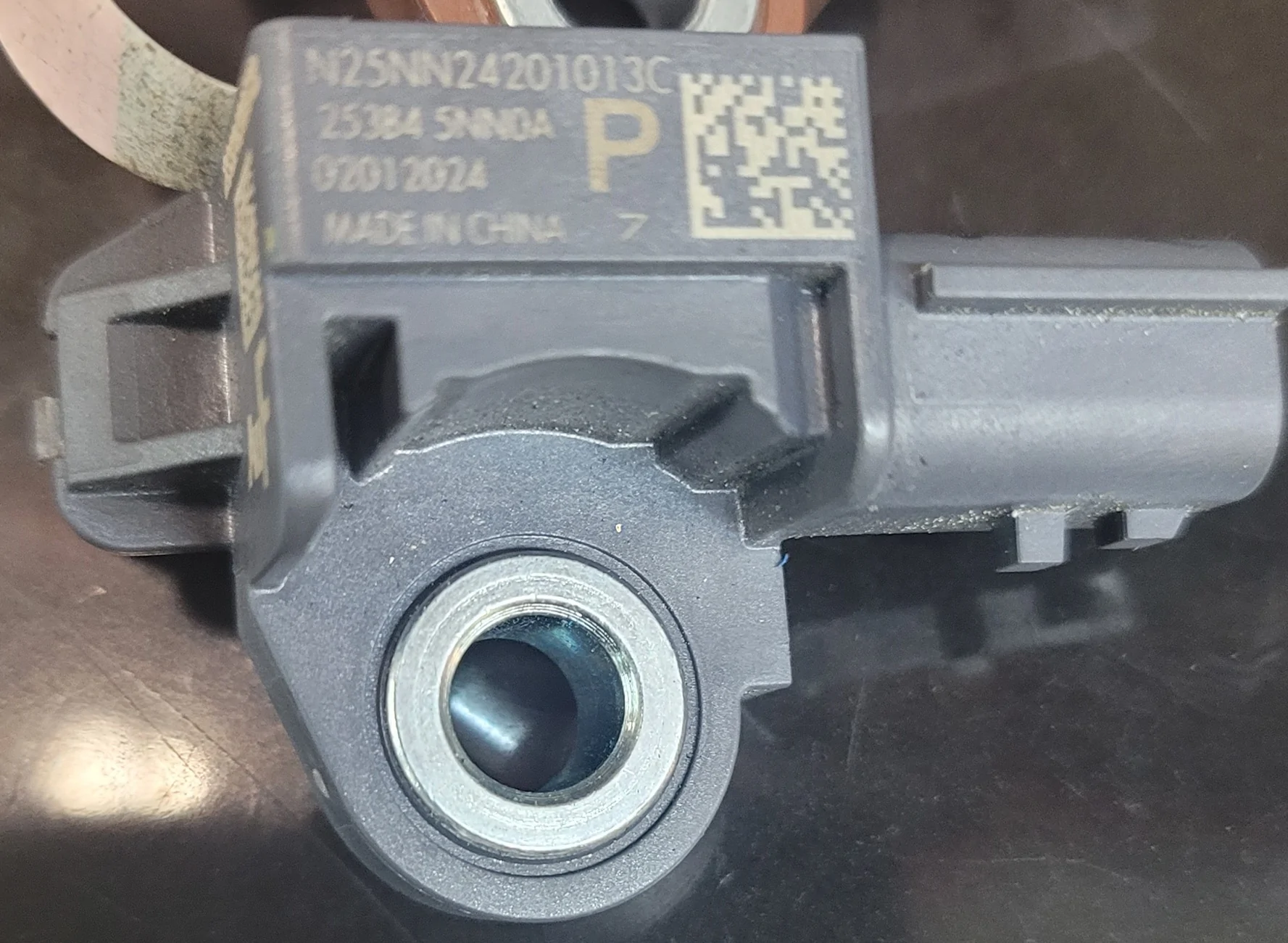

I’m so glad to hear you didn’t need to replace all the N25NN24201013C Pedestrian sensors. They’re ~$200 ea discounted. My info shows they shouldn’t need replacement & even if they were less sensitive but still passed self tests, wouldn’t that be a good thing? šŸ˜†
