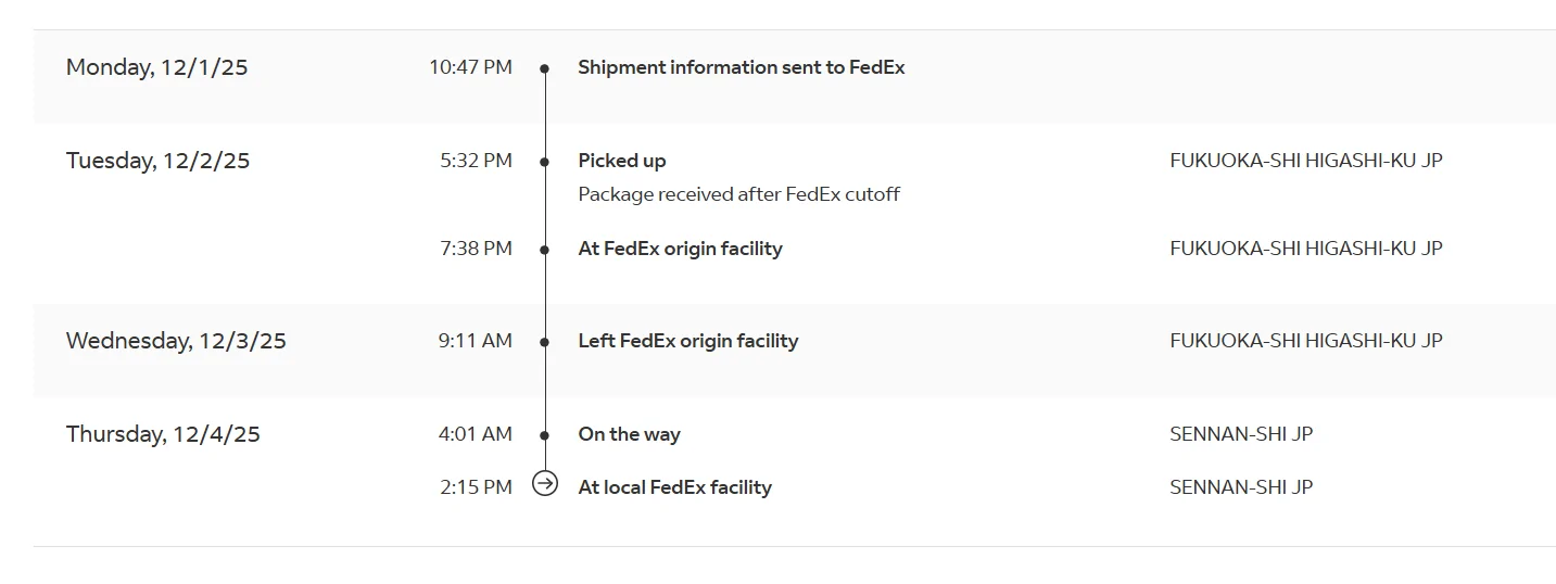

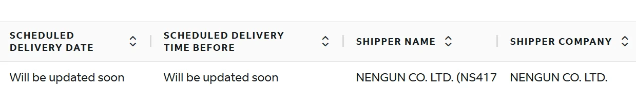

Not so fast for me ... idk wtf... and it won't let me pre-sign for the shipment on top of all the delays.

Uh, FedEx. Glad mine went UPS. Good luck I’m sure they will get it there eventually.

:cry: :poop::mad: I think this means they already lost it ... but still says delivering tomorrow. HIGHLY Doubt.
