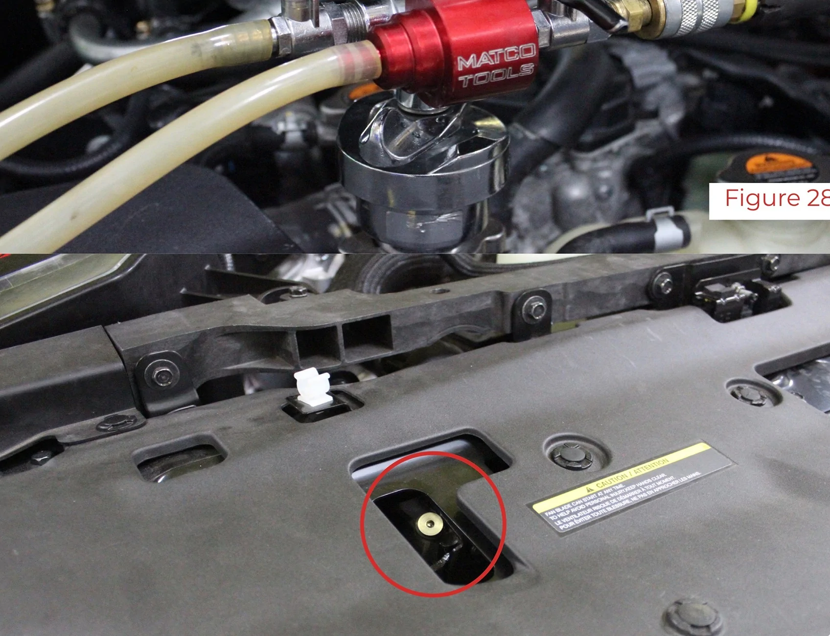

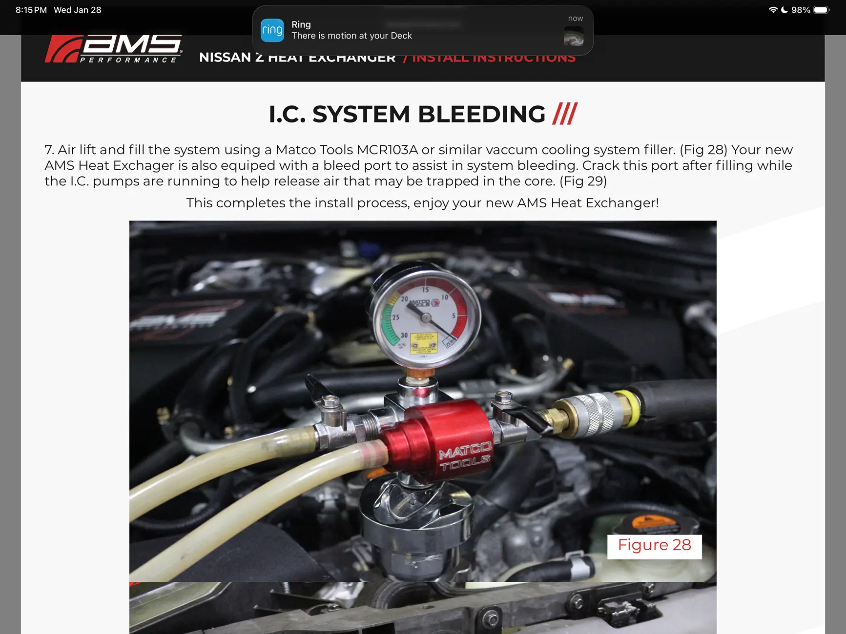

i would start with bleeding the new heat exchanger to remove any trapped air…

I have a 2024 z.
Had someone install an ams cold air intake, ams heat exhanger etc.
Car was running fine etc, then slowly felt like being dragged. Found out thay he dodnt put the undershroud back. Had a different shop reinstall the z1 aluminum shroud. Not sure if these guys did it right. Scrapping speed bumps, whistling during deceleration( intermittently) and doesn't pull hard anymore. Its been weeks I thought it might just be adjusting. Did an ecu reset and relearning. Something might have gotten dislodge during undershroud installation? Or something else

I couldn't find a shop that wants ti do it. The shop i went to just bled it but didn't smoke test anything or re torque anything. I have another shop lined up but won't be able to take me till they have an opening
