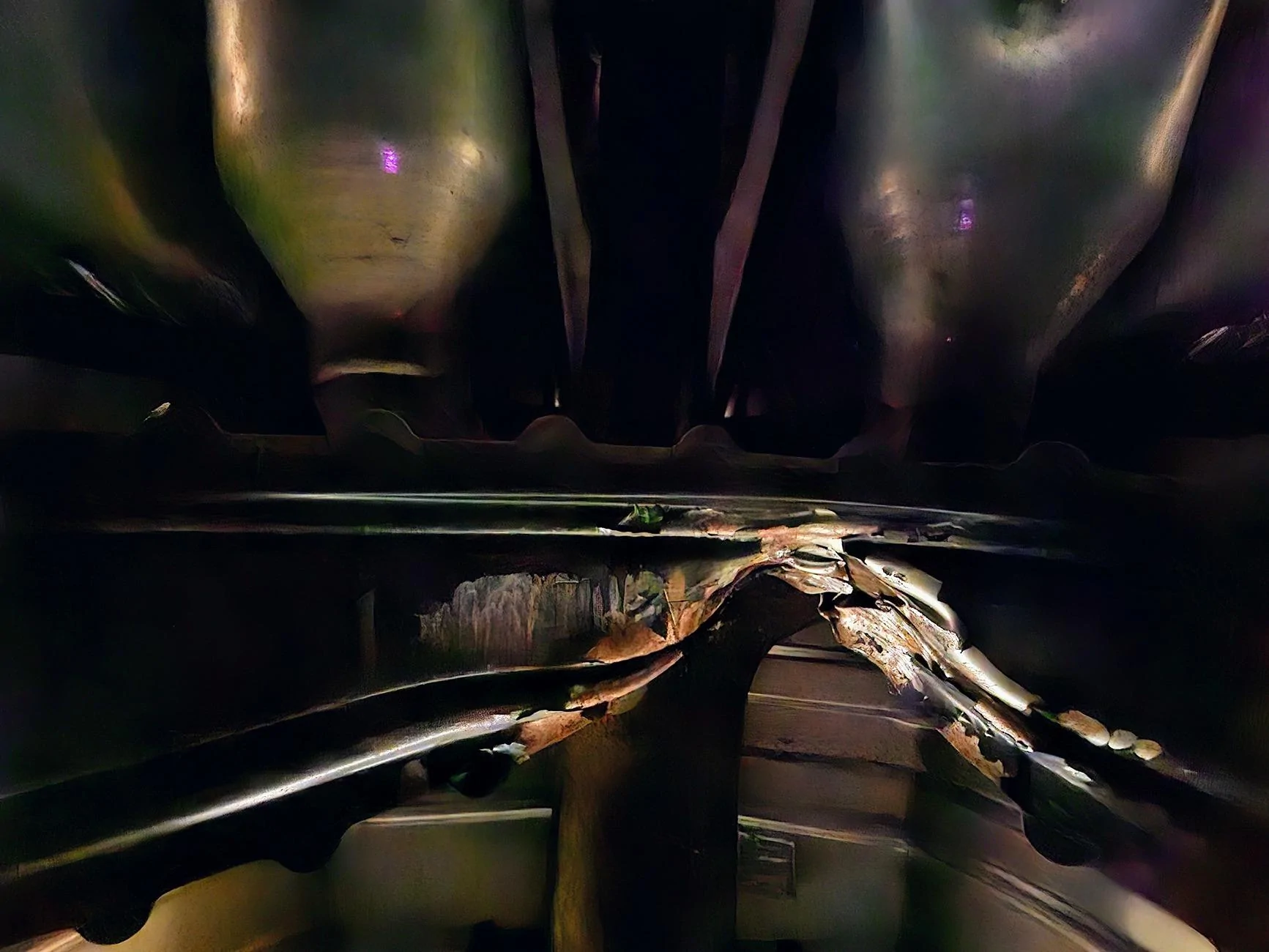

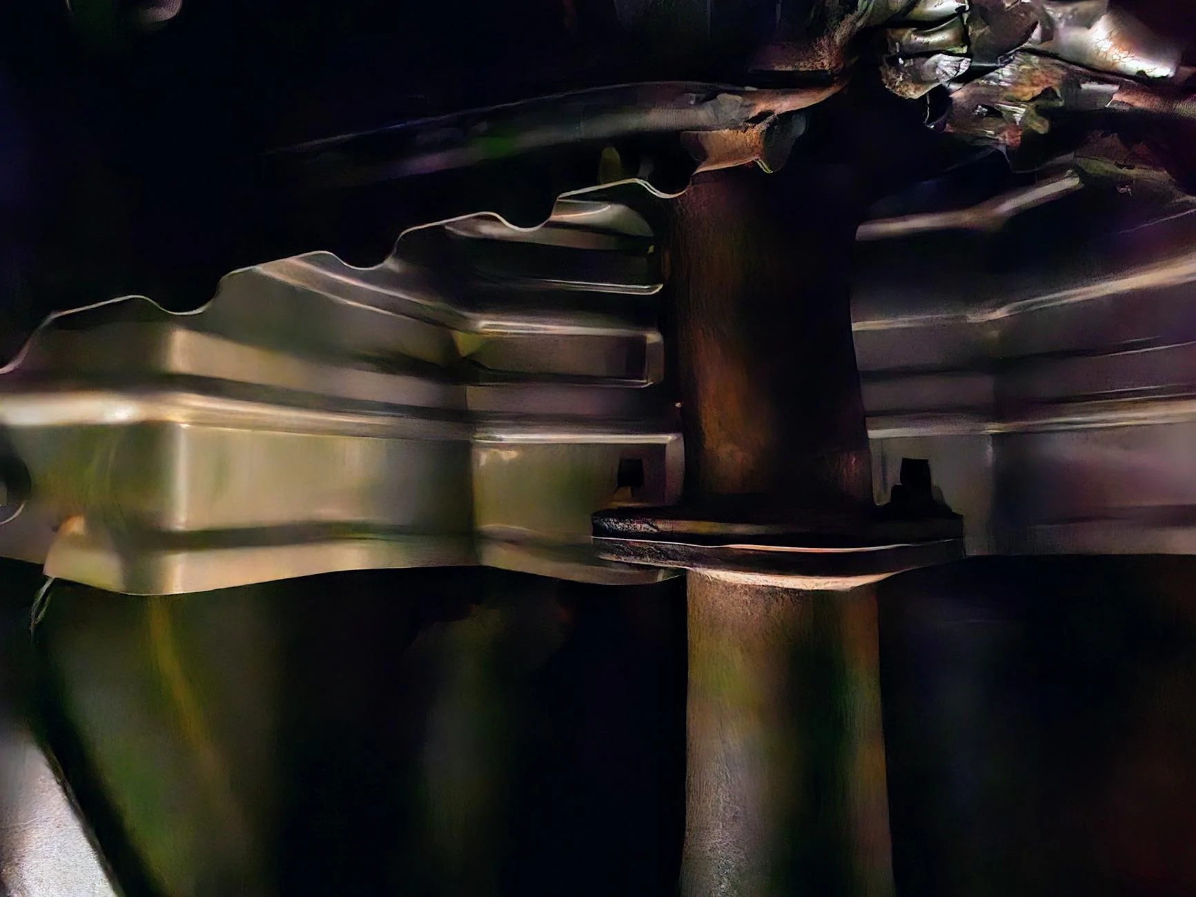

Well it happened. I was driving on the freeway, when I saw this... thing sitting in the middle of the lane. it looked like a metallic square with a short rod sticking out of it, kinda like a joystick. At "freeway speeds" with cars around me, I wasn't really able to to move around the object in the 2 secs between seeing it and being on top of it. So, the only thing to do was to stradle it down the middle.
With a single hit, I knew there was damage. I did a small check to see it anything was destroyed by wiggling the car. When I was satisfied, I left the freeway and pulled over. I looked underneath, and to my horror, a piece of meddle was definitely bent. Not dragging thankfully, but damaged.

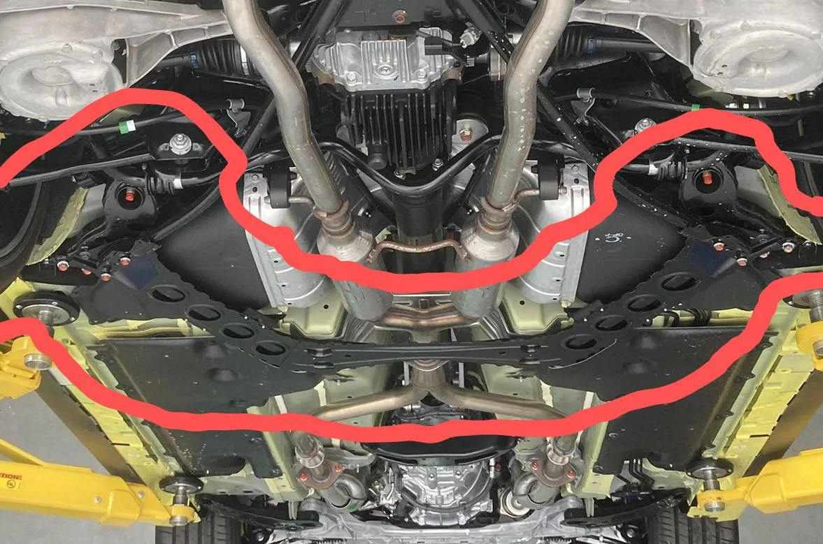

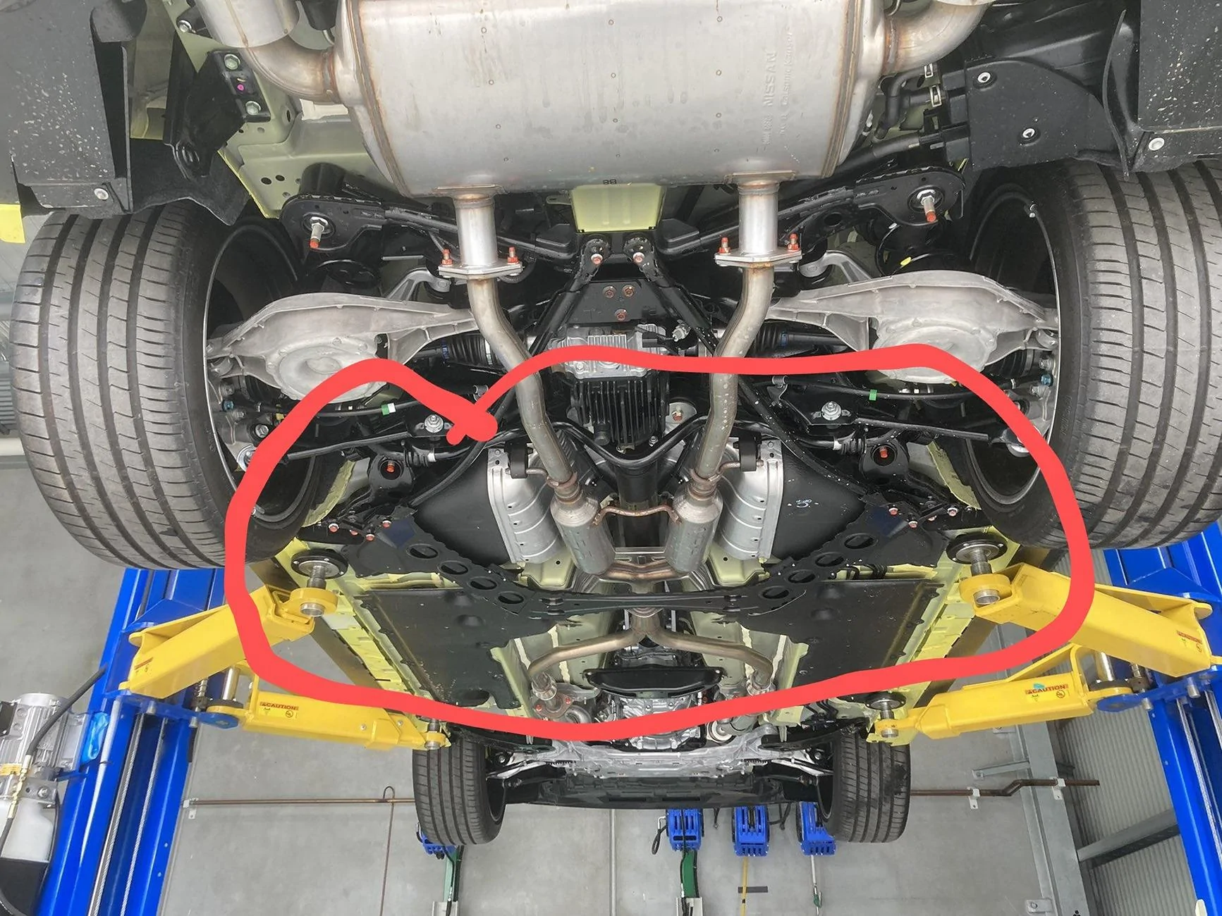

I have included a picture of the damage, along with an example picture of the part that's damaged.
Does anyone know what this part is and what it does? Also, is it replaceable and do we think it would be covered under warranty? Thoughts?

Sorry to hear that, the part that's damaged appears to be the W-brace, which provides support and rigidity to the underside of the car. As others have mentioned replacing through insurance should be possible but you'll have to pay your deductible and they may count it against you.

This is super easy to replace, only a few bolts. Despite its size its very light, should be a 30min job on jack strands. I wouldn't waste an insurance claim on it.
