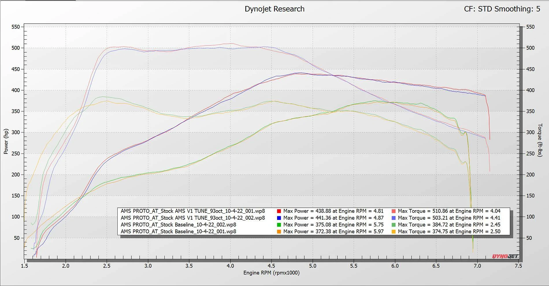

Here is the attached picture of the dynograph from the bone stock tune only Z. The dynograph was sent to me by AMS Performance but I don't know how to read the dynograph.
If my understanding is correct, the bone stock Z gained 38 horsepower by using the ECUTEK. So now the Z with stock 400 horsepower + 38 horsepower = 438 horsepower
The total of 438 horsepower seems more realistic from AMS Performance than the other place AAM Competition which they claimed you gain 100 horsepower.

It's a gain of 66hp. The dyno measures the power at the wheels which in this case is 375hp without the tune. The tune added 66hp. The 400hp Nissan quote is power output at the engine. There is some loss of power between the engine and the wheels which is why the baseline reading is lower than what Nissan quote.
