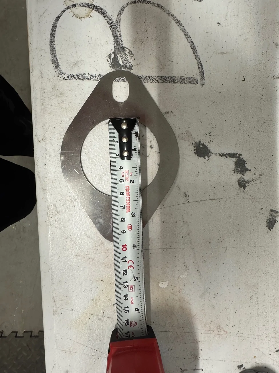

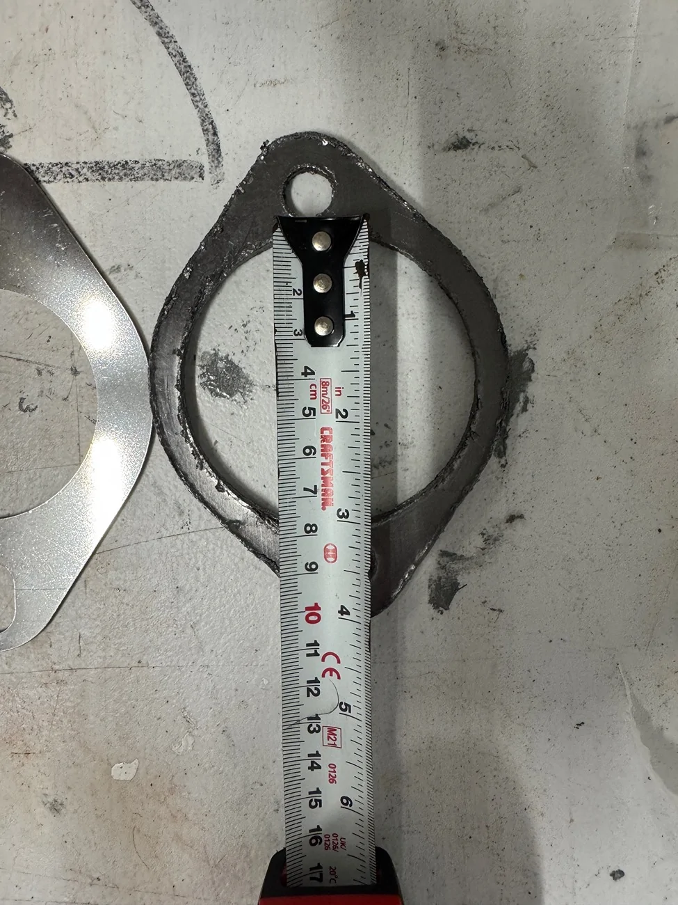

One more question on the install. Both the AWE track exhaust and the boosted six lower down pipes came with a reducing adapter. Looks to me as if the inner diameter of this adapter is 2 1/2 inches. Whereas the inner diameter of the exhaust and the lower downpipe is 3 inches. Is this adapter necessary for this situation?
I could see it’d be necessary if you were attaching the exhaust to an OEM lower downpipe orto OEM exhaust.
I’m in correspondence with AWE currently and they’re telling me to use this adapter.
Now to me it looks as if this would create restriction.
Please see the photos below.

That adapter is for mating aftermarket to stock piping. Do not use it.
That’s what I thought. Awaiting clarification from AWE, I’ll post their reply. But I’m with you, not for a 3” LDP to 3” exhaust setup.

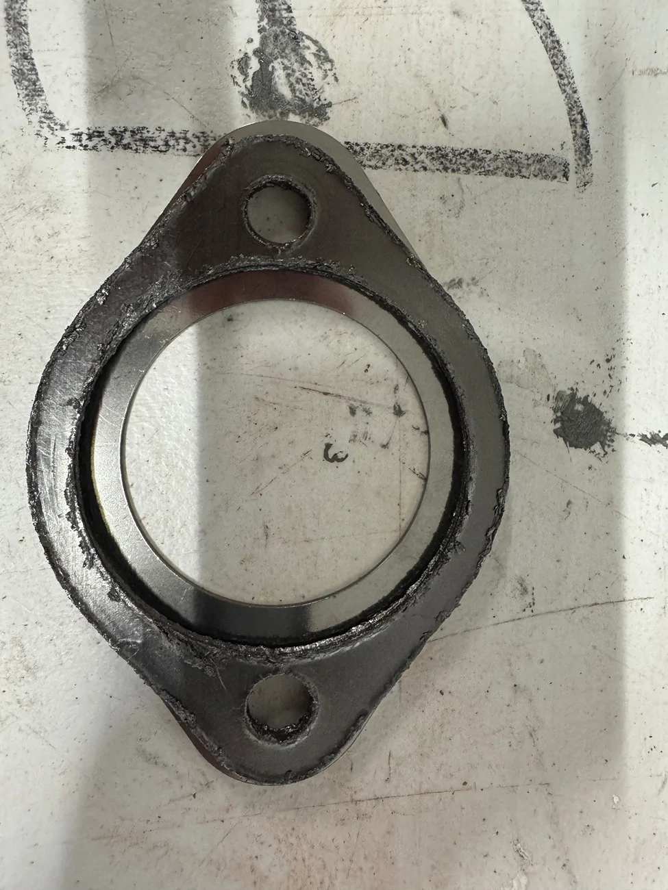

Update:
Read reply below, anyone have any leaks not using the adapter?

You wont have a leak, send it, no adapter needing, stop overthinking it.
100% correct.
OP - Use whichever gasket you prefer, the one provided by B6A or the thicker one provided by AWE. I'm personally using B6A's with the metal crush fire ring.
