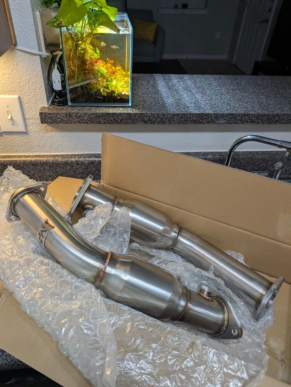

When I was still at the shop, the techs showed me the mounting brackets were way off and would require custom fabrication to even fit. I called Spool while I was there. The person I spoke with checked around and said it “happens sometimes” and not to worry about it — that the brackets aren’t needed. I accepted that at the moment because I knew it wasn’t something that could be resolved over the phone.
When I got home, I sent an email and pictures- After I sent photos, they told me to ship the downpipes back so they could “evaluate” them, and if they determine is replacement was warranted.
The problem is that I already paid a shop to install them. I’m not going to pay again to remove them, reinstall my factory cats, ship the parts back, wait for replacements, and then pay for a third install. That doesn’t make sense.
I asked them instead to send me a properly fitting replacement set now. I offered to install them, return the defective ones, and even put a credit card on file so they can charge me if the originals aren’t returned within the agreed timeframe.
Just to be clear — I’m not bashing Spool. I’m still waiting to see how they handle this. But it is frustrating to learn this is a common issue, and given that, I would expect them to go above and beyond to make it right. After posting about it on Facebook, at least four other people told me they’re dealing with the exact same problem. My assumption is that this was a bad production run overseas, and the long backorders are likely because they’re waiting for new stock.

They do not bolt up using the tab. I uninstalled the lowers and about 90% of the uppers when I caved and took it to Racebox.
I noticed they didn't bolt up when I got home and reviewed the work. I had the OEM brackets and bolts labeled and together to make the reinstall easier.
I saw the brackets were not on and decided to finish up what I thought was a lazy job. However they did not match up.
Not ideal, but the down pipes (all one piece) were very solidly in place. I plan on installing a two hole metal tab (used in welding) to secure it further.

It seems to me, that Spool is welding on the brackets, knowing they do not fit, then just shipping them, hoping nobody complains. The more I see, it seems the misalignment of the mounting brackets is very common. They should not be welding on the brackets if they wont bolt up correctly, but as long as they include them, they should bolt up.
