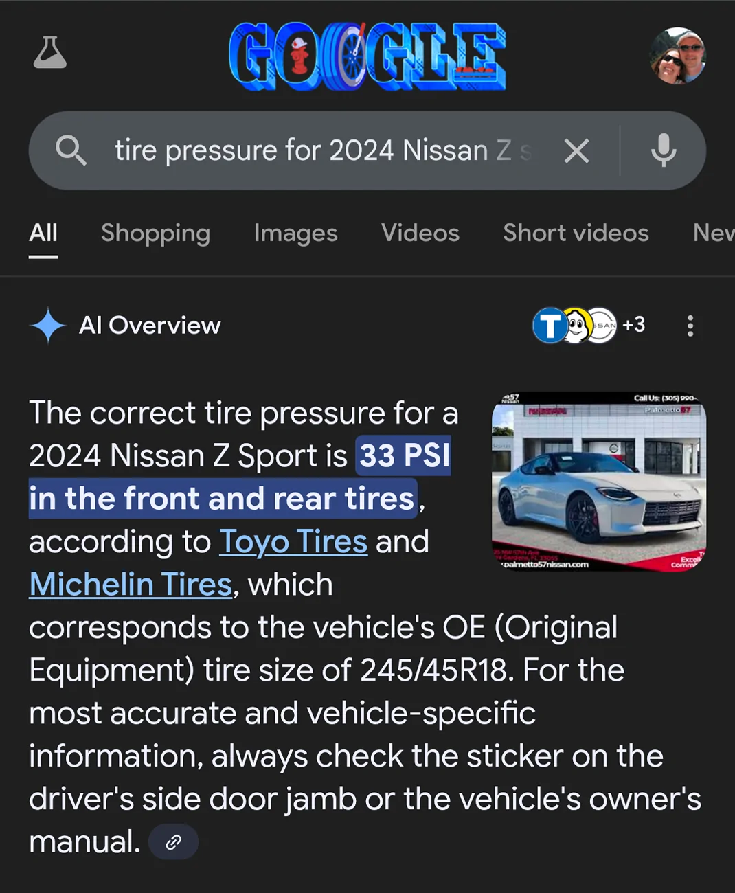

Your search string seems to have shown the results for the Sport, citing Michelin and Toyo. Anyone with a Sport care to share a photo of the door jamb sticker?

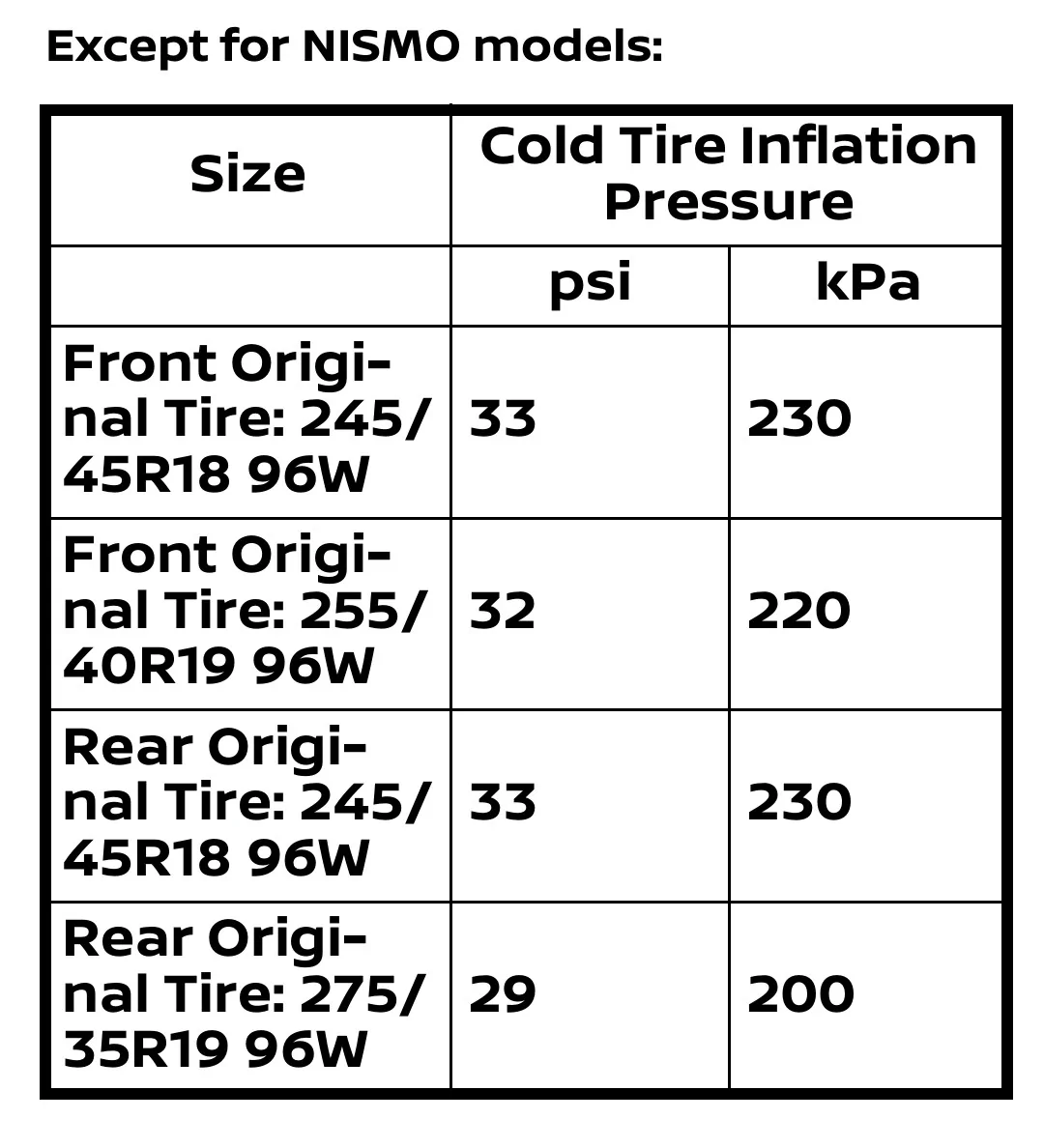

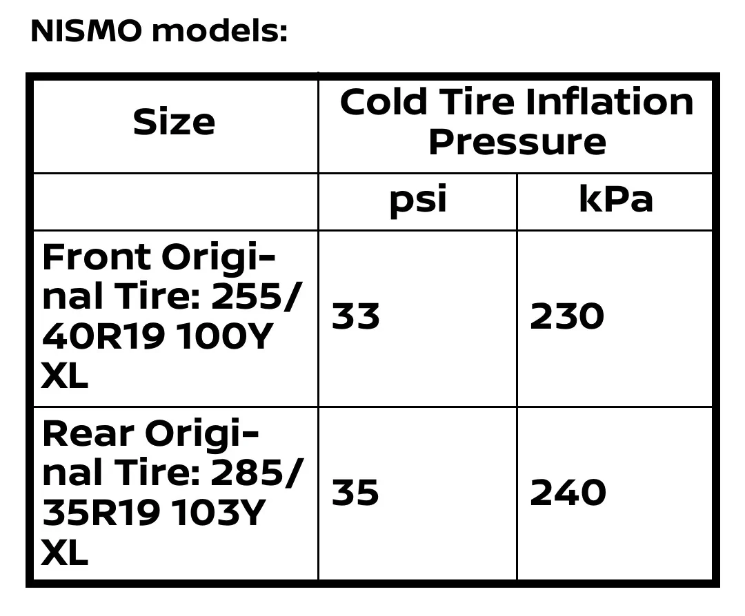

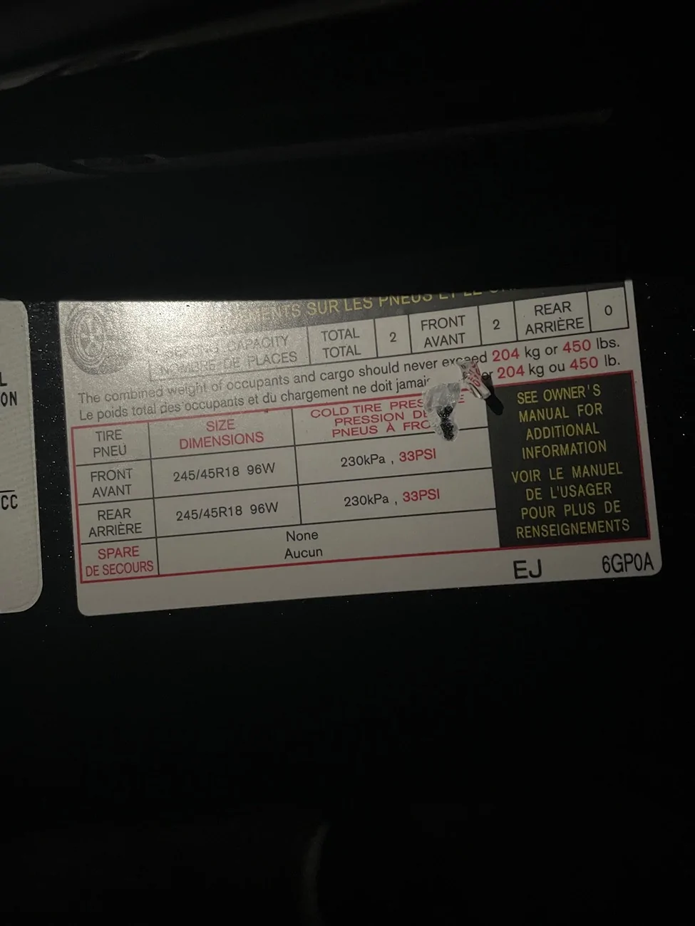

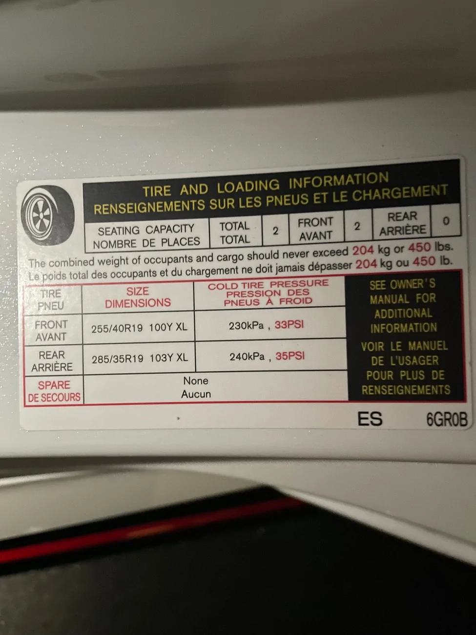

So it looks like Google got it wrong for the Sport, suggesting 35, but the actual is 33. Only the NISMO gets 35 and only for the rear tires.
Any members care to share their door jamb stickers? @yellowz6mt already shared their Performance sticker. @50thZ, you have a Sport, right? Care to share your sticker? Any NISMO owner out there care to share?
We can see if they match the data from the owner's manual.
Assuming the OP was asking about their Performance model, it seems like the only correct answer can be 32 front and 29 rear.
Giving the answer for a Sport to somebody asking about Performance seems like bad advice.
If your preference is to run something other than recommended, that also seems like the wrong answer for somebody who's confused about what the right answer is. The right answer is from the door jamb sticker or the owners manual. Hopefully they at least agree with each other.

24 Nismo door jam

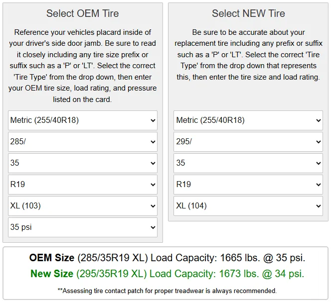

tiresize.com has a calculator for figuring out psi when changing to different sizes/load ratings.
https://tiresize.com/pressure-calculator/
