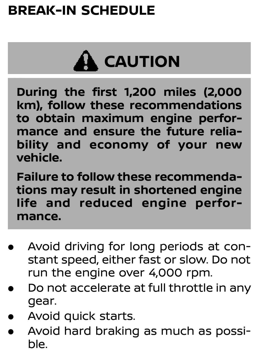

My break-in procedure.....
Don't short trip it. Run it long enough to warm up all parts fully to chase out moisture. That could mean run it at least 15-20 minutes depending on weather.
Don't race it. It won't necessarily hurt it, but no need to chance it. Modern engines are basically already fully in tolerance from the factory, but it's your money, do as you see fit (personally that one at the dealership with over 300 miles, I'd be uncomfortable with, not knowing what's been going on with it)
Early first oil change is a good idea.
No need to focus on rpms per someone's advice. The rpms get plenty of variety if you're driving around normally. Especially with the automatic. That's a myth about "this many rpms for this many miles" again, just not racing it would be enough.
Better yet, read your manual and ignore all of the random, varying advice from the internet.

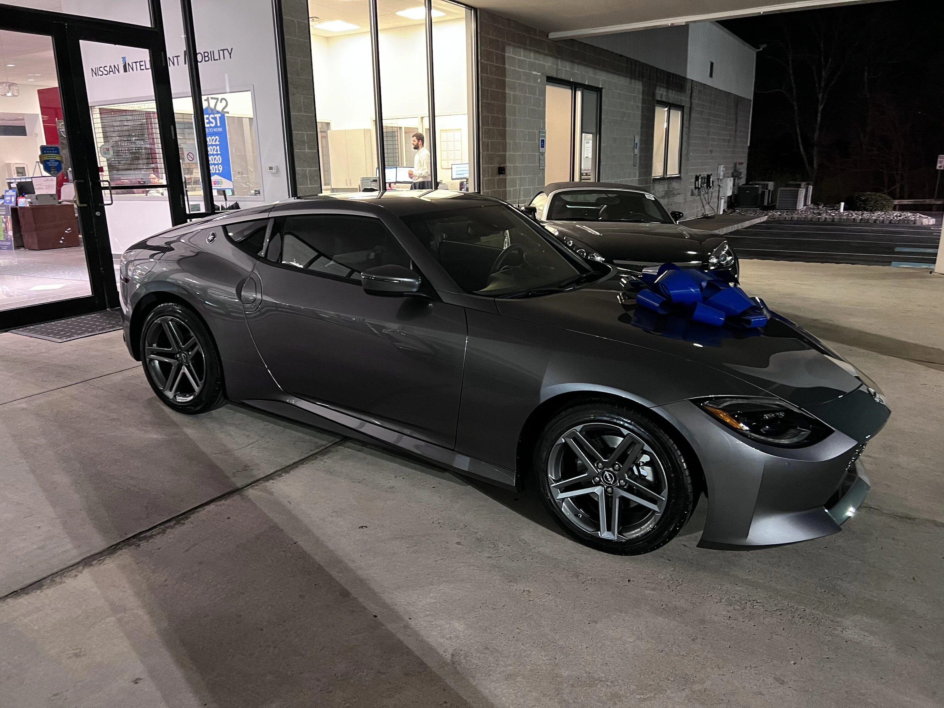

I just picked up my Z the other night and was wondering what, if any, is the break-in period before Jk can really start to drive the car a little harder. Don’t mind the bow in the hood….lol

14k to break it in? Scroll up to see somebody’s post and it’s saying 1,200 miles….
