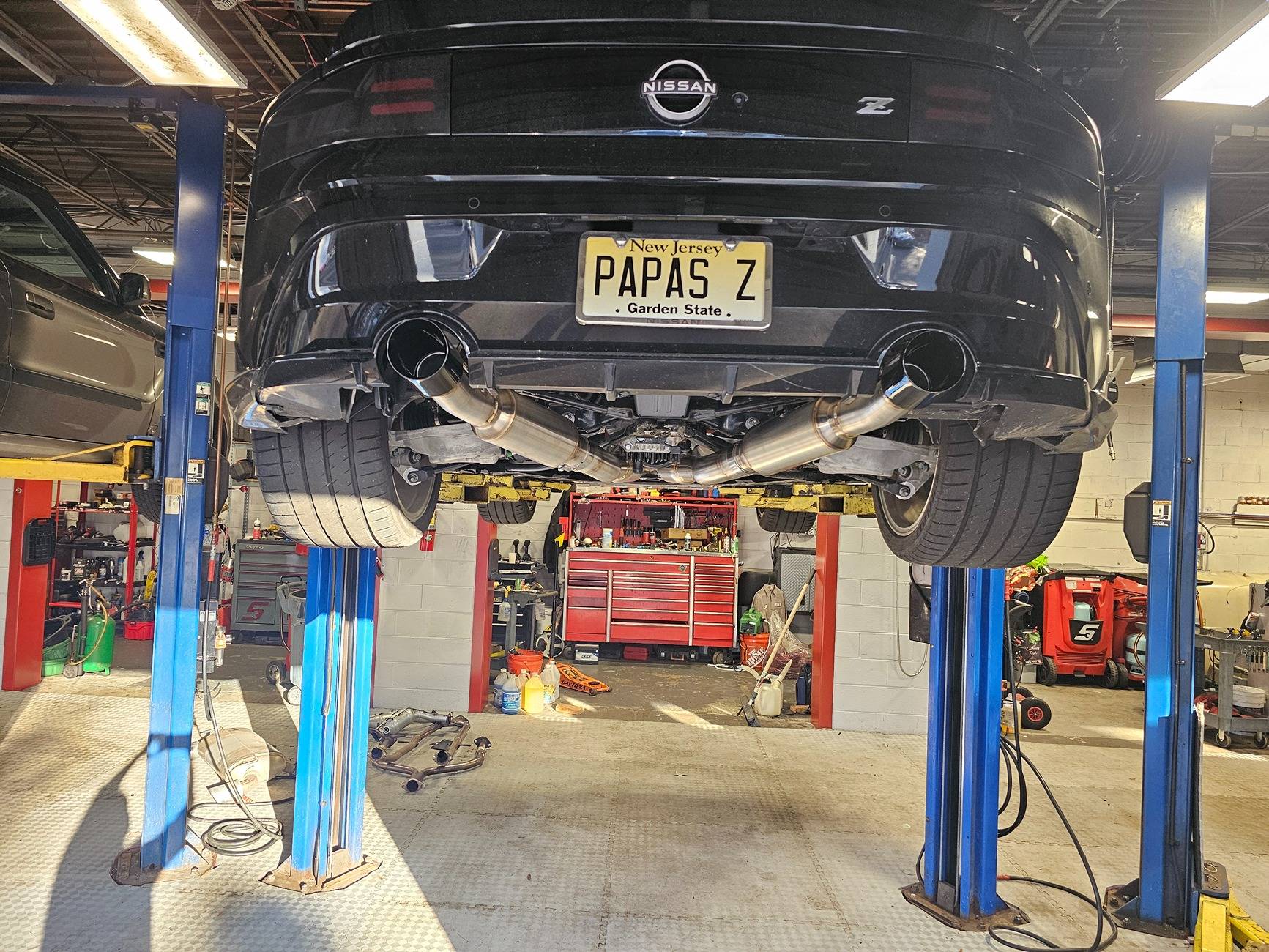

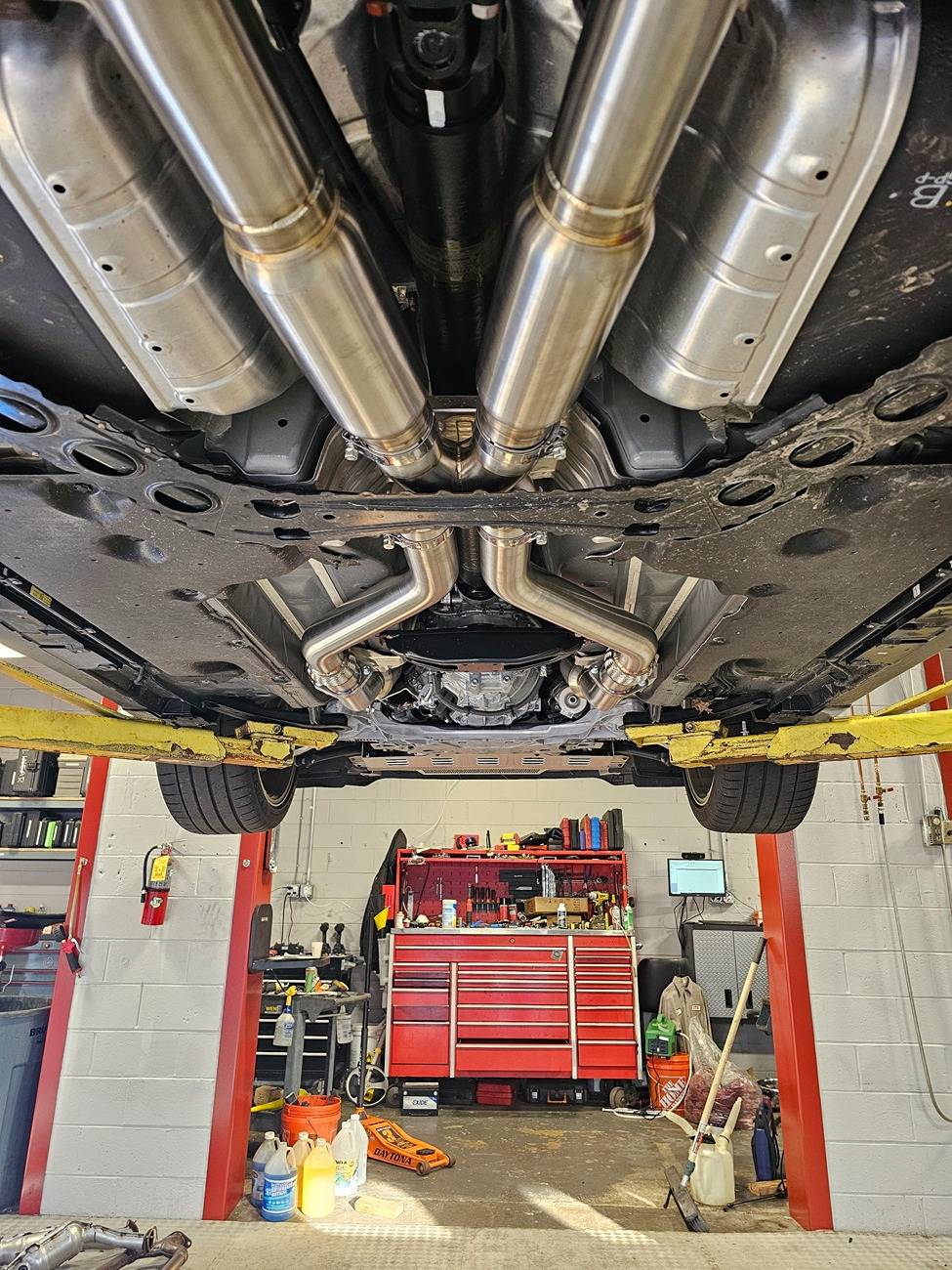

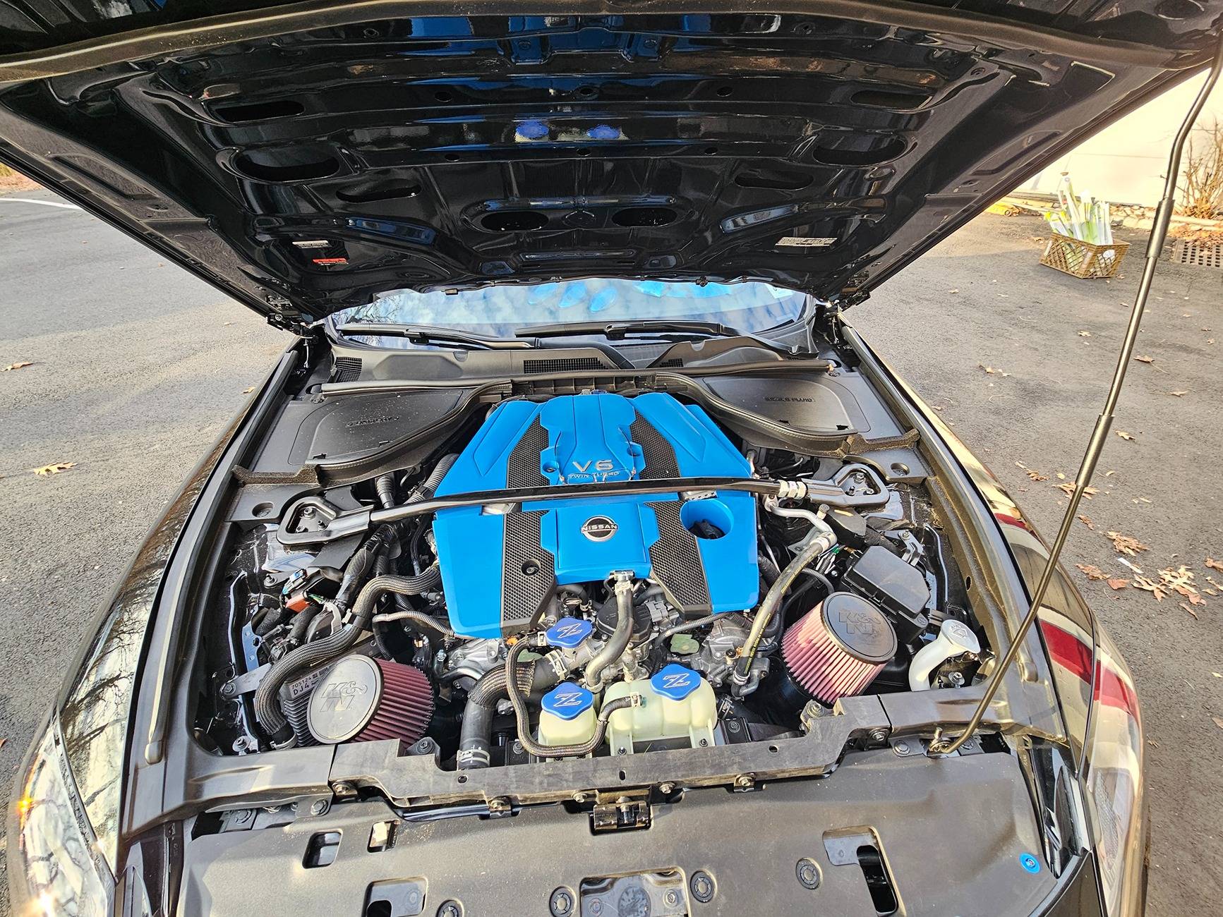

I get it and I researched when I got the car and everything I read and has been confirmed by tuners is these are bypass and really non-atmospheric. NO advantage. If you are looking for the "sound" go intakes. I changed my mod list from above it currently is 3" RAE Intakes which sound like a blow off valve, 3" RAE LDP's Resonated, 3" Catback RAE and SonicTuned - in the middle of tuing now. It won't let me post sound clips. I have posted on the "New Nissan Z" group on FB.
