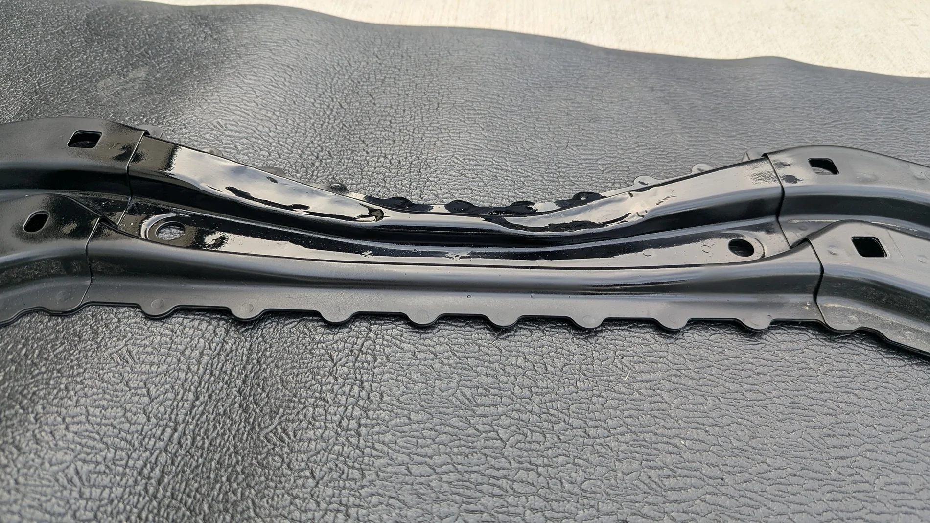

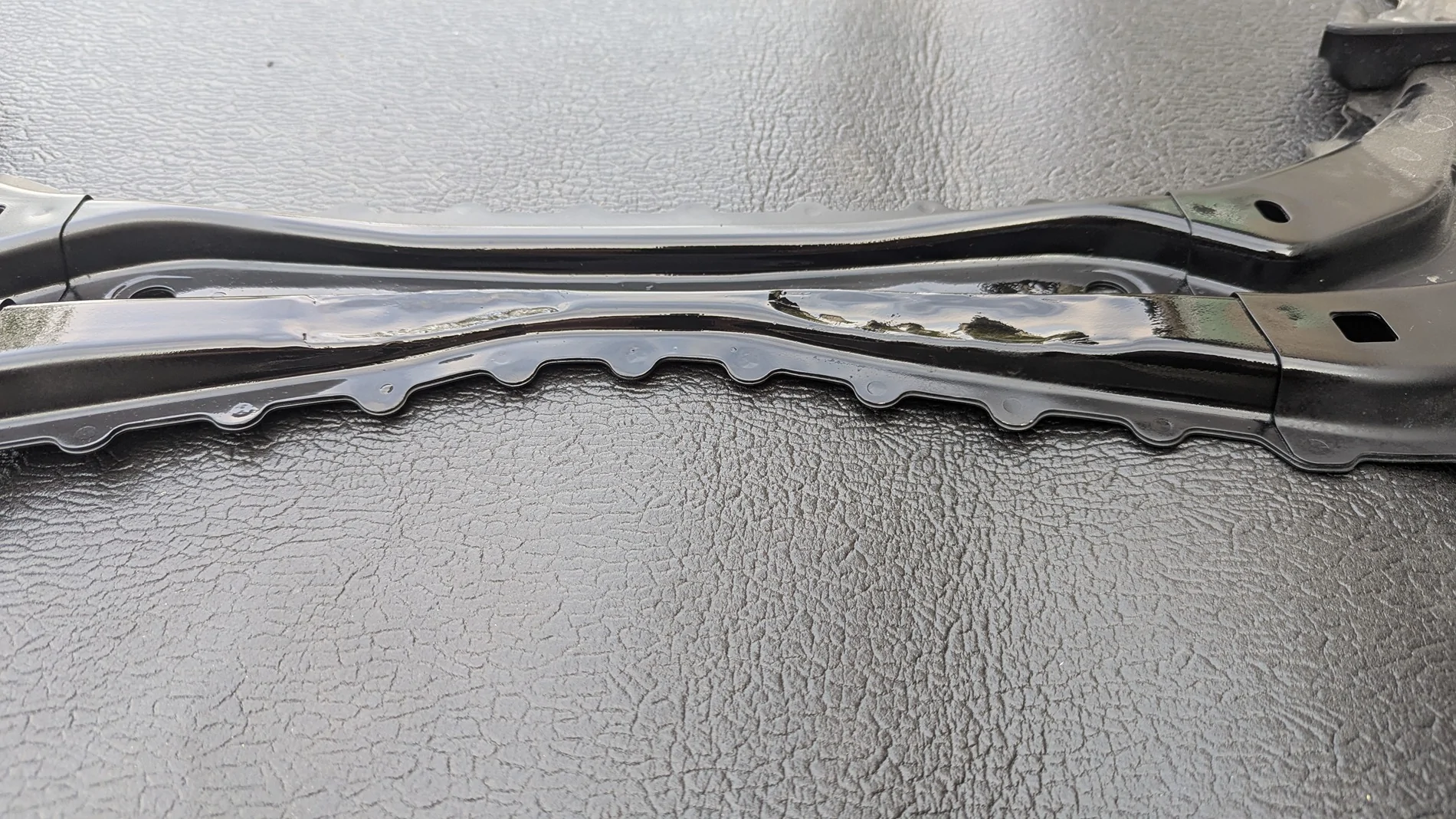

Update:
All parts installed. Awaiting on AMS to coordinate custom tune dyno time with my installer next week. Driving it in meantime, and wow! Without tune feels like 50-70 hp/tq plus at least. The Michelin's feel same as Dunlops on ride quality, yet grippier, and linear in traction. The 10mm wider on oem rims look right and fit wheel wells fine. No rubbing. Look good too.
AWE Touring Exhaust just right sounds for me. Bit louder than Nismo oem on part and low throttle, more at mid throttle, and much more on heavy. Though damn intermittent rubbing on undercarriage when off throttle and some bumps. AWE telephoned by installer, and no fix. Not often occurs but better if didn't. Will be trying some type of barrier tape. Installer researching.
Overall, very happy. Can't wait till tune done. Will report back when done.
Thanks all!
You likely need to massage & clearance your steel W-brace. It should be very obvious where it's hitting/rubbing.

The knocking of the exhaust is installer issue. It's a slip fit system, so tolerances stack as you get to the back towards the undercarriage brace. Make sure that the resonators are not under the brace that's the noise. On mine, we had to work with it on install to make sure the resonators cleared the brace, it just takes some patience.
