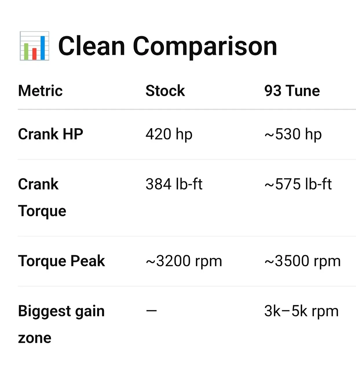

You are correct. I looked deeper, and the Wheel HP/TQ numbers would be less on 91/93 pump gas. Overall, it's looking like my pkg would amount to about 90-100 hp and 150 tq gain.
As per ChatGPT:
Stock is an official factory crank rating for the 2024 Z NISMO. 91 and 93 octane figures are estimates, because tuners quote wheel gains and map availability, not official crank outputs. I’m converting realistic tuned wheel-output expectations for this platform into approximate crank numbers using typical drivetrain loss, so treat the tuned numbers as best estimates, not factory-certified figures. Nissan Canada lists the 2024 Z NISMO at 420 hp and 384 lb-ft at the crank, and Z1’s current tuning materials confirm separate 91- and 93-octane map options for the 2023+ Z. (Nissan News Canada)
Setup
Crank HP​
Gain vs Stock​
Crank Torque​
Gain vs Stock​
Stock 2024 Z NISMO
420 hp​
384 lb-ft​
Tuned package on 91 octane
~495–530 hp​
+75 to +110 hp​
~530–580 lb-ft​
+146 to +196 lb-ft​
Tuned package on 93 octane
~515–545 hp​
+95 to +125 hp​
~550–595 lb-ft​
+166 to +211 lb-ft​
Those 91/93 ranges are based on a realistic tuned outcome of about 420–440 whp / 450–480 wtq on 91, and about 440–460 whp / 470–495 wtq on 93, then converted to crank output with a typical 15–17% drivetrain-loss assumption. That matches the general pattern from current Z tuning references: Z1 shows dedicated 91 and 93 maps for the 2023+ Z, and on its own test vehicle it reports measurable 93-octane gains, including 14 whp / 61 wtq max gains and much larger midrange peak gains at 4,000 rpm. (Z1 Motorsports)
Best single-number shorthand for your package would be:
  • Stock: 420 hp / 384 lb-ft
  • 91 octane: about 510 hp / 555 lb-ft
  • 93 octane: about 530 hp / 575 lb-ft (Nissan News Canada)
So, bluntly: your earlier numbers were a bit rich if applied to 91 octane by default. For 93 octane, the low-to-mid 530s crank hp is still plausible for a strong result. For 91 octane, I’d anchor it closer to the low 500s crank hp instead. (Z1 Motorsports)

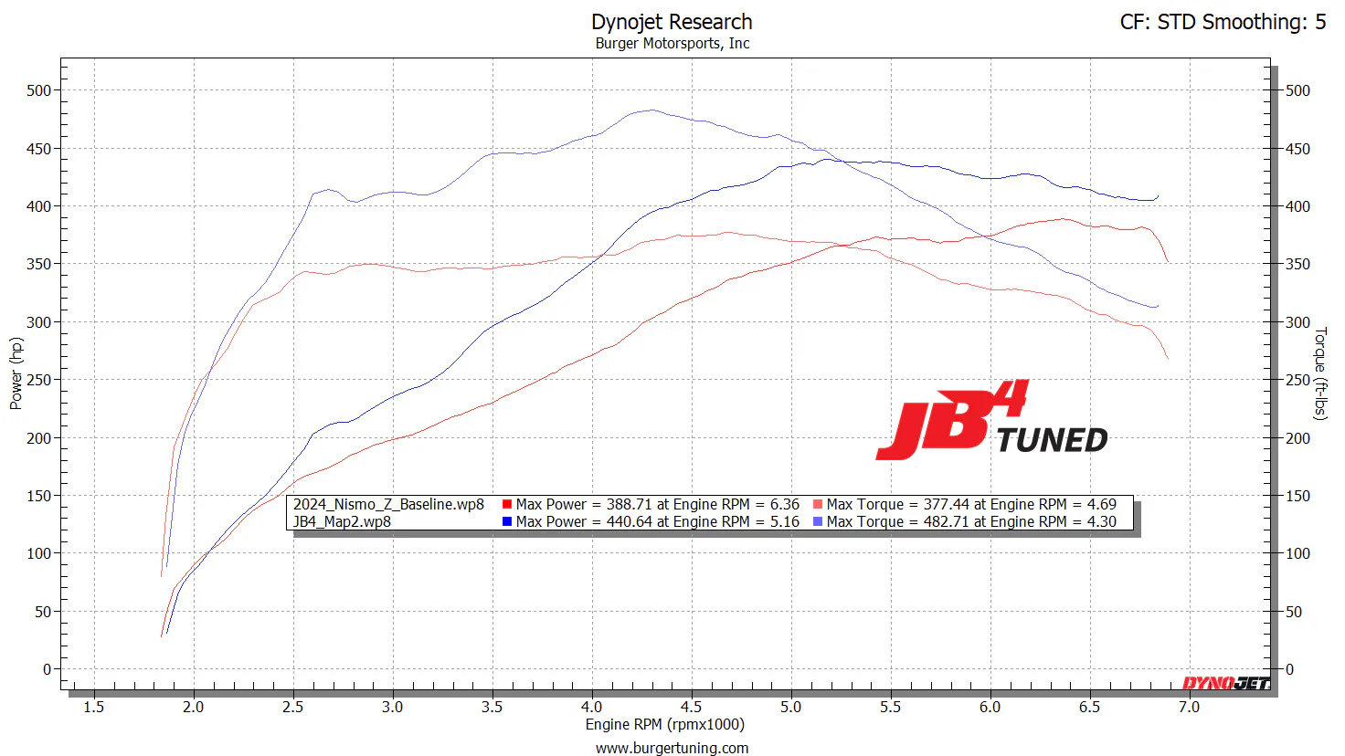

This is the most I've ever seen for a Nismo on 91 octane but I wouldn't trust this for two reasons.
It's 91 octane
And Map 2 on JB4 is +5 psi with that low quality gas.
What I find most interesting about this power difference though is the Nismo was completely stock(no intake, ldp or exhaust) with the crappy 91.

Interesting. Am I reading this correctly? Stock Nismo no mods other than tune on 91? That's impressive then!
