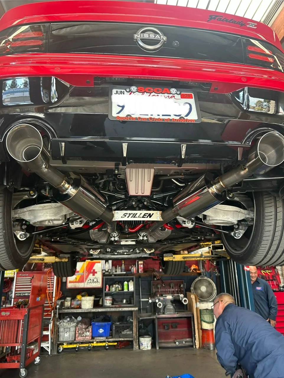

Most people buy catbacks or axle backs for sound anyway, so it's good to personally hear other cars and ride in them to compare, then decide. Only if you need to mod for huge powers that you need DPs, catless, etc.
Mine to compare, at install, catback with the merged collector. Street version for daily, I will get the Competition pipes replacing the mufflers later, but not for street.

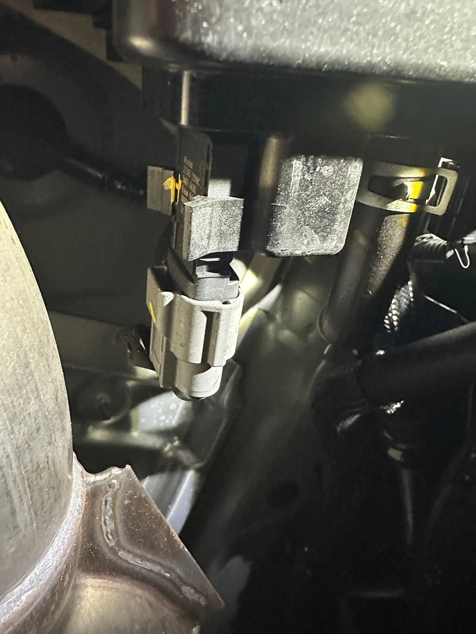

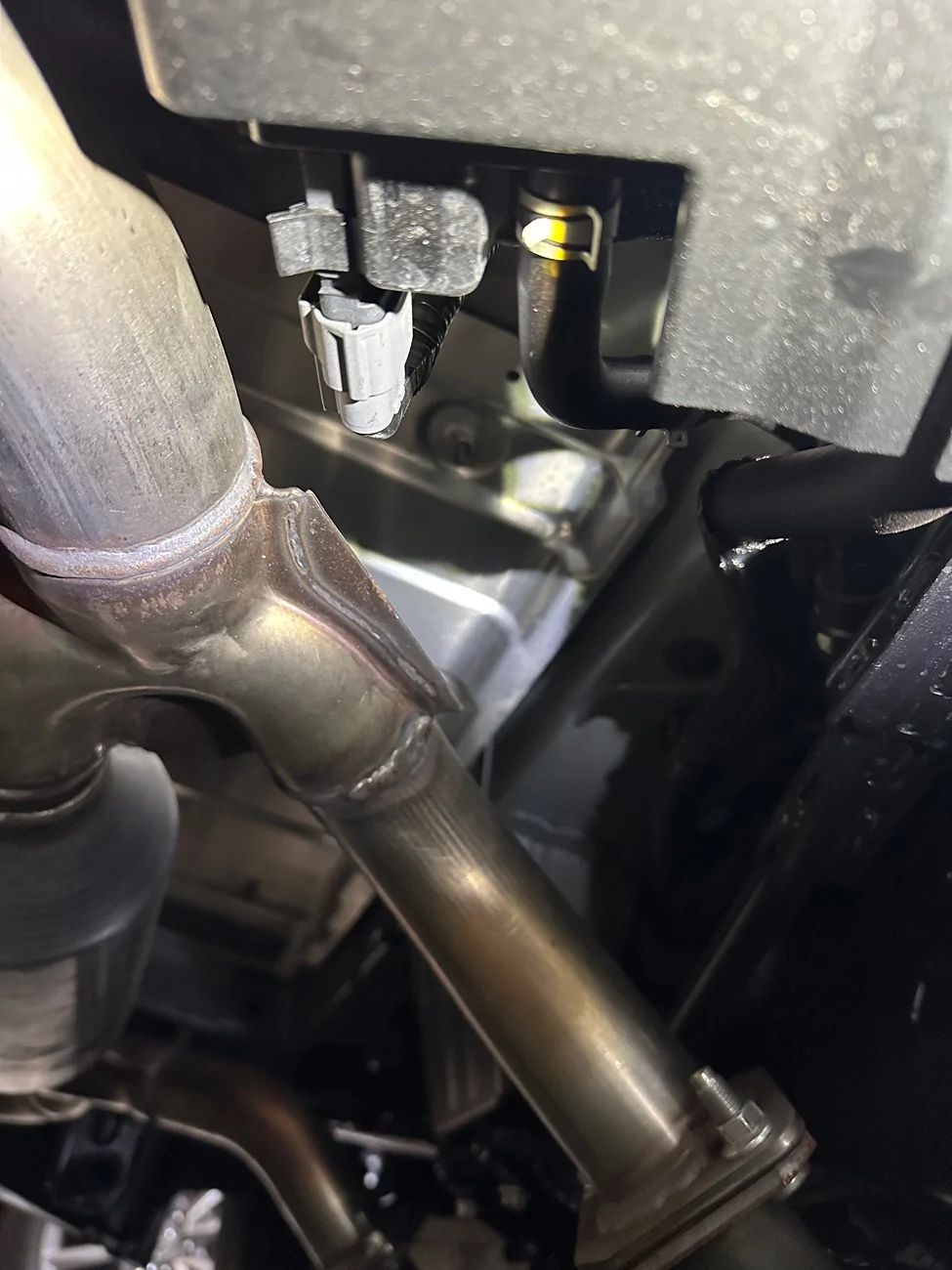

Yes you still have to relocate on the track version. It was a 5 minute change - added the included piece of tubing to move the sensor out of the way and secure it.
This is exactly right. It is a very simple process and we provide all things necessary to perform the relocation (including a custom fitting) for peace of mind under potential higher operating temperatures.

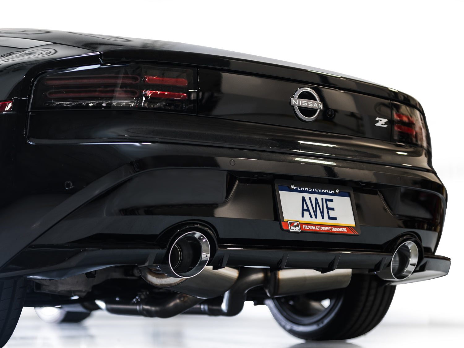

On another note, the large tips sit perfectly in the center of the rear bumper cutouts. They are adjustable to be able to sit flush with the bumper itself, or stick out slightly (your preference).
We found other systems and smaller tips to feel out of place in those large cutouts. As you can see, even in chrome silver, they sit nicely within the space.

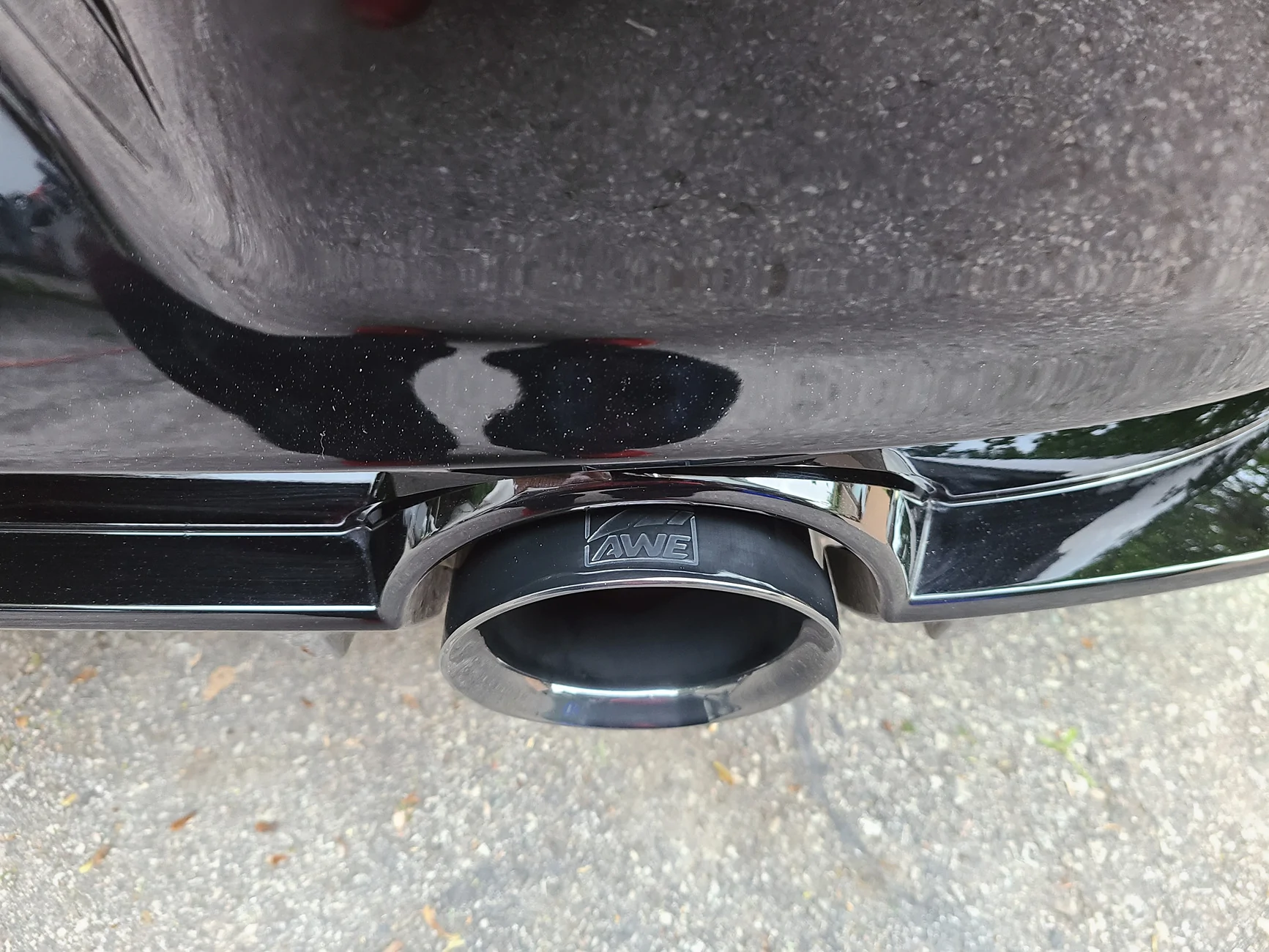

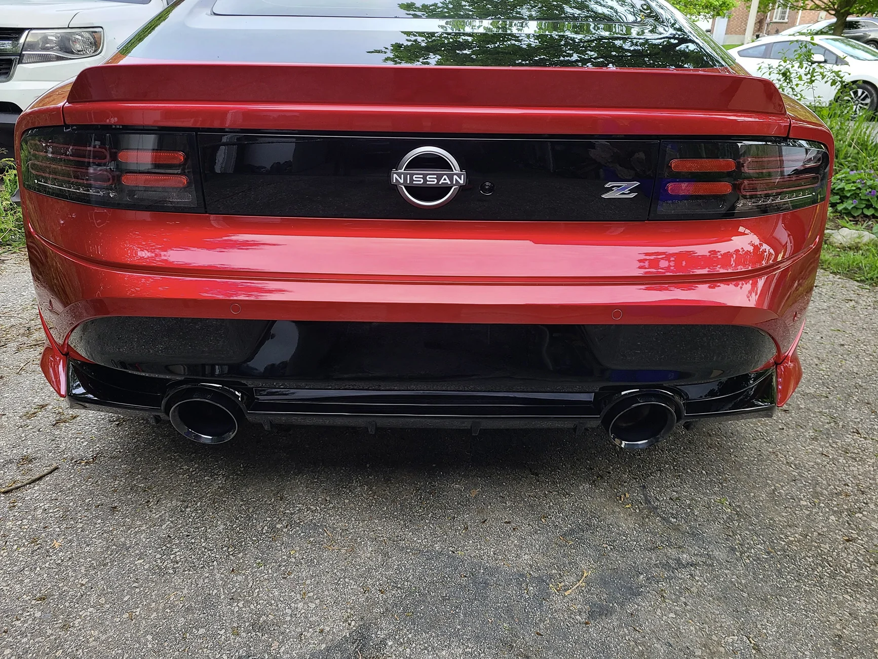

I went with a peek fitment.
The black tip looks super nice against the black trim
That really looks good, I like how you extended the tips past the bumper. Man, making me want to pull the trigger. The 5" tip really fills the gap well as pointed out by Christian.
Also our tips have a warranty on their finish, and last a long time when maintained. We made them removable because people love to change up the look, or freshen up after a harsh winter.

Oh my - can’t believe the evap sensor is located this close the to exhaust and outside of the canister cover. Could have easily located this on the front side on the canister behind the cover for protection. Need a mod to remove the consister all together…
