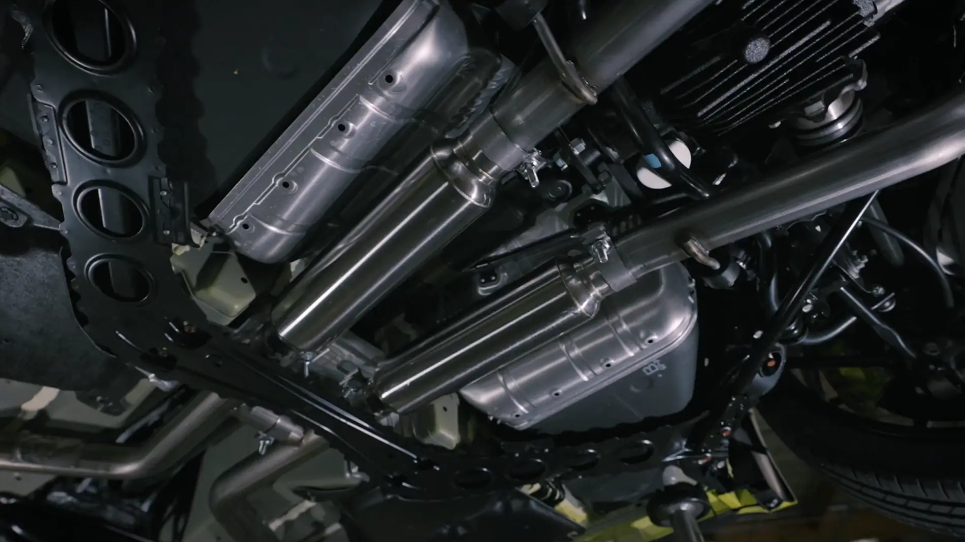

The aFe/Takeda catback has bolt on resonators, you could swap out glasspacks at will without cutting anything.

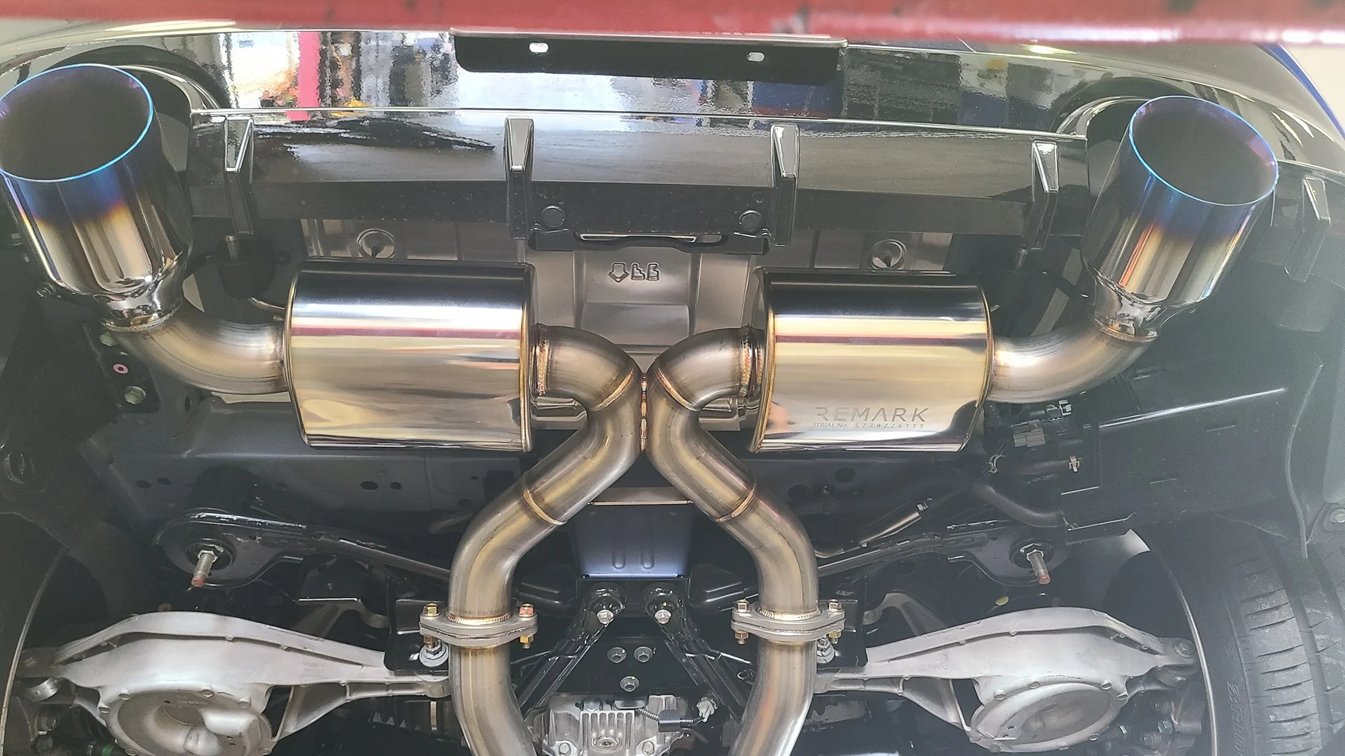

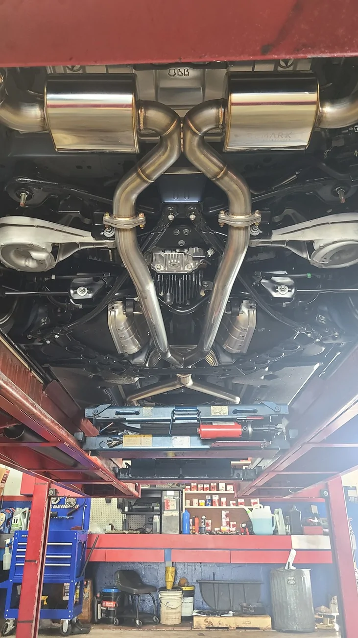

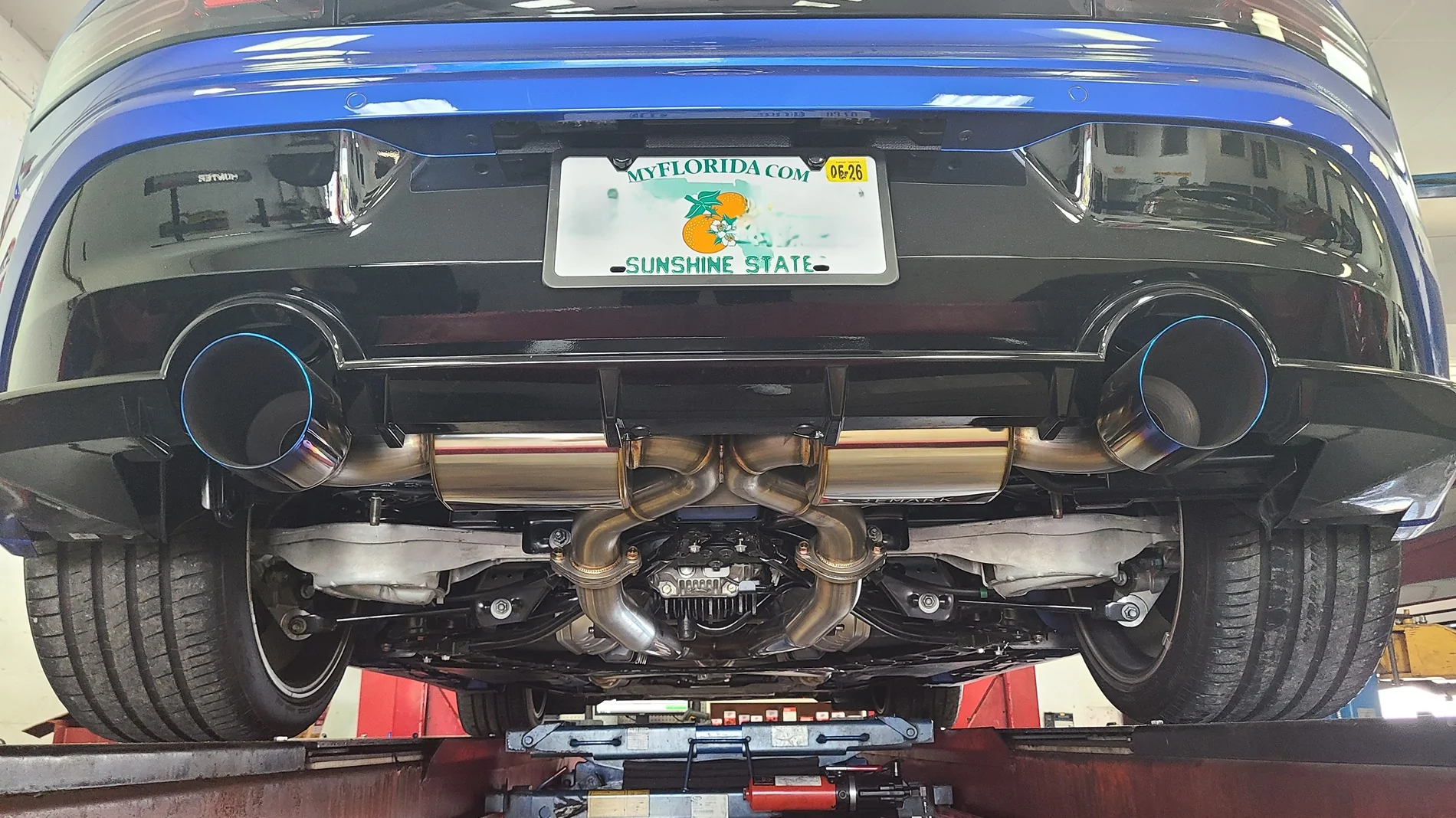

I almost did, but went in a different direction instead. I've always loved the look and sound of the Remark V2 axleback for the 370Z, so I took a chance and bought that.
The spacing between tailpipe exit holes in the rear diffuser are the same for both cars. At the same time, I purchased the Remark Y-pipe and non-resonated mid. However, there was a fitment issue - specifically - the spacing of the Remark midpipe exit flanges is wider by about 1 inch on the new Z, fortunately I know a fabricator.... I should add that the V2 backbox bolts directly up to the OEM midpipe and creates a mild increase in exhaust volume.
I'm waiting on delievery of the CZP/PPE resonated lower downpipes, I'll have the hangers adjusted for better tailpipe fitment when those get installed. I'll post clips when it's completed for anyone who's interested.

Very nice i love the clean lines and bolted flanges instead of the slip joints like others. didn’t think to look at the 370 versions.
I like the rz34 version with non-resonated mid-pipe and straight pipe axle back. Since this is 2.5, should i stick with 3” lowers or 2.5”? Also, I’m concerned with the 3” merge collector - is that large enough for ~475WHP?

Even a single 3" exhaust has no problem supporting ~500whp on boosted applications.
