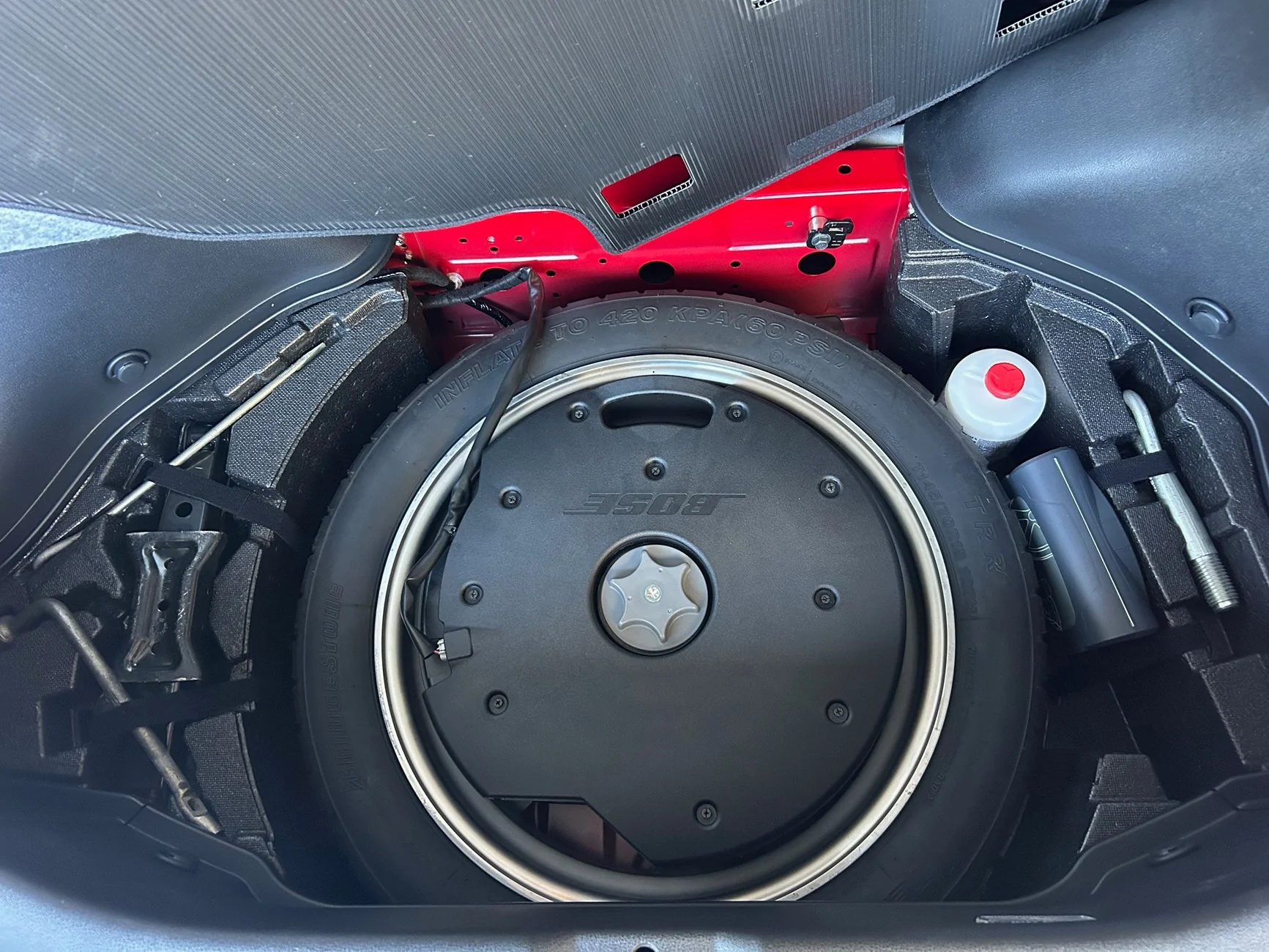

Finished adding the jack accessories, all Nissan parts. Nice and tidy.
Jack tools - lug wrench, handle, tow hook, jack - were found in a local wrecking yard from a late model Infiniti and Altima, easy pick a part.

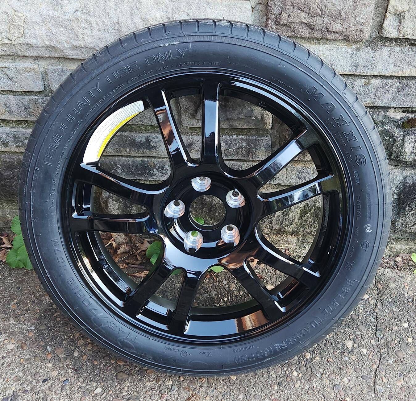

I paid about $500 for the 19" easy spare. I feel better with new rubber, if im going to lug it around for a few more years. The bass is upgraded !

24 Z Performance 6MT

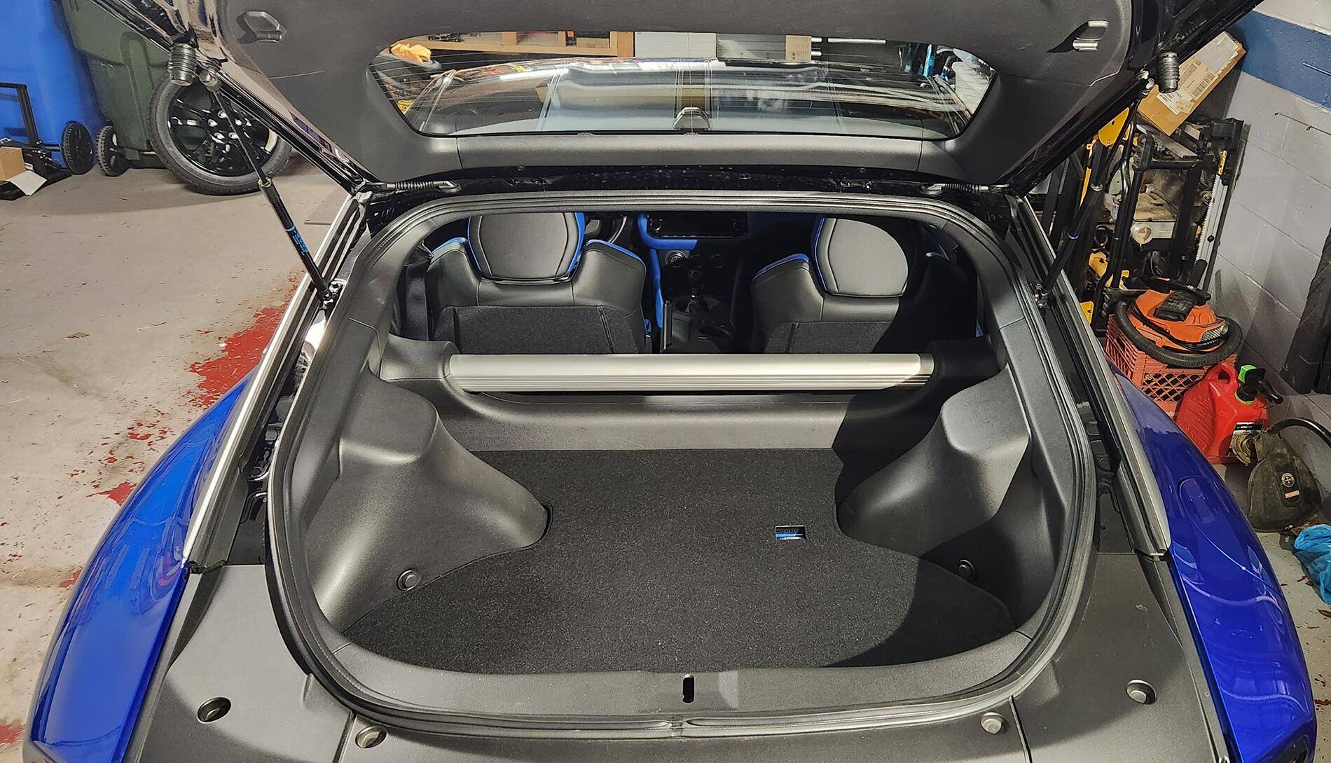

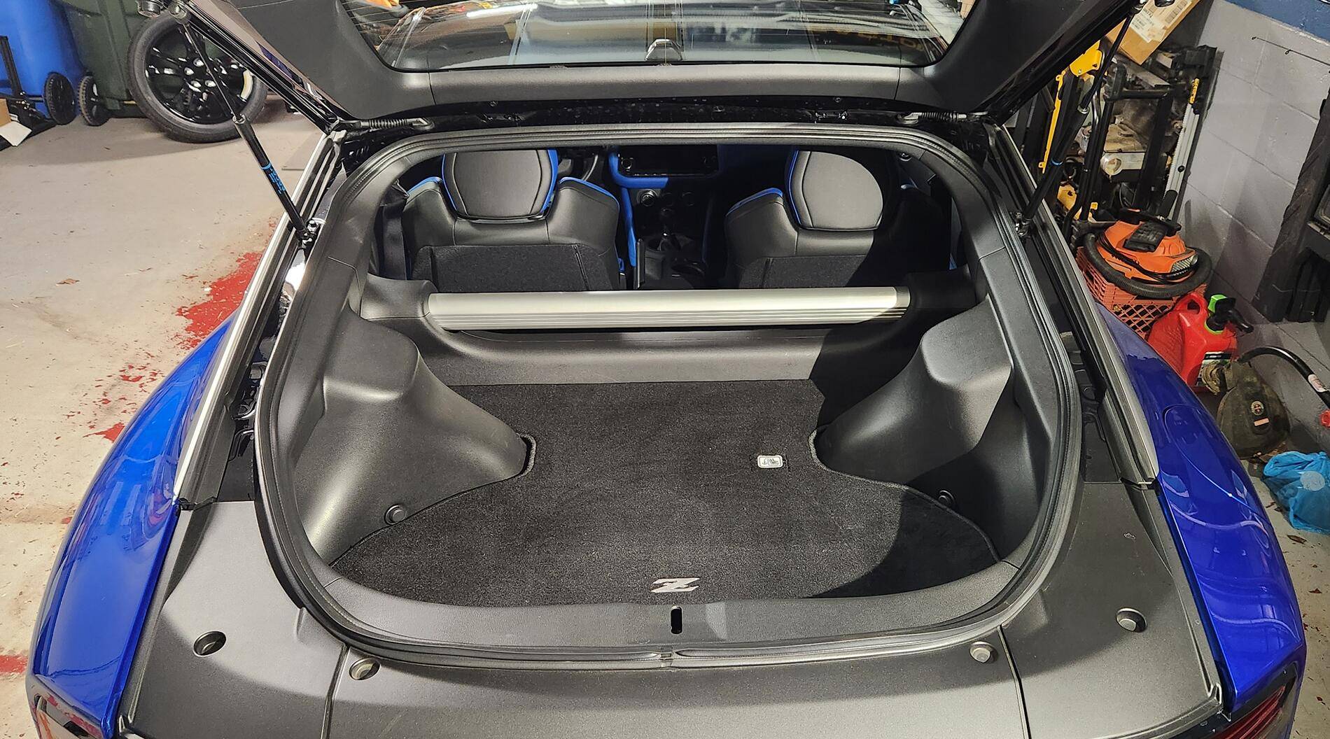

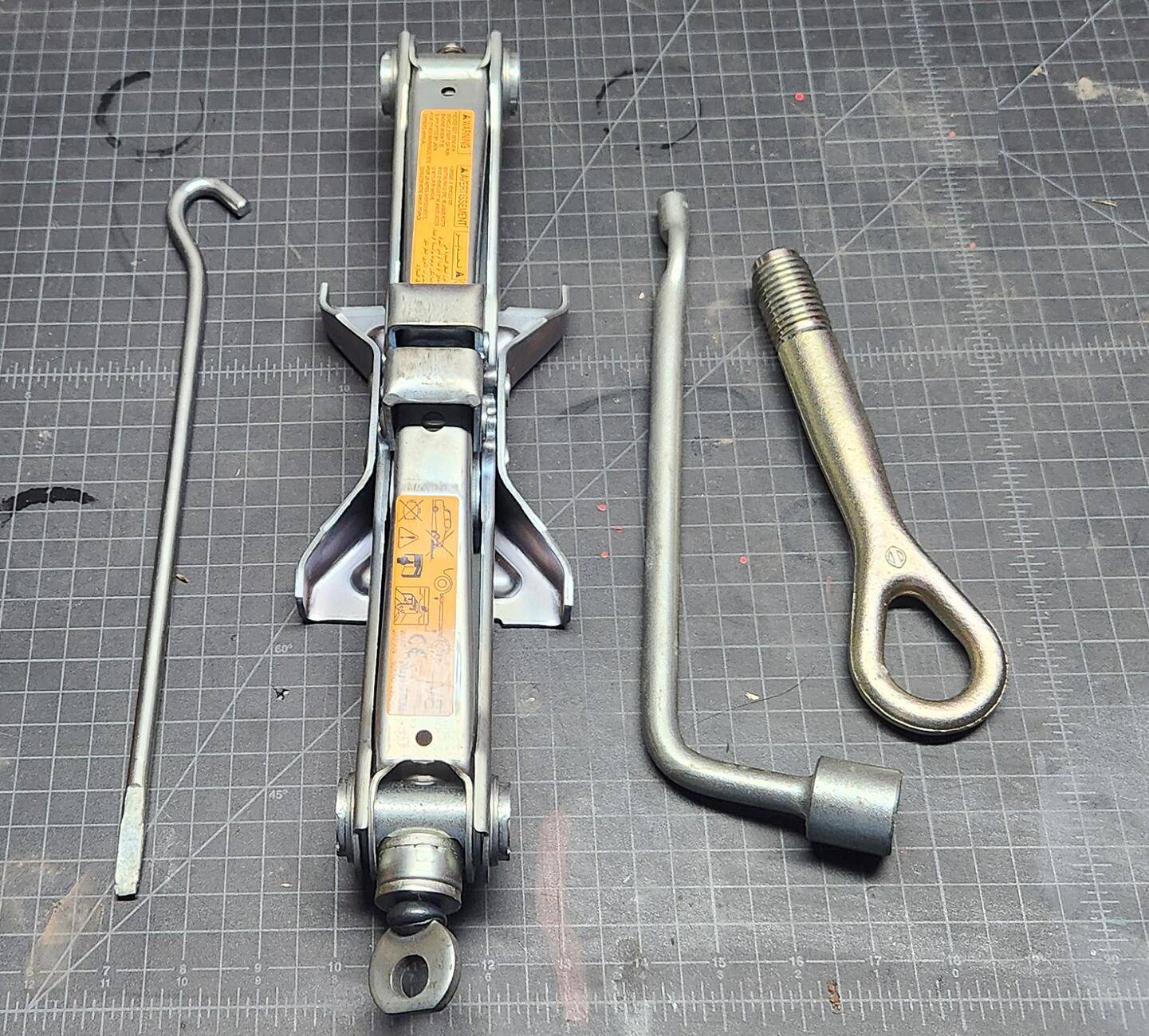

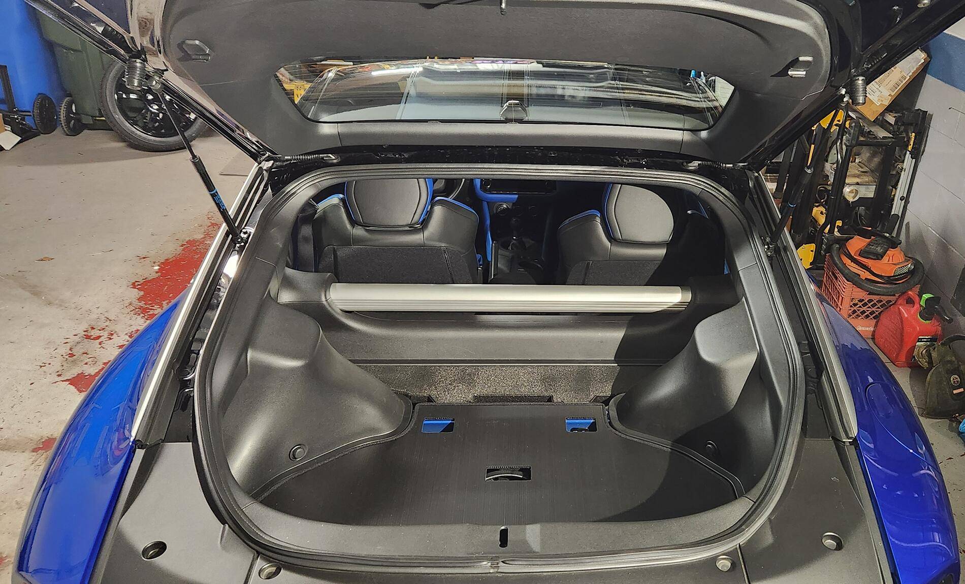

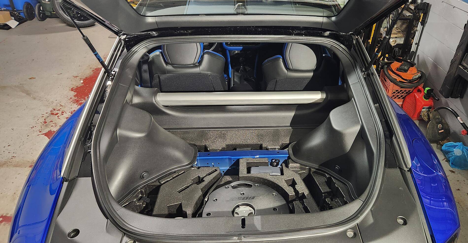

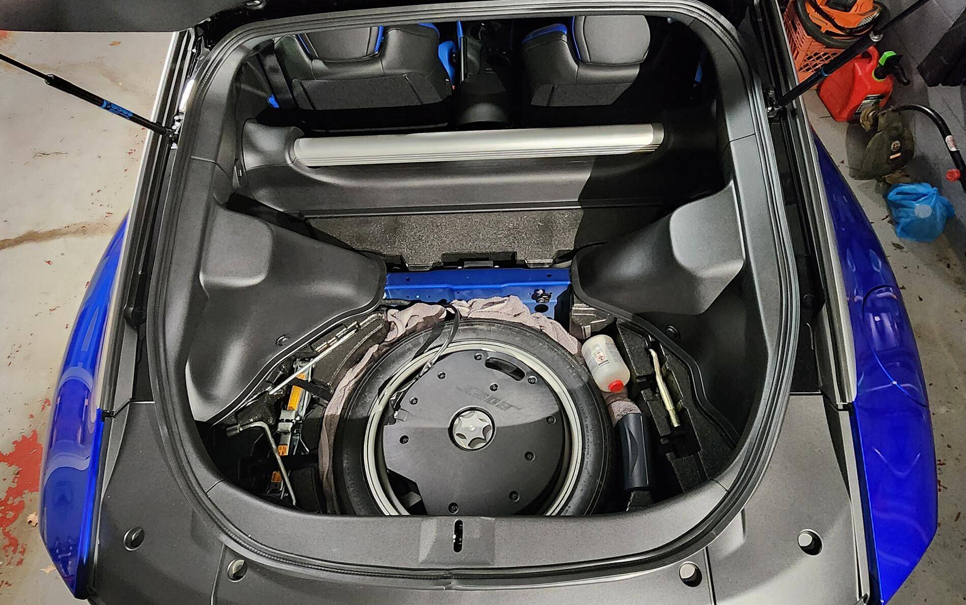

Well since the new Z does not have a spare, and it has the room, I figured why not.
I ended up buying two things from eBay. A compact spare from a 2015 Q50 (18x4) and the jack/tools from a 370Z. (Spent around ~$190)
Next, lets get into the back of the Z. First we have the Rear mat.
We get that out of the way, and we have the under-liner.
Now that we got that removed, we go down one more level, and we hit a plastic insert.
Finally, we are at the the bottom and we can see our foam inserts.
The entire middle foam insert was removed, and I'm in business with a spare tire. The jack, tools, and tow hook all fit into the OEM foams.
I ended up stuffing some old towels around the tire just to make sure it does not slide/move around. The plastic insert, under-liner, and rear mat fit back on top without any bulging or fitment issues. For under $200 bucks I'd say it was worth the addition.

does anybody know if an Infiniti spare tire with a 155/80/18 tire will fit? The wheel is 18x4 but the tire spec is different. everyone I'm seeing that added a spare looks to have 145/70/18.

The Akenono 4 piston 355mm front calipers are the same on both cars if I'm not mistaken, so the temp spare you would need is the Sport Sedan/Coupe's 18X4" T145/70R18, MPN# 40300-JK00B: https://www.ebay.com/itm/234803374723
Sport model Coupes sometimes come with 19" wheels, but the spare is the same as the sedan since the trunk cutout is the same.

I just completed installing spare tire in my Z. It was quick and easy. Purchased a used spare (145/70 R18) from a 370Z off Ebay for $180.
