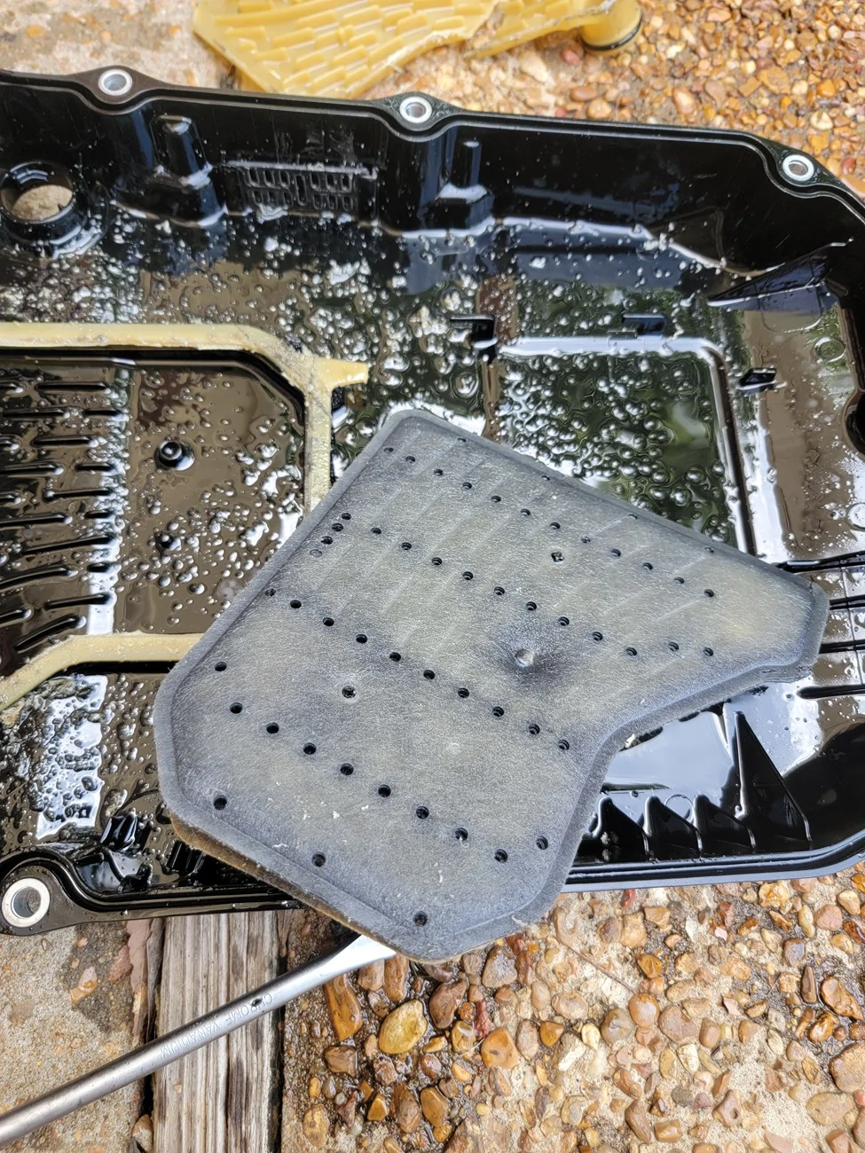

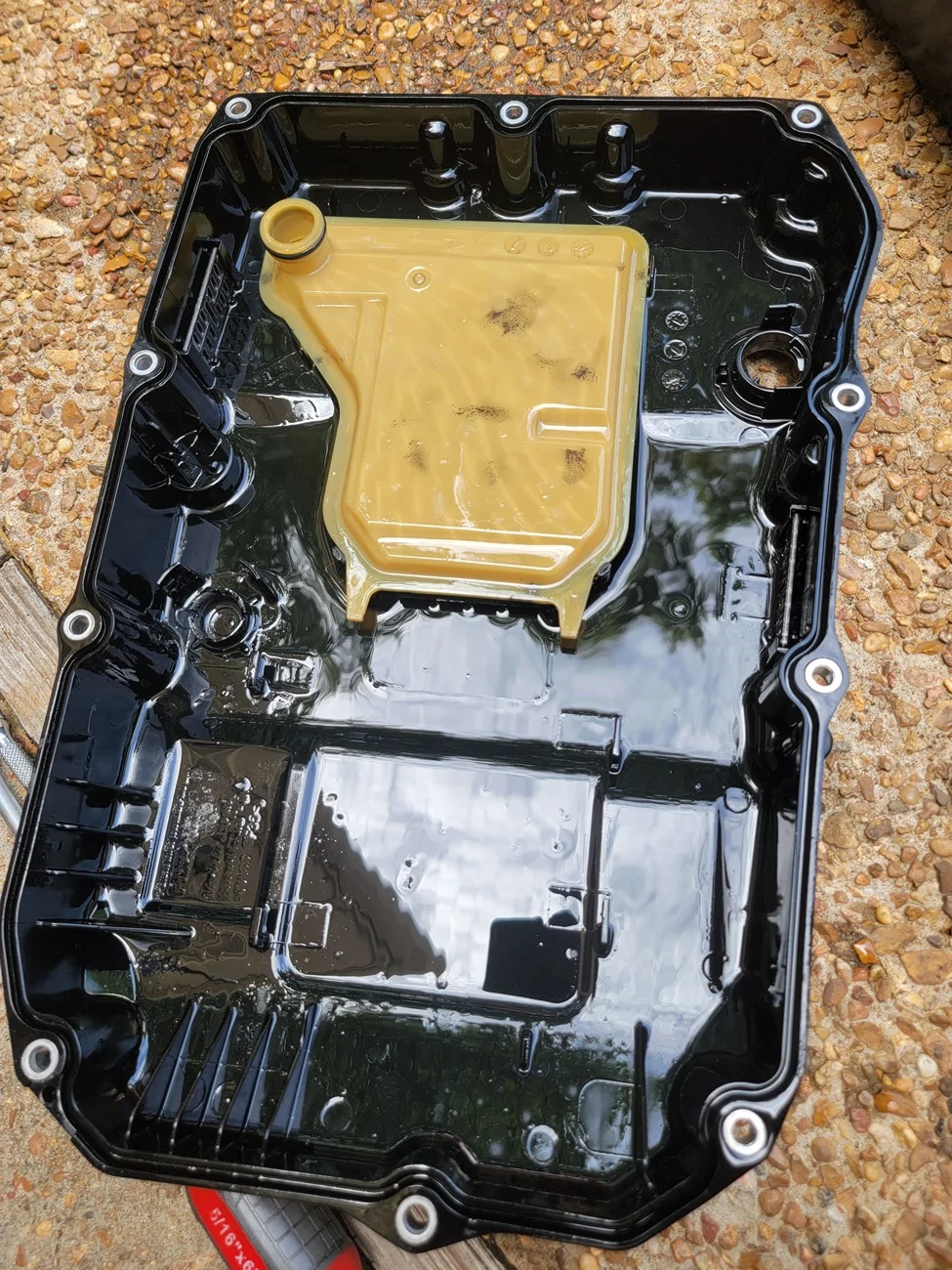

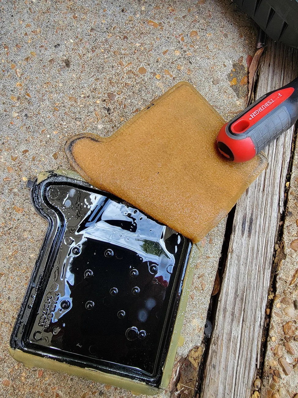

Just did the trans and diff service myself with 40K+ on the clock. Just like the oil, the diff got changed early and then again at 20k and present. Got the pan and trans fluid from Z1. Got the special tool off Egay. With the pan bolts being aluminum I did get new ones. It's hard for me to tell someone how easy or hard a job is because I've spent my whole life professionally turning a wrench on aircraft (A&P), Cars and motorcycles. With that said, it's not a bad job at all. I have to tell you the drain fluid looked as good as the new stuff. There was minimal wear material on the magnets or in the pan. I cut both filters apart to inspect again for what I believed would be break in material. There was very little and certainly not enough to swap out the pan. As far as it shifting better after the service. That would be like saying how better it pulled after putting a louder exhaust on. In the one pic disregard all that stuff you see in the pan. The filters aren't made to separate from the pan and one of them didn't want to so I filleted it still attached. 30K down the road I'll still do a standard drain and fill. None of my cars get abused or neglected but they do see a lot of severe duty.
