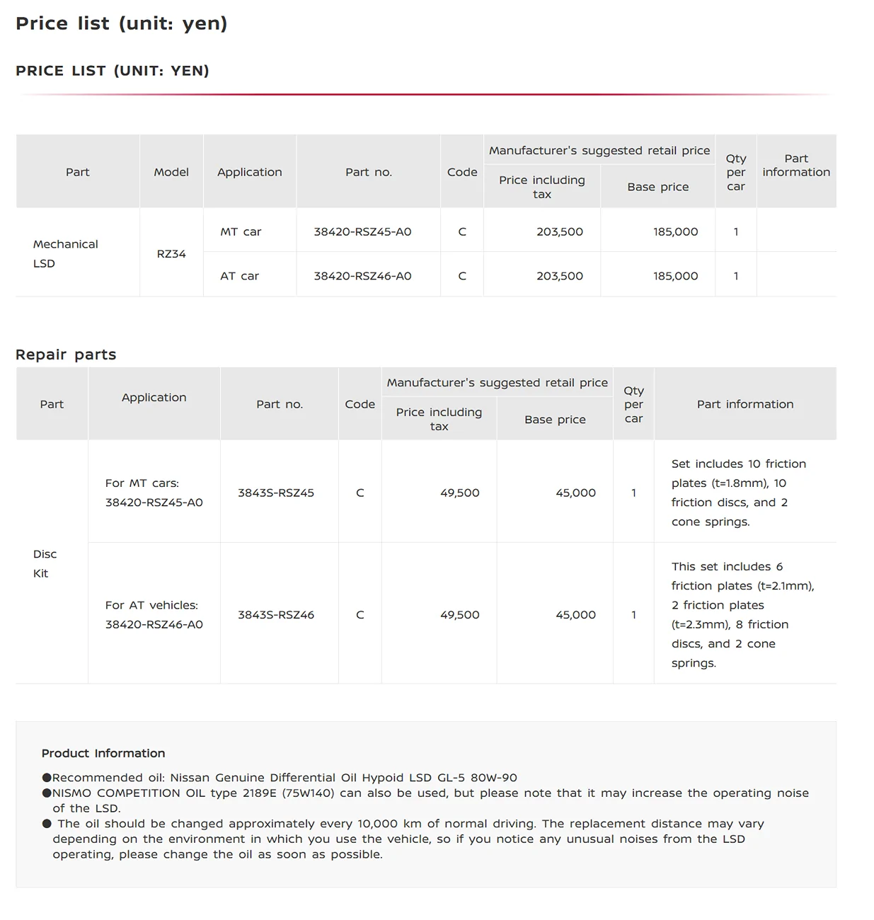

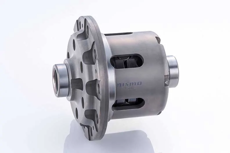

Nissan Motorsports & Customize Co., Ltd. (Headquarters: Chigasaki City, Kanagawa Prefecture; President: Hiroshi Sanada; Abbreviation: NMC) will release a new mechanical limited-slip differential (LSD) for the Fairlady Z (RZ34) manual and automatic transmission models as a new product under the NISMO brand. (Shipping starts: end of June)
This LSD is designed to suppress unpleasant operating noises during normal use, while still performing reliably when needed, such as when there is a difference in rotational speed between the left and right wheels. It improves vehicle stability in high-speed corners and on wet highways.
specification:
Differential typeR205V Enhanced
Initial Torque 49 Nm (5 kgf·m)
Operating method2WAY
Number of plates10 pieces + cone springs for manual transmission vehicles;
8 pieces + cone springs for automatic transmission vehicles.
Cam angleDrive side 20° / Coast side 40°
(Can be changed to 25° / 50° by rearranging the pressure ring)
Kit contents: LSD body oil seal x 2, drive gear bolt x 10, side bearing x 2, drain plug washer x 2
Compatible vehicles: Fairlady Z (RZ34) MT all models Fairlady Z (RZ34) AT all models
Manufacturer's suggested retail price: 203,500 yen (excluding tax: 185,000 yen)

a clutch type LSD should lock harder than stock
and also, in theory, rebuildable to lock 1/1.5/2 way and also different levels of lockup

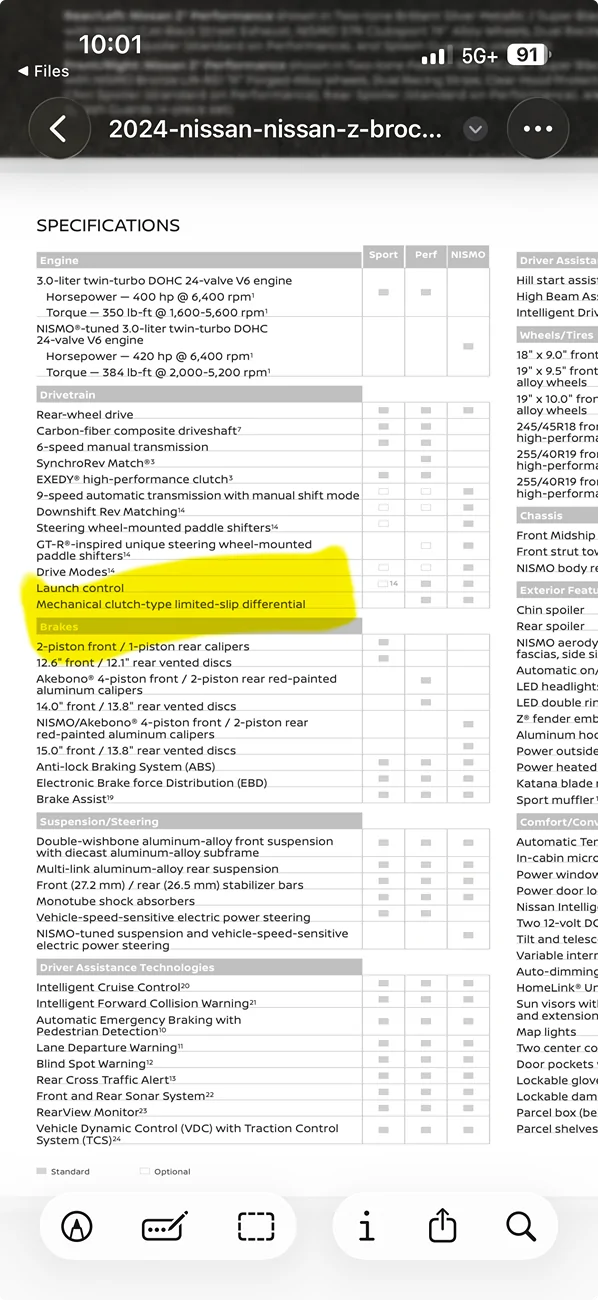

Dont know advantages (or disadvantages) without knowing the specs of the OEM diff, 1 way vs 1.5 way and the locking angle(s). Google bot says the OEM is a 1.5 way unit, but it’s not always right, so idk. The NISMO units above are 1.5. If OEM is 1 way, the main advantage is going to a 1.5 with this diff and gaining different rear end characteristics off-throttle and under braking. It’s also adjustable, so you can change the locking angles to be slightly more or less aggressive, depending on how it’s set out of the box.
The OEM unit is 1.5 way, with I believe 6 clutch plates, the cam angles mainly decide how responsive it is to locking, while a specific combination of cam angle and the locking mechanism for increased torque below. The stock Nismo also has an upgraded differential compared to the performance AT; the same is for the new manual variant. Any more questions regarding diff behavior is also welcome.
