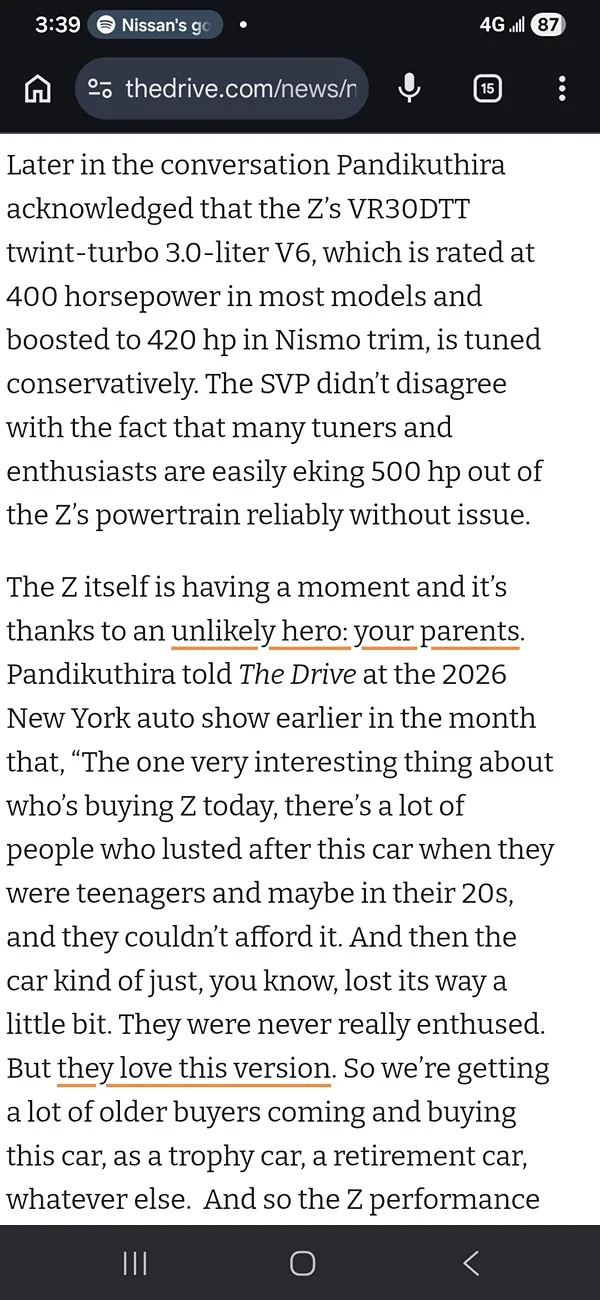

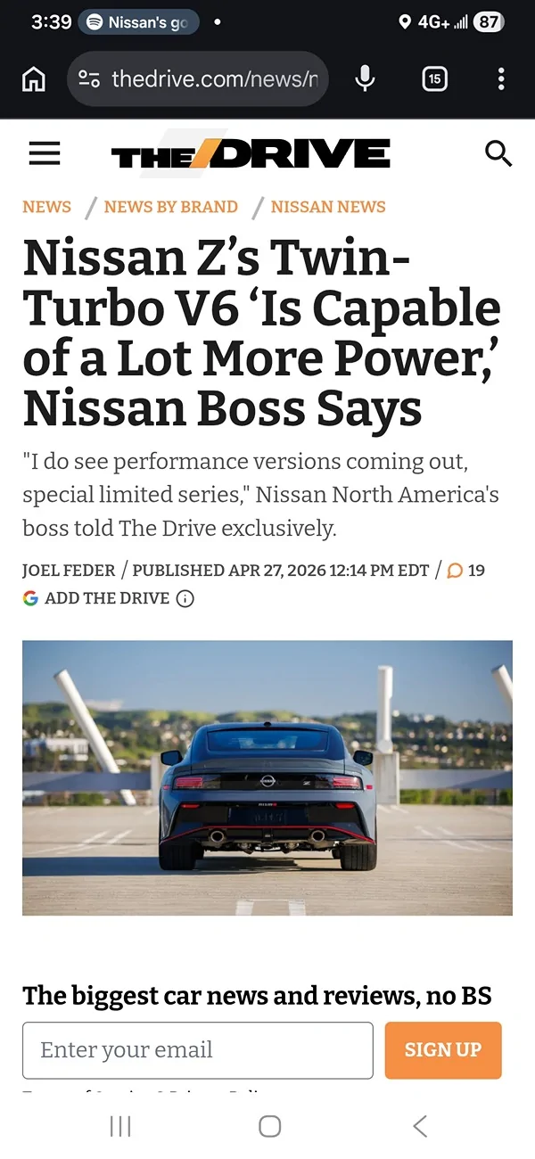

The motor is conservatively dialed down from factory.

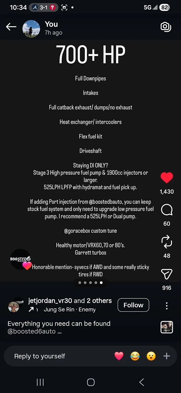

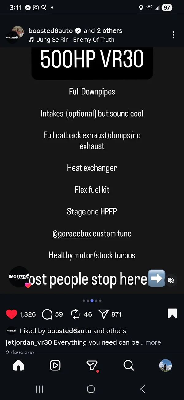

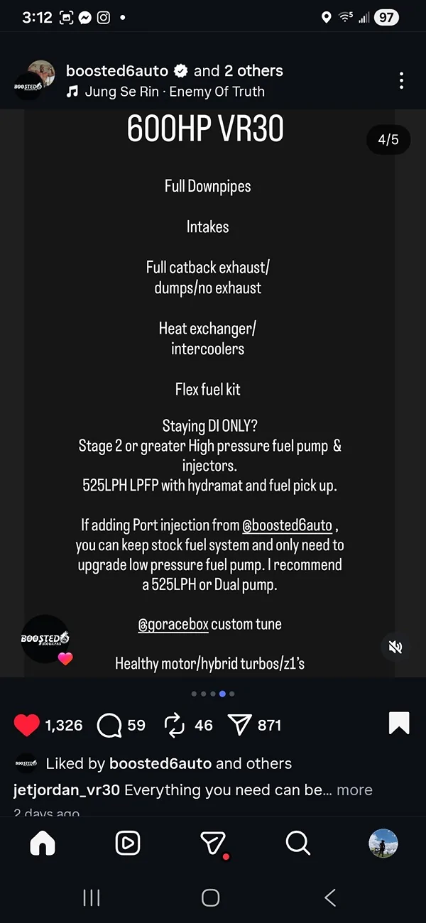

Full down pipes?
So does this squash the theory that FDP could cause over boost?

Based on his pictures. It makes it sound like FDPs are safe when all that's rumored is turbo over speed even from just lowers.
If you are talking about the 500, 600 & 700HP packages those all have tuning.

Full down.pipes should be used only when upgrading to bigger turbos my friends. When going above 500HP for bigger gains up too 700+ along with FBOs, Expert Tuning, Stage 2-4 Injectors, HPFP LPFP, Fuel system upgrades and Flex fuel if you dont go Port Injectiom route. Direct Injection requires into 700 ish beyond that PI will take it to the promise land of mo powah!

It's definitely capable of much much more. The turbos are tiny and sized for low-mid rpm torque and quick response, remember this motor first came in q50/60's, not a sportscar. Nissan could spec bigger more top-end focused turbos tomorrow if they wanted and make gobs more power.
