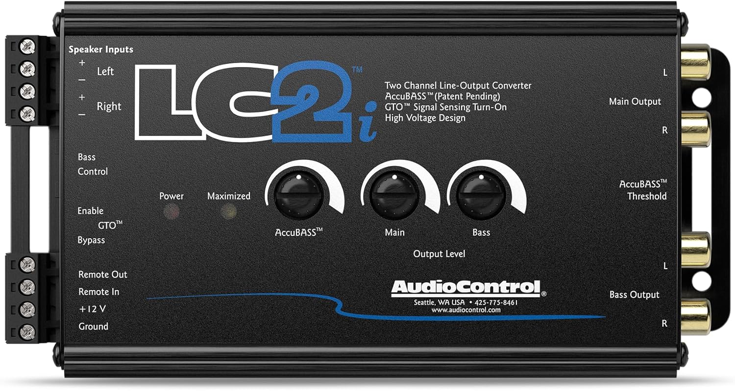

Line Output Converter (LOC)
I started with the LOC. First, I tapped into the factory Bose speaker input (this signal is modified by the factory amp). If you want a cleaner, unmodified signal, you can tap into the speaker wires directly from the head unit before they reach the Bose amp. That said, I’m happy with my current sound and don’t plan to change it.

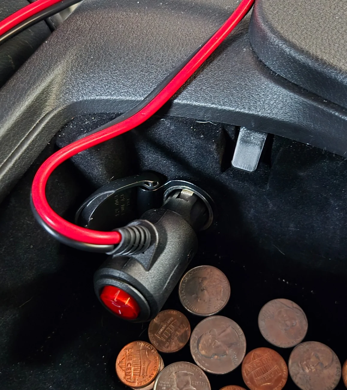

For power, I used a 12V cigarette lighter fused adapter. There are several ways to power your LOC:
  • Use signal sensing (some LOCs can turn on automatically when audio is detected.) Allowing you to tap into the amplifier’s power and ground.
  • Use an “Add-a-Circuit” fuse tap (research required) https://amzn.to/4suIfdi
I chose the cigarette lighter option so I can easily disable the system. If the car is being serviced or valet parked, I can simply unplug it and prevent anyone from accidentally cranking the system. Love it or hate it, this was my own idea, and I thought it was cool.

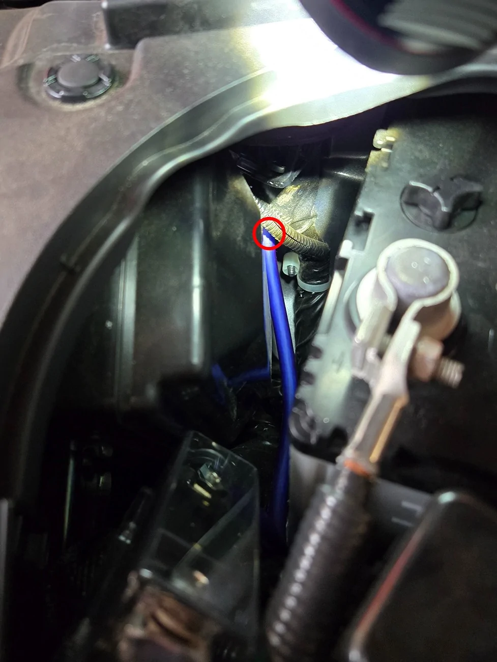

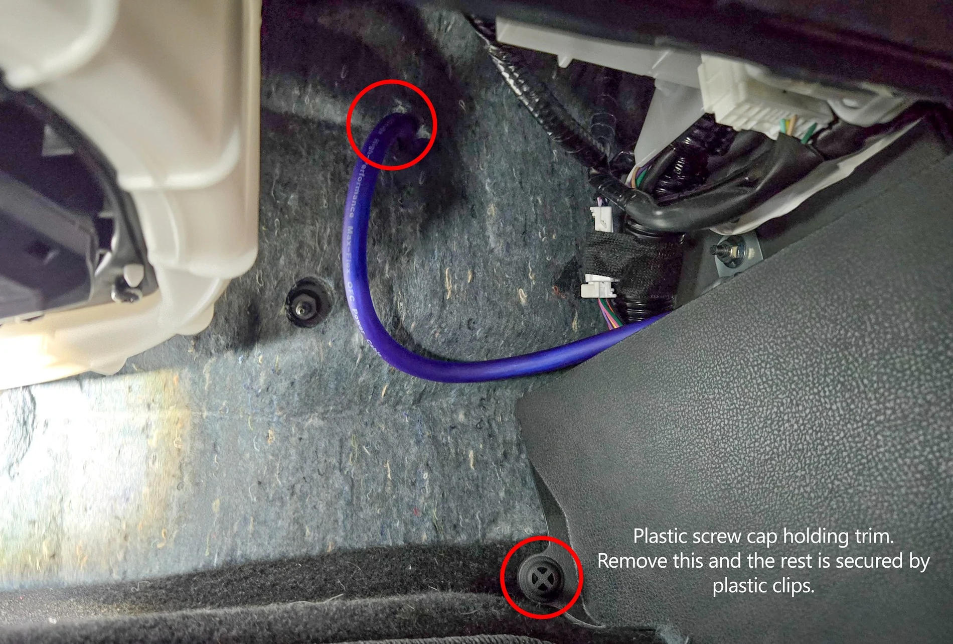

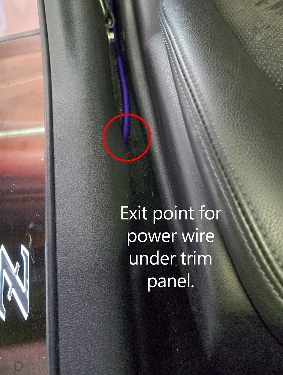

Power Wire & Firewall Entry
Next, I ran the 4-gauge power wire and ground.
I found what I consider the perfect firewall entry point in another forum thread. It’s located just behind the battery and routes into the passenger-side footwell above the carpet. It’s difficult to photograph, but it’s ideal. So much so that the grommet from my wiring kit fit perfectly in the hole after removing the factory rubber plug. Once your power cable is in the cabin, pop the kick plate and side panel off and route your wire under it. There is one threaded plastic screw you’ll need to remove, and the rest of the panels are held on by clips… just pull up and away from the floor.

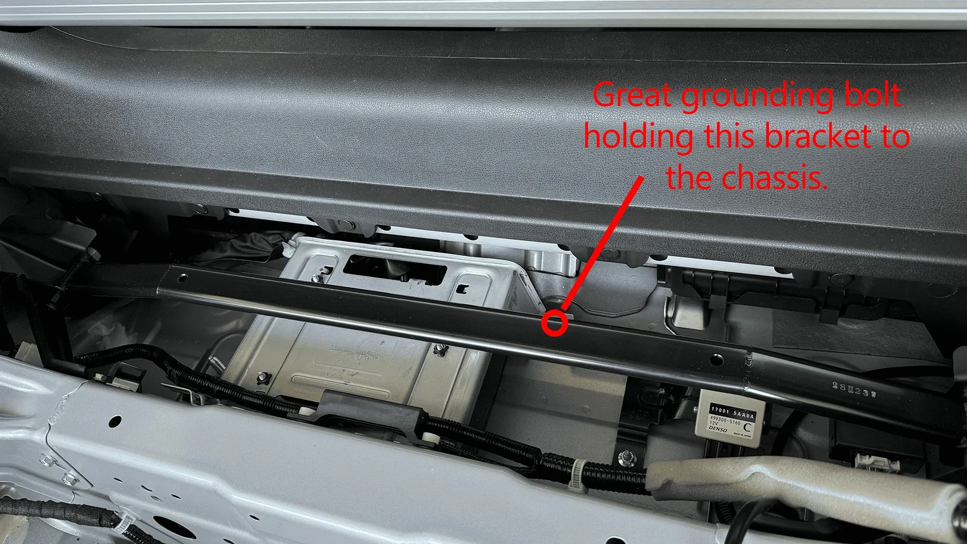

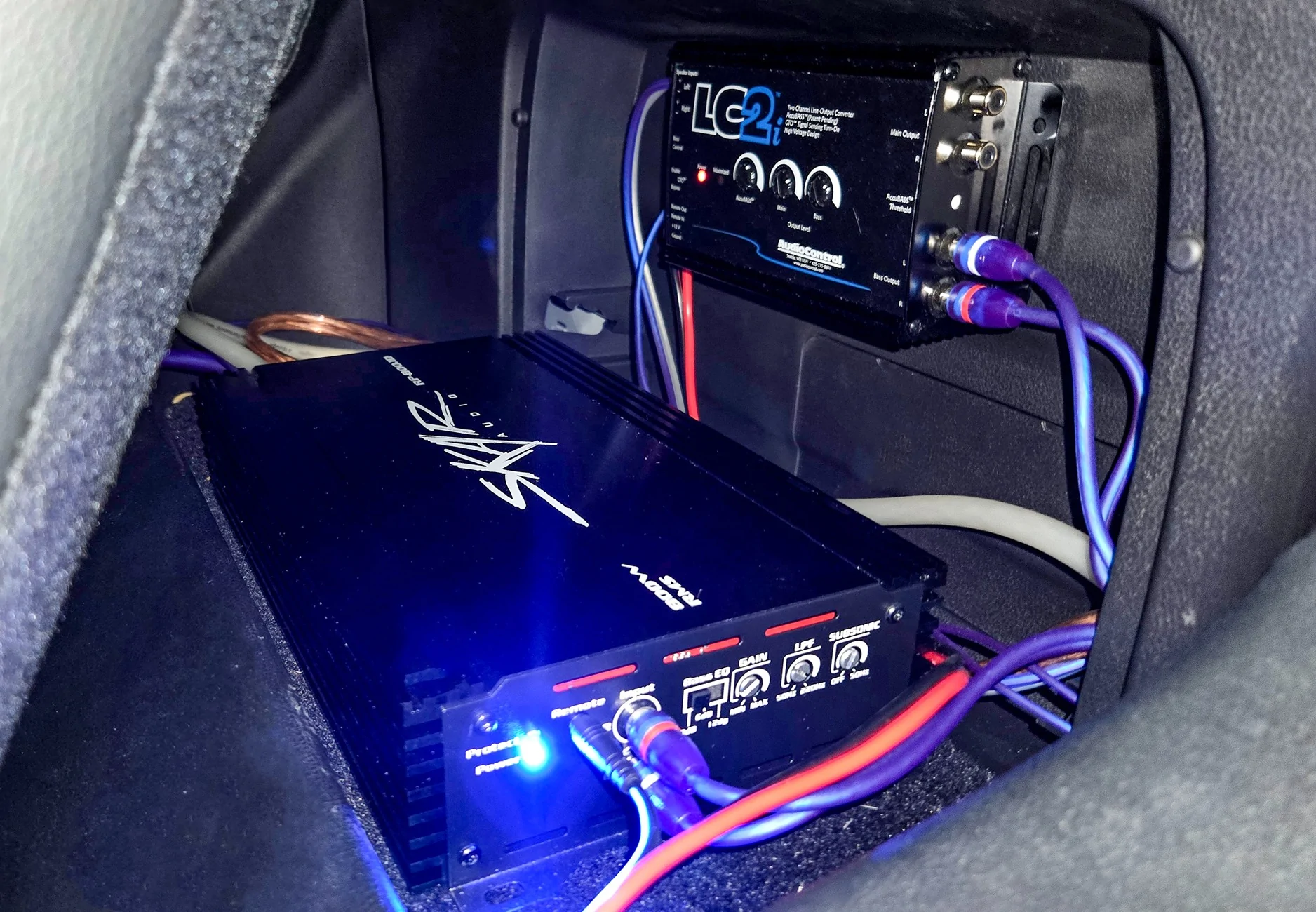

Grounding & Amplifier Placement

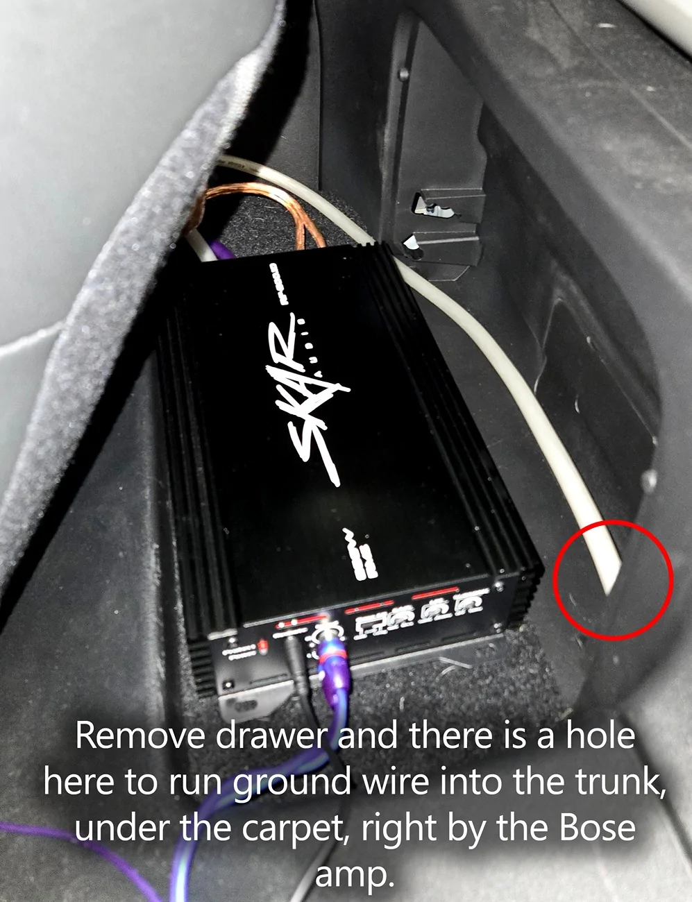

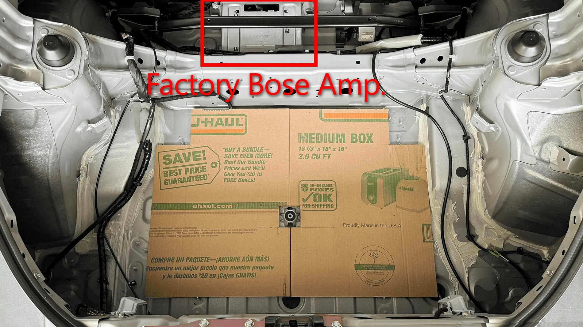

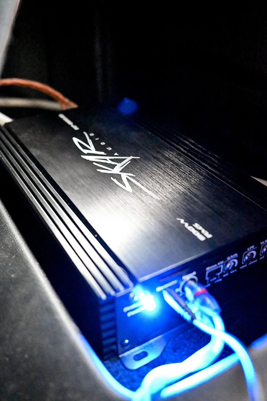

I positioned my amplifier on the shelf behind the passenger seat. Removing the fold-out drawer provided easy access to the trunk area under the carpet, where there are multiple grounding points.
I chose a bolt securing the factory Bose amplifier bracket to the body, as a voltmeter confirmed a solid 0-ohm ground.

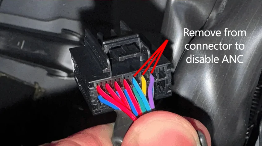

Before finalizing the ground, I removed the amp to disable ANC.

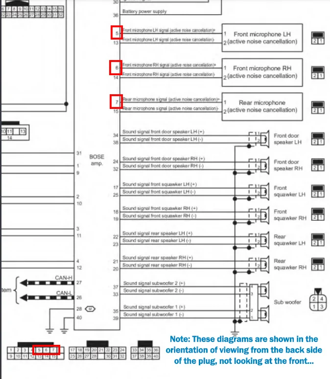

From my research, Performance and NISMO trims with the Bose system have ANC enabled. One way to disable it is by unplugging the microphones used in the system. This breaks the circuit and turns ANC off.
Why this matters:
ANC will interpret your subwoofer’s low frequencies as “noise” and attempt to cancel them out by sending opposing sound waves through the speakers. This can cause:
  • Buzzing
  • Pulsing bass
  • Reduced overall bass output
Unbolt the amplifier bracket from the body. Wiggle it out enough that you can reach the plug closest to the driver’s side. This is the plug that contains the wires for the ANC microphones. Remove the plug from the amplifier to access the wires for removal.
Wires 5,6,7 ( blue, yellow and violet) are the positive leads of the microphones. Remove them from the plug and tape them off with electrical tape. This process manually disables the microphones, disabling ANC.

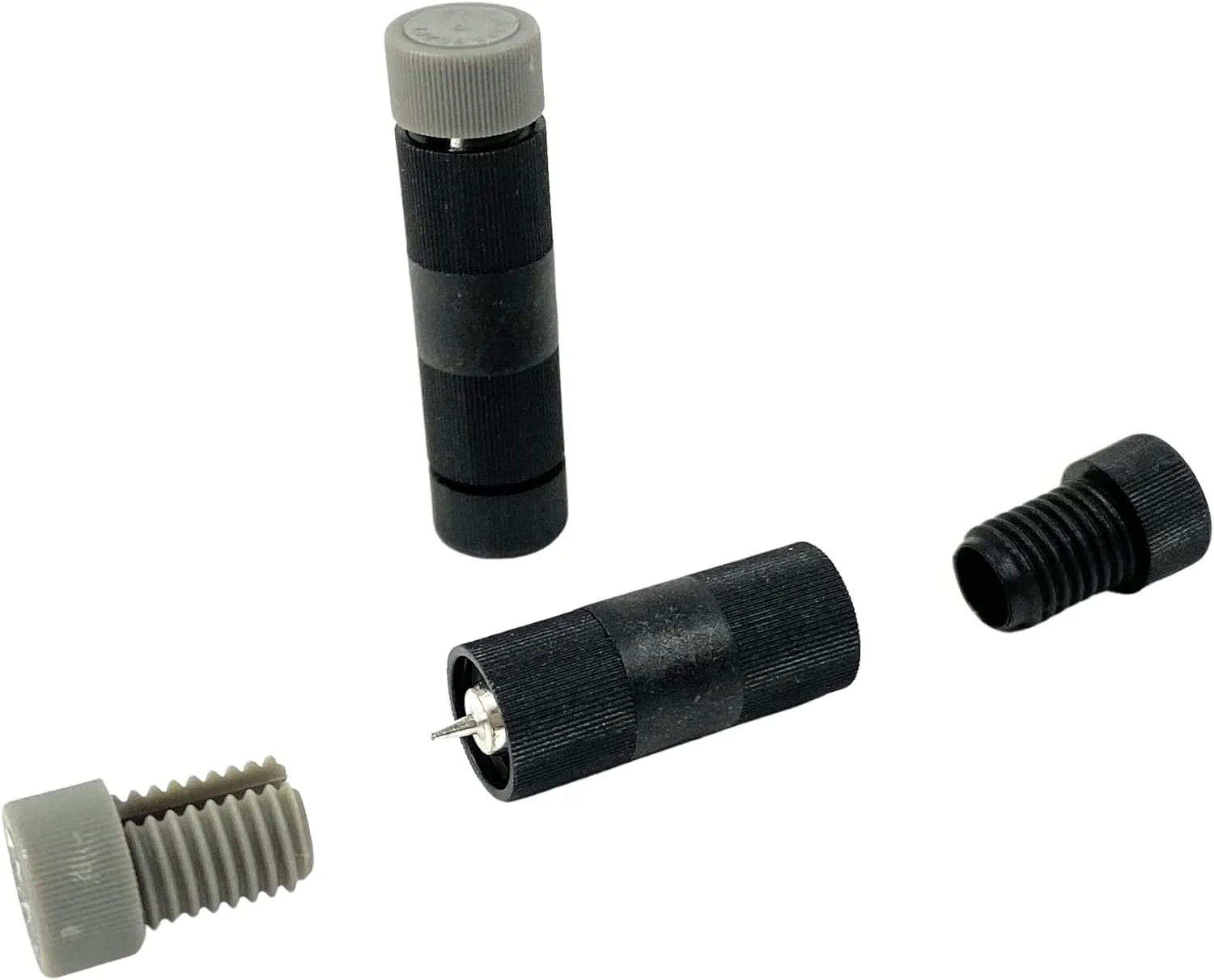

The pin removal is a delicate process. Be patient. Here is a video that helped me understand the plug styles and functionality to learn how to remove the pins properly:

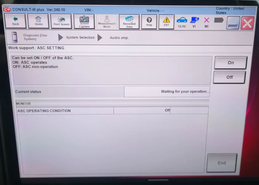

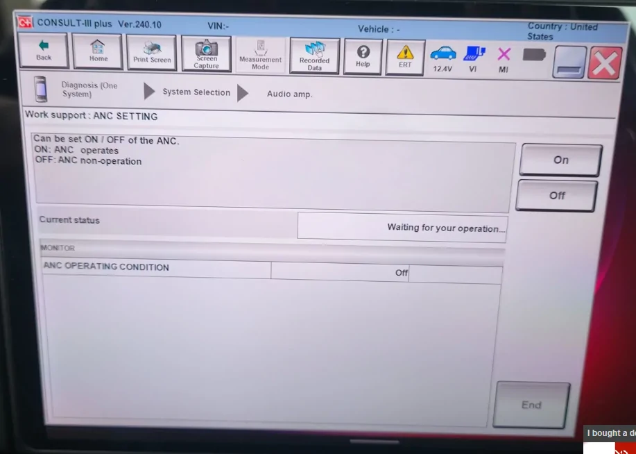

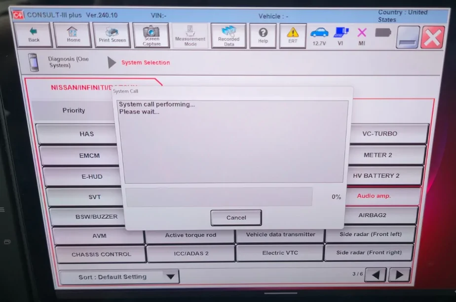

If you go this route, I strongly recommend also disabling ASE (Active Sound Enhancement). ASE plays artificial engine noise through the speakers when in Sport mode—and you definitely don’t want that coming through your new subwoofer. It sounds terrible.
Dealerships can disable both ANC and ASE using their Consult III system. Take these screenshots with you and it may help them understand. These screenshots show where to go in the program to toggle off ANC and ASE/ASC.
Another option is to disable it yourself using an OBD connector and compatible software (see supporting forum threads for details).

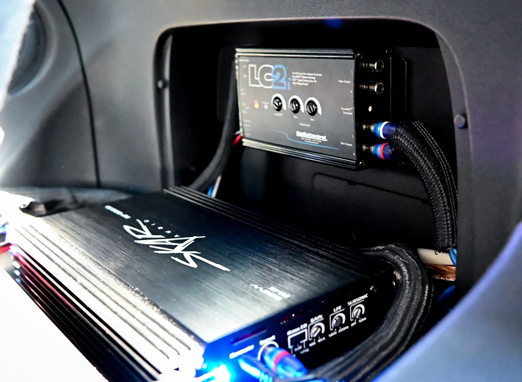

Amplifier placement and cable routing are completely up to you—get creative and enjoy the process. I haven’t fully cleaned up my wiring yet because I wanted to test everything for a few weeks first.

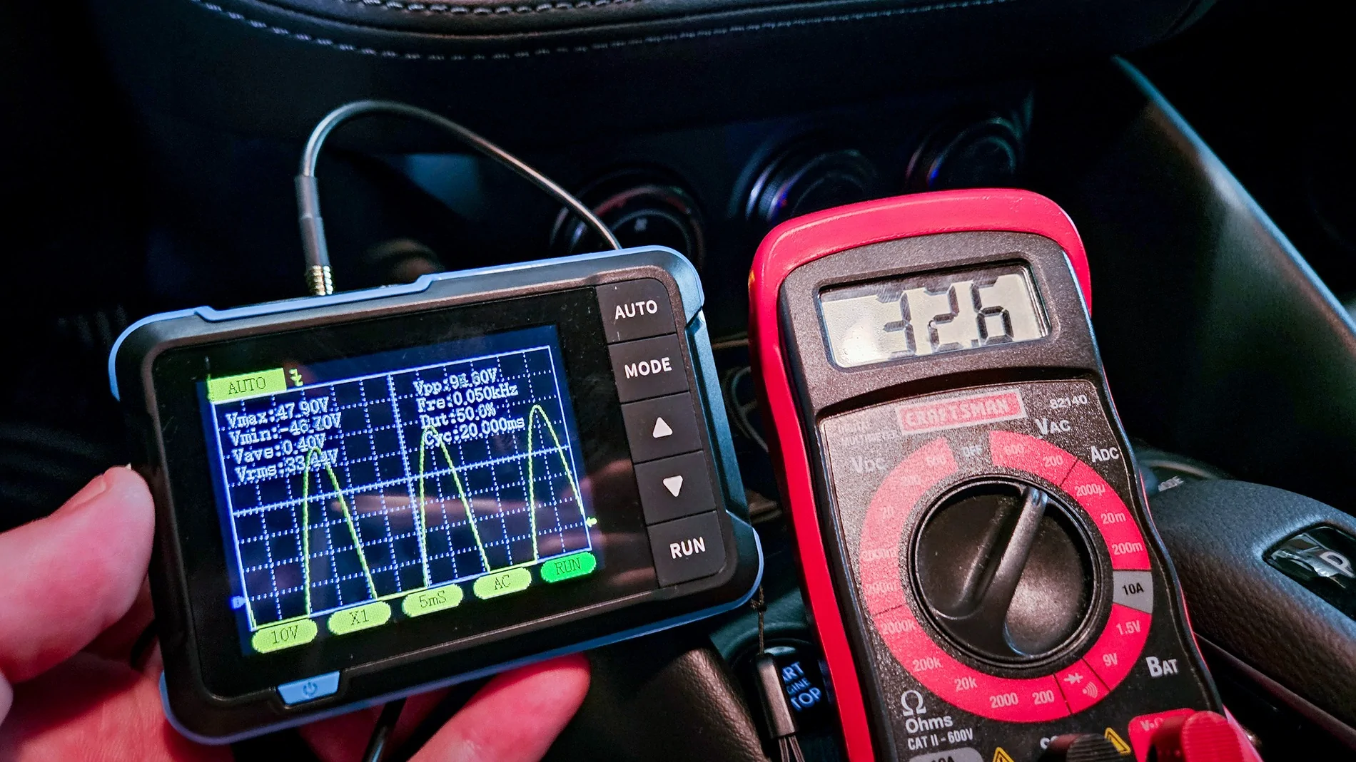

I used AI to help figure out the proper gain settings and ways to test for clipping. Amazon has a great cheap O-scope you can pick up: https://amzn.to/427G57D

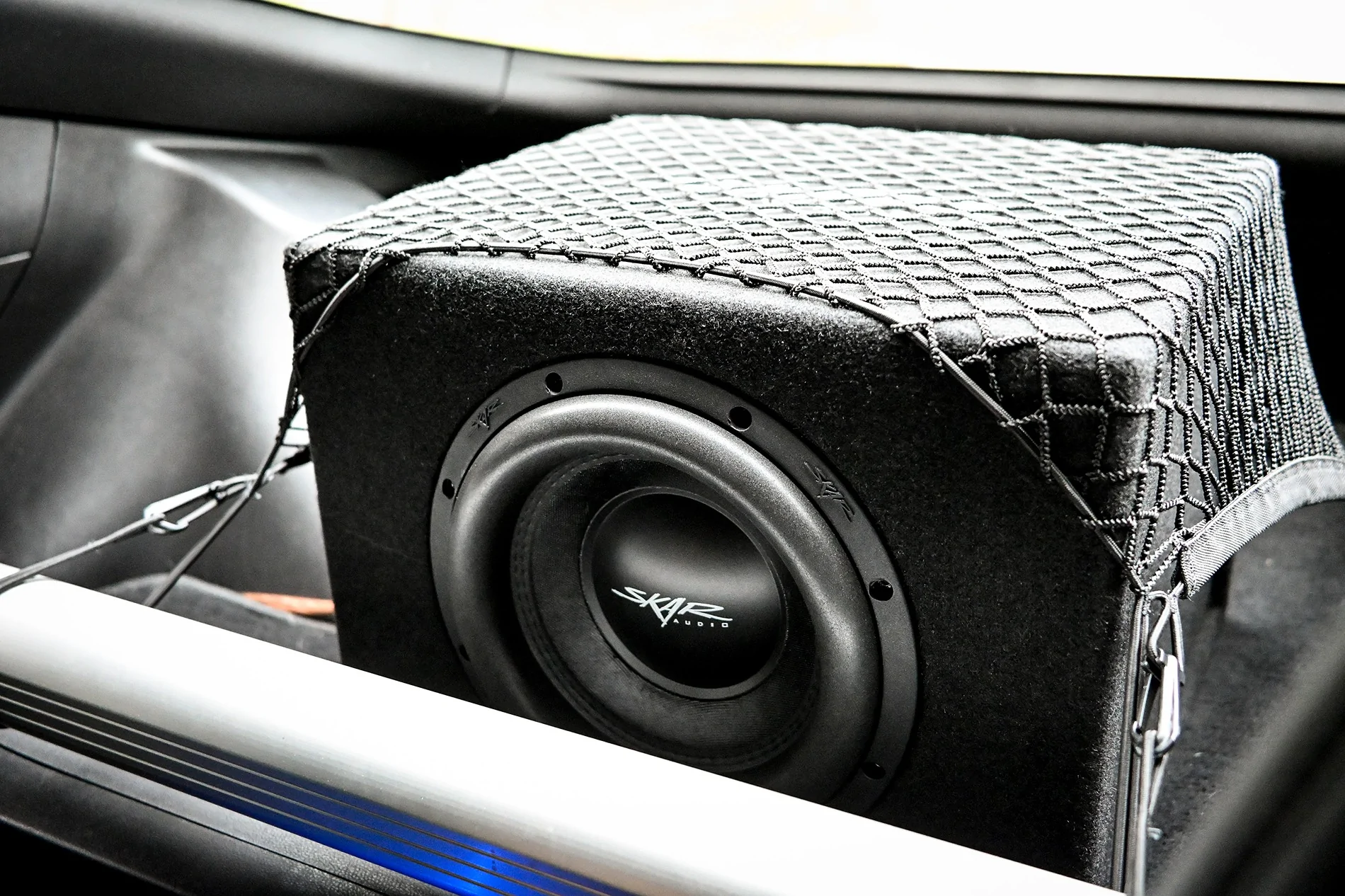

DD Audio SL612-Its a slimline 12inch
DDAudio D1100
I used a similar box design as Mr. Mac

A sound wave decays/loses amplitude from the moment it leaves the speaker. Reflecting off a surface such as glass will not increase it.

Facing the rear can definitely increase dB's for low bass frequencies. It has something to do with the length of the sound waves in those tones. I think they call it cabin gain. If you can get the right position of the speaker to the rear surface it can reflect forward and combine with the next wave coming off the sub. It sounds counter intuitive, but it can work for sure.
I've faced mine all directions and I think I like the sound the best blasting straight into the back of my head 😂

I will say, this car is solid. I'm getting basically no trunk rattle from the outside. And the only in cabin rattle I'm getting is from the plastic cover on the stuff behind the rearview mirror, and I think it'll be an easy fix.
