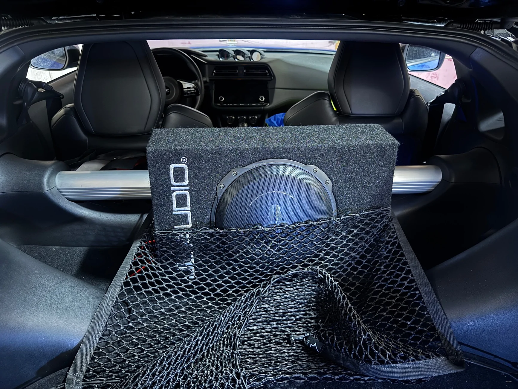

Ok so I got the install done. Longest part was getting to the Bose amp in the back.
I grabbed the signal going into the amp but ASE is definitely still on.. I’m kind of confused. I guess I’ll see if the dealer can turn it off.
This is the post I looked at to figure out what wires I need to use. It said it would be the clean signal but I guess not..
https://www.nissanzclub.com/forum/threads/factory-audio-system-questions.2432/post-73282
I decided to pull the pins for ANC. That was the most annoying part. I think I partially broke one.. I honestly couldn’t figure out what locking mechanism was in the connector. But it’s all fixable.

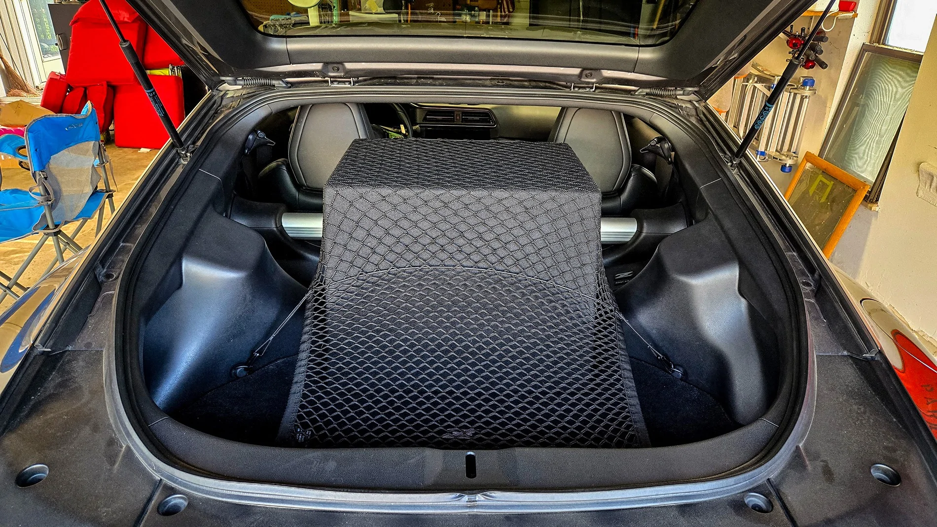

My sub sits inside my trunk in my cargo net. Actually keeps it in place. I may move it later but it works for now.
Thanks again for your help. This really wasn’t a hard install at all. And if I hadn’t started so late, I would’ve spent more time to be patient with the ANC pins. Anyone who thinks they can do it definitely can.

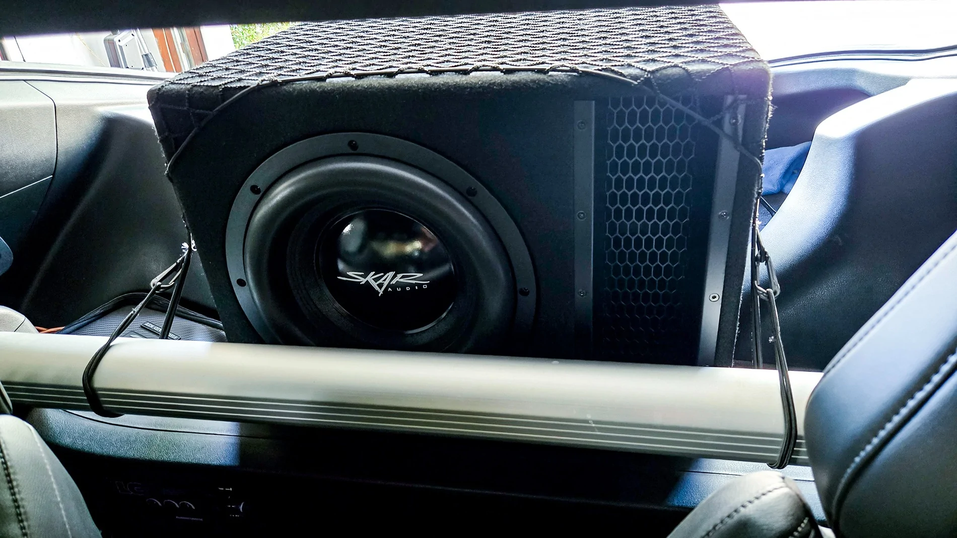

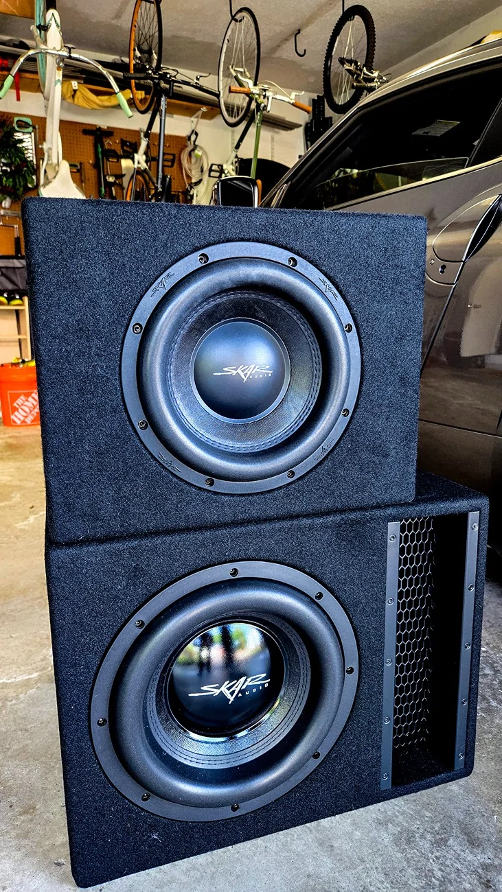

Not that anyone was curious... :crackup: but the Skar EVL 12 loaded enclosure does fit in the trunk. I'm running this now with the Skar 1500.1 amp. LOTS of bass 🔊
