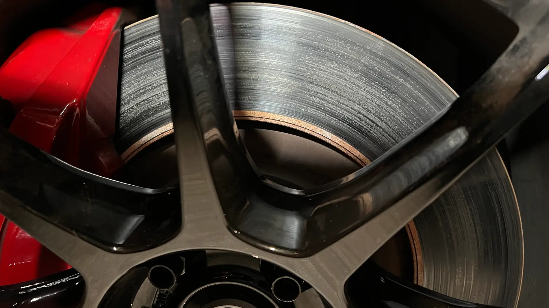

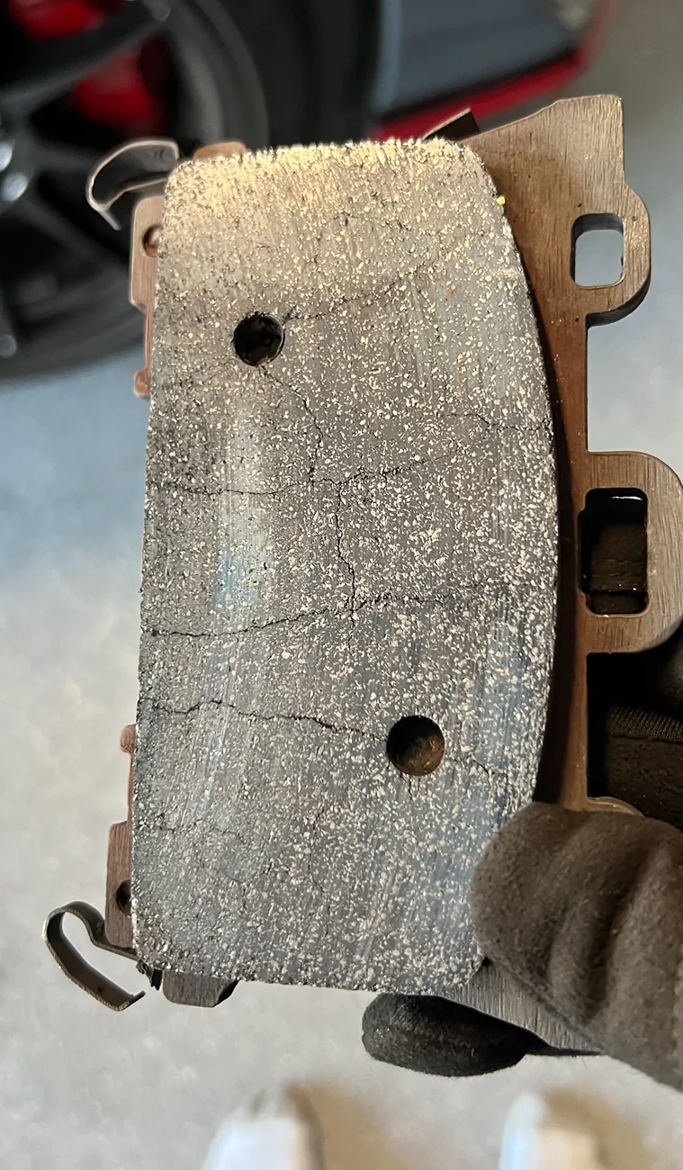

3rd day I added SPL camber arms, more aggressive alignment and added 100 TW tires (F1 3R) on 18x10.5 setup. I used different tuner and the power was much more consistent with no missed shifts by the trans. I did only use 4,5,6 gears which seemed to help. On high speed trail braking the car got super twitchy so had to back off a bit in those spots. Completely cooked the Carbotech XP24 pads with SRF Castrol (multiple cracks and glazed spots) and was getting some other knocking/vibrations unable to diagnose. When everything was working well I was much more impressed with the car and can see the potential. Still not as fast as my previous Supra or RS3 though.
Any advice or parts or driving style are welcome, especially about how to keep the brakes cooler, maybe ducts or different rotors.

I'm sure you'll gain some braking performance with better rotors. Nismo have changed the rotors for the 2026/27 spec Nismo, so surely they know those rotors weren't ideal for lap after lap track abuse. There is a ducting system on our Nismos. There is this air passage under the front splitter that guides air flow to the brakes. That's assisted with a metal plate to divert the air to the brakes, similar to what is on the Darkhorse, It's not ideal, but better than nothing.

That is impressive cooking a full race pad!

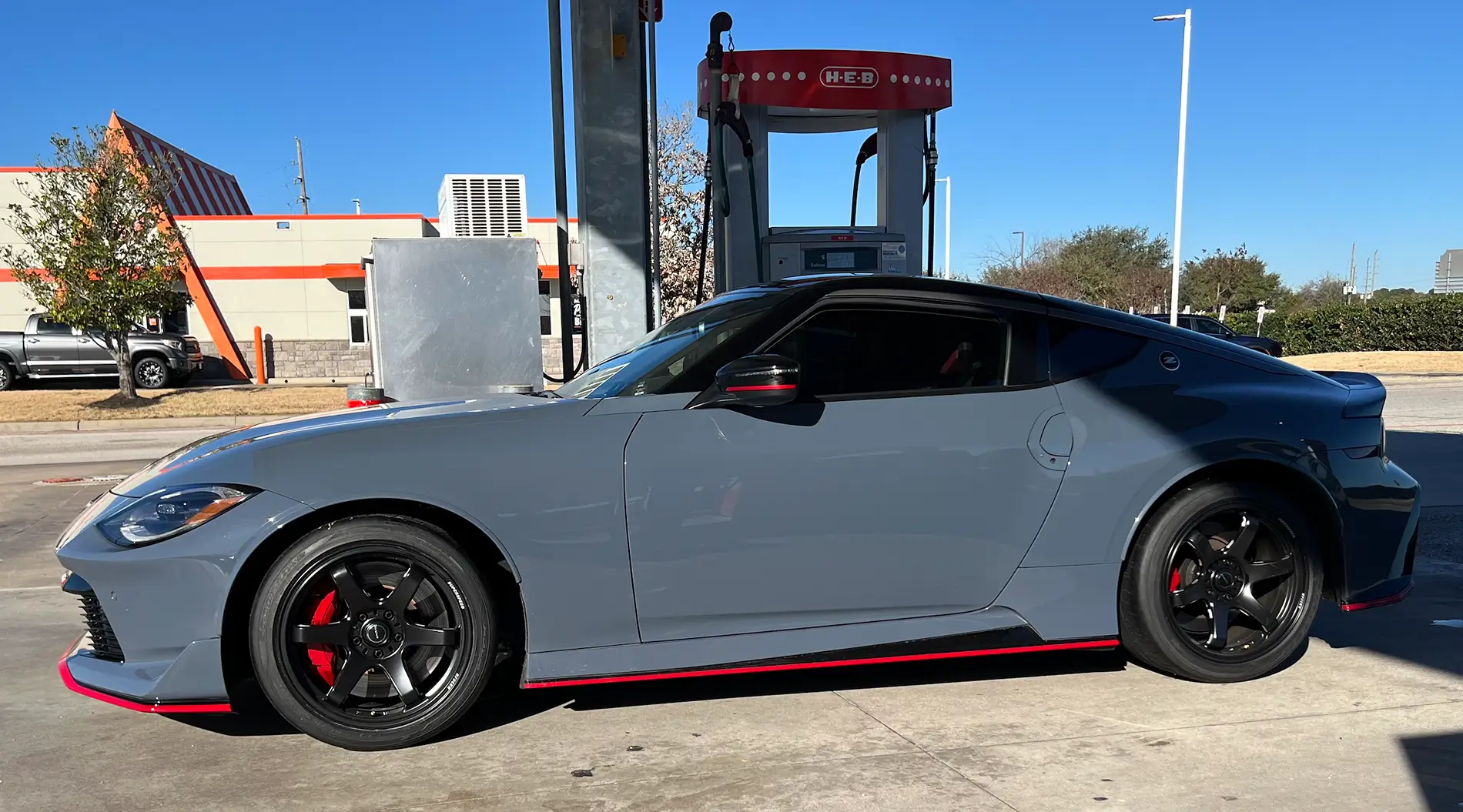

The 18x10.5's cleared the Nismo brakes fine? What wheels/offset were they?

I do have some slight knocking noise at full lock only when going ~40 mph, not sure if it's wheels or camber arms or something else so I can't say 100% they fit but other people are using them as well. Using -3.5 camber with SPL arms.
Superspeed RF06RR 18x10.5 +22 with hub centric rigs.

Looks extreme on those heat cracked XP24 pads! I've used XP12/XP10 combo on other track cars before and have held up great. Castrol SRF should be fade-free at least. Are our Zs, even Nismos, really that deficient on stopping power for just a full day's tracking? Worrying...

https://ctbrakes.com/choosingcompounds/
Carbotech website says the XP24 is their highest rated racing pad, so it seems you've already done all you can there
The limiter has to be airflow.
Titanium shims, 2 piece rotors with good venting, and directed ducting have to be the next step

The Z is fast but heavy and wallows. I experienced ice mod and brake failure. I am still a fan of the Z and want it to be on the track more. Just really really spend your first money on brake upgrades.

Do you have suggested specific brake mods? I’m thinking of the Paragon 2 piece rotors, pads TBD (waiting on carbotech response) and some type of cooling kit. There's a few for sale but I don't see many people actually using them.
