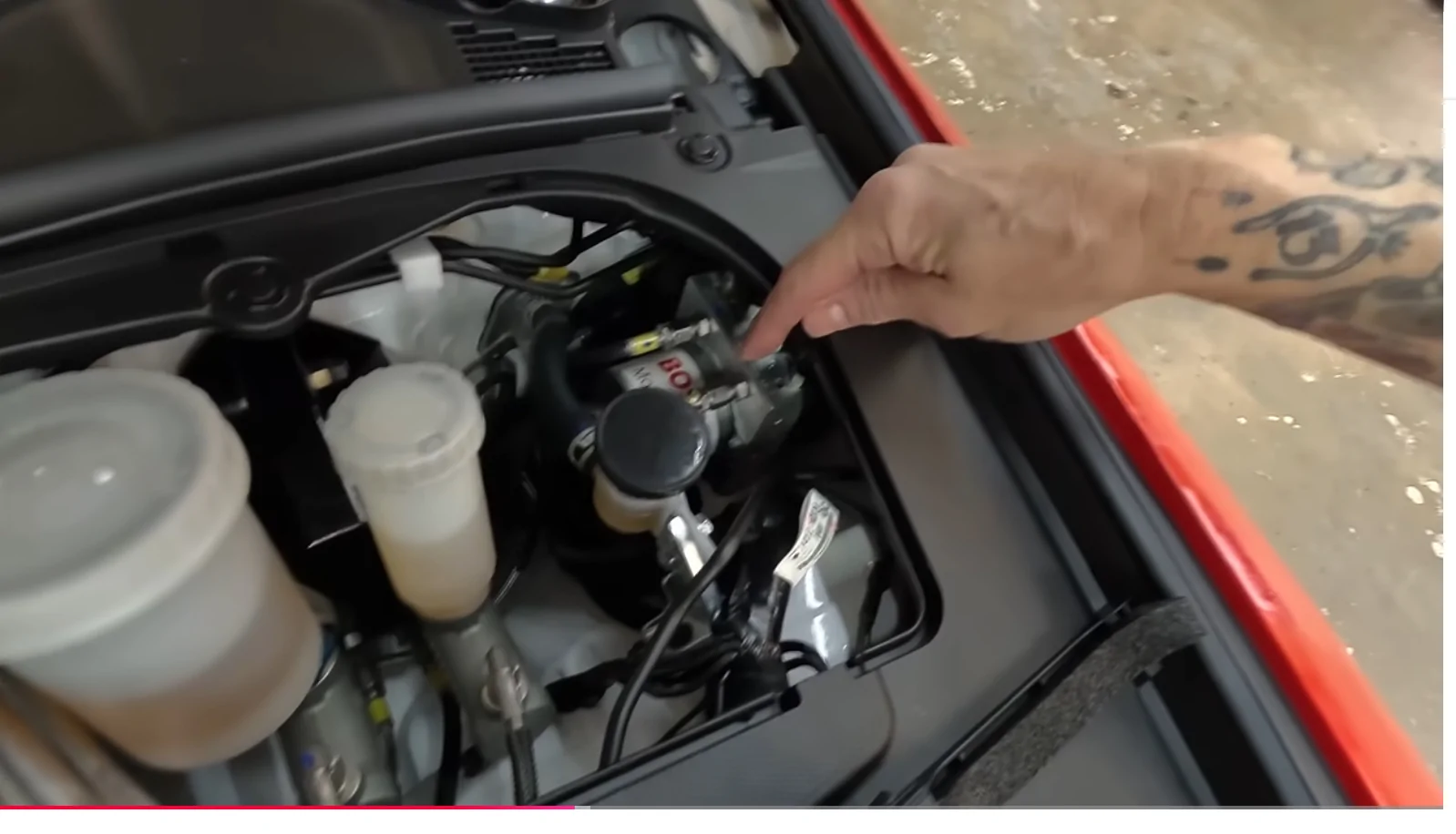

only took a decade and a half for Nissan to do anything about the slave cylinder and brake ducting (although not enough apparently)
here’s Forsberg and Chen pointing at the Bosch unit in the GT4 car
Video:
What’s look like in the street car?
