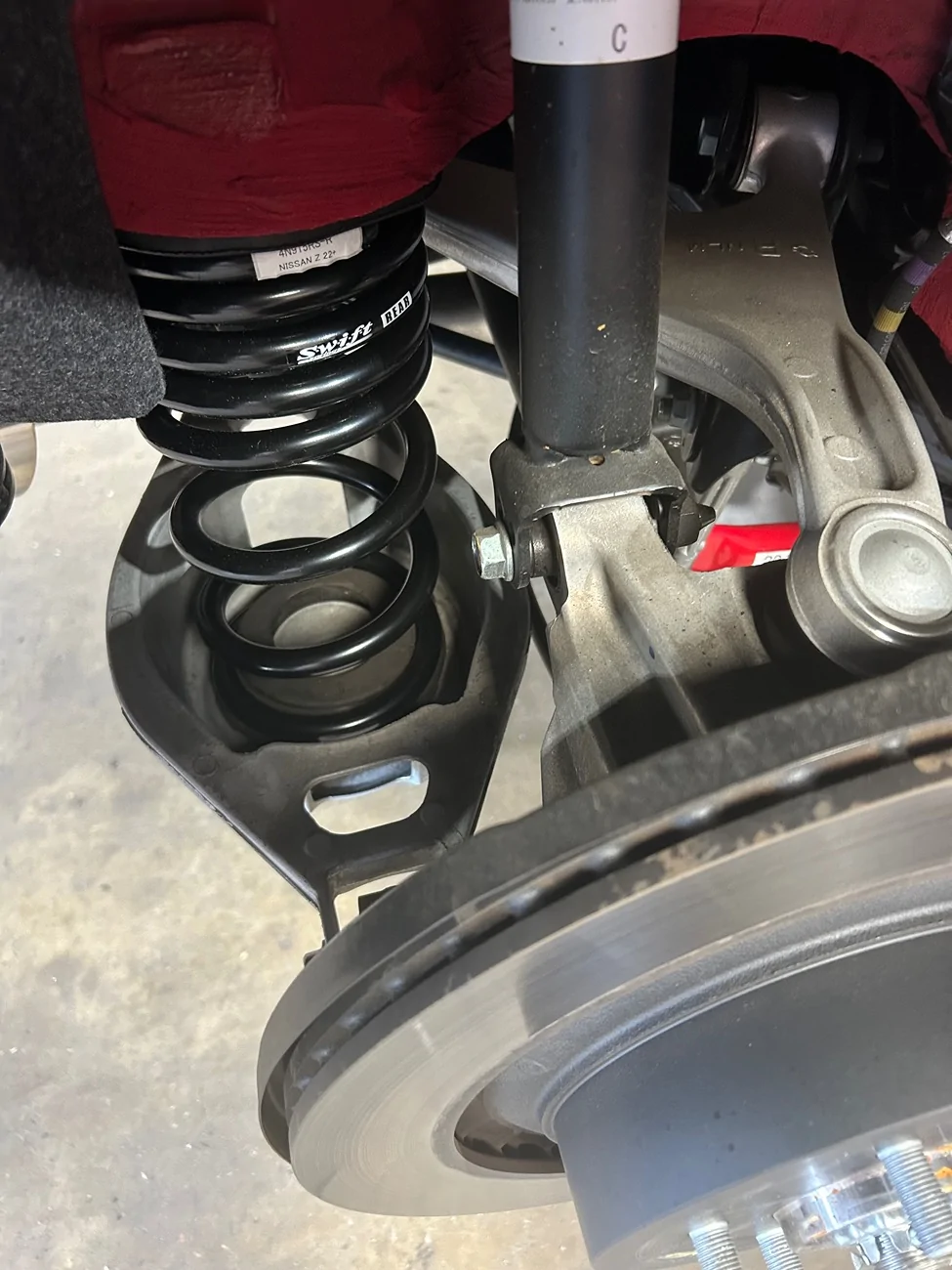

Yep I can tell you a huge difference, night and day, on street driving just with adj sways and slightly stiffer lowering progressive springs, the Z is buttoned down now, no more swaying, should be this way from the factory.
I think you just solidified my decision to get the springs.
I kinda didn’t wanna lower it just because it’s my daily and it already scrapes…but i do want a little better handling and predictability

Yeah you should be fine, these only lower about 1.1ā€ and no bottoming out, progressive is the key for most street driving, cuts down on bounciness and harshness. And the stock shocks work fine, per Swift, since rates aren’t too drastic. You can compare other brands and rates too.
Do watch out for driveways and speed bumps tho!

I am considering Swift and RS-R Down Sus (the smallest drop I can find). Did you consider RS-R? What made you choose Swift ?

I chose Swift because of their history and approach, roll stiffness is handled by sways and springs handle compression, supple to firm as travel goes deeper. Had Swifts on my 240Z before, don't seem to lose on the small bump sensitivity but does stiffen up as it compresses. RSR and Eibachs are also good but you need to check their kg/in rates for your use. If only for full track where most surfaces are smooth I'd still go straight wound springs, stiffer the better.

Interesting. My research hasn’t gone that deep yet- mainly because I was on fence anbout springs and also b/c the potential upgrade is still nearly a year away.
I have progressive eibachs on my Z32 and I like them. I FINALLY got it re-registered and I’ve been driving it all week. And boy is it making me really wanna mod/uodgrade the RZ34.
I def want progressive b/c it’s my daily and I don’t track.
Are all 3 you mentioned (Swift, RS-R, and Eibach) progressive spring rates for the RZ34? Need to research more…
