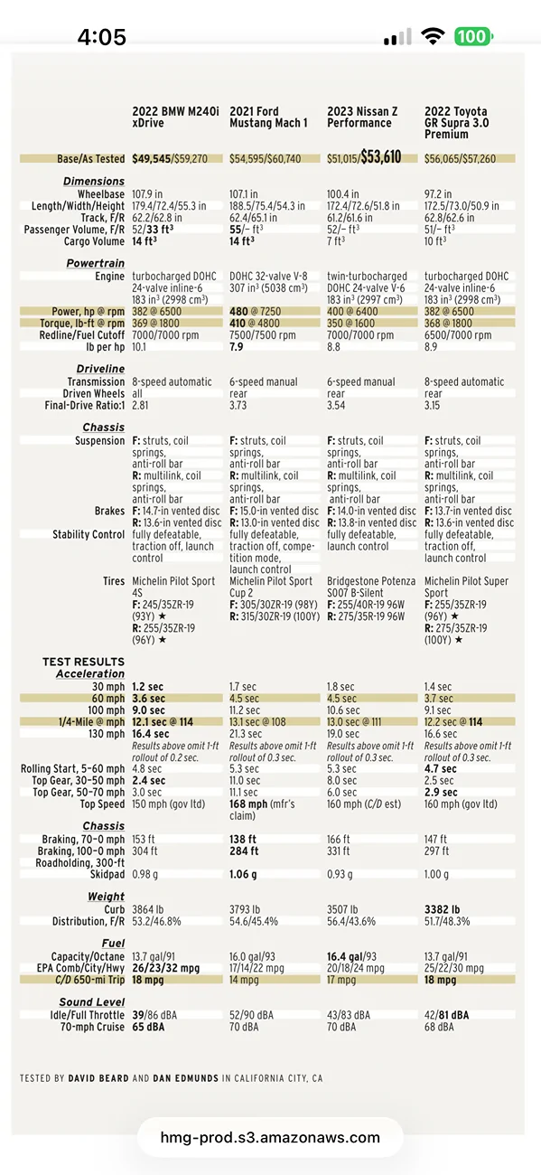

Check this out. This is C&D test in California. Now the BMW cars are automatics so it’s not apples to apples but they do well on 91 octane nonetheless. But look at the Z Performance manual time and the 480hp Mustang manual on 91.

Yeah, but the nismo manual trapping 108? And that number not being an outlier in the data? I really hope they filled it with 87 and ran it on a 105f day.
