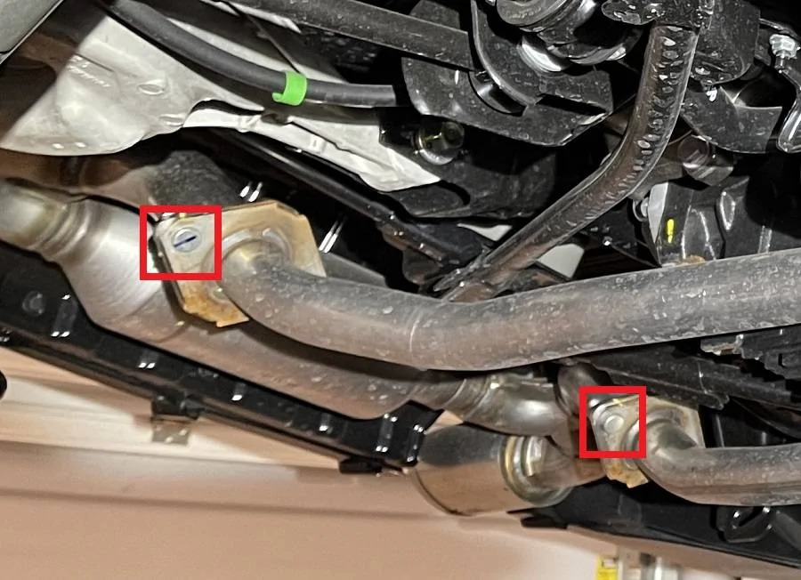

I just did an exhaust swap and removed these from my Nismo exhaust with a 1/2 inch wratchet and socket with no issues at all. Maybe try an extendable ratchet for leverage?

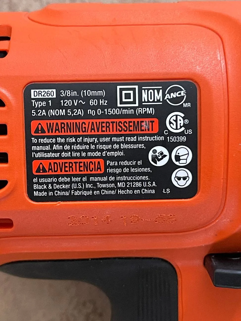

Depending on what type and size impact "drill" you are using. Some are really weak. Get a long wrench or a breaker bar and put some muscle on it to crack it loose. Then you can run it off with the power tool.

You definitely don’t need a power drill for any part of this install except to maybe run the bolts up onto the screw quicker. PB blaster might help but you shouldn’t even need that.

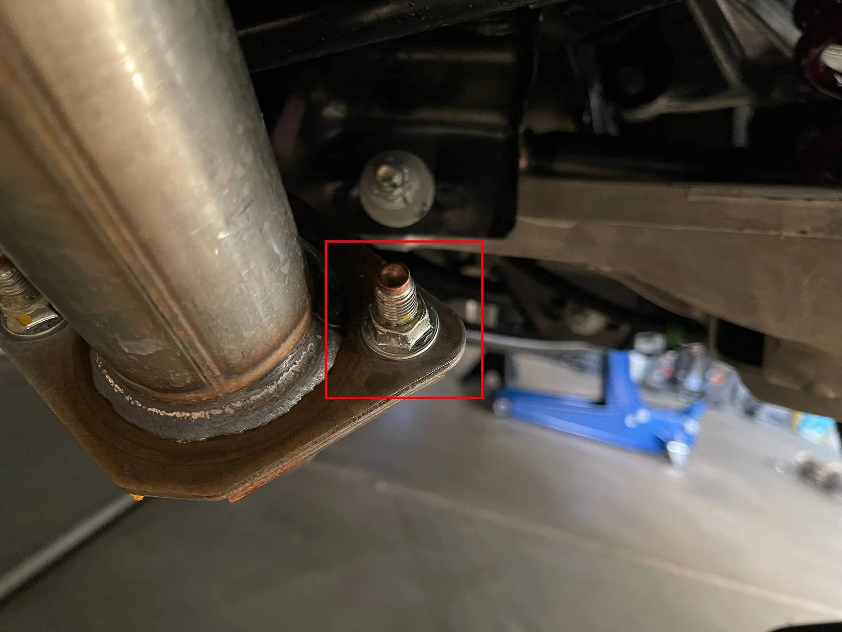

Every video Ive watched folks have caught hell with the bolt tightness. They've always used a cheater pipe or breaker bar. It sounds like they break the bolt every time one lets loose but they're just that tight.

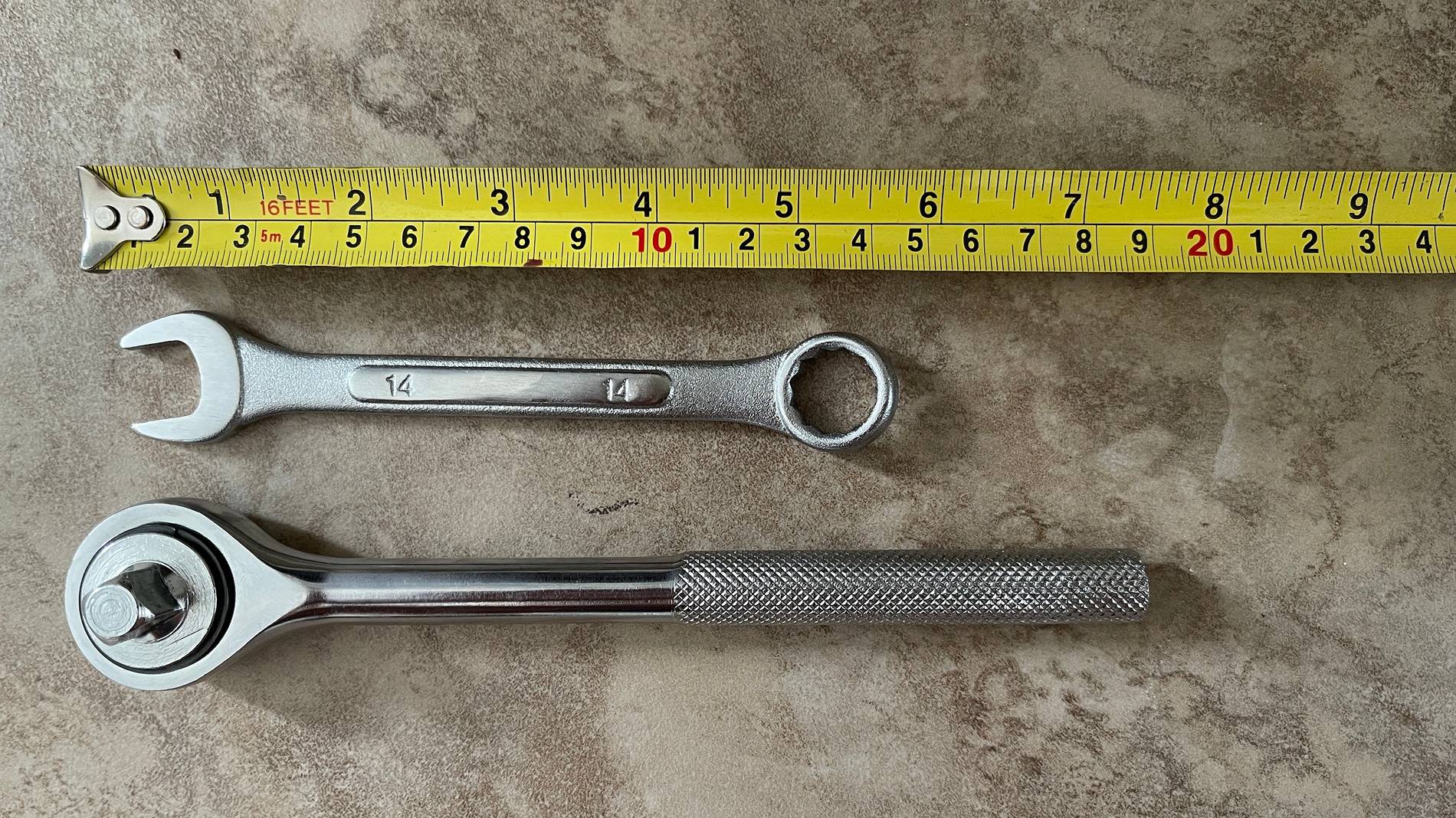

my breaker bar was too big and no room for a my cordless impact wrench (pistol style). you need a low profile right angle impact wrench, ratchet with a cheater pipe, or standard box wrench.
i used a box wrench and lightly tapped it with a mallet to break the flange nuts loose. They are not bad to remove. I did use PB blaster on the nuts.
