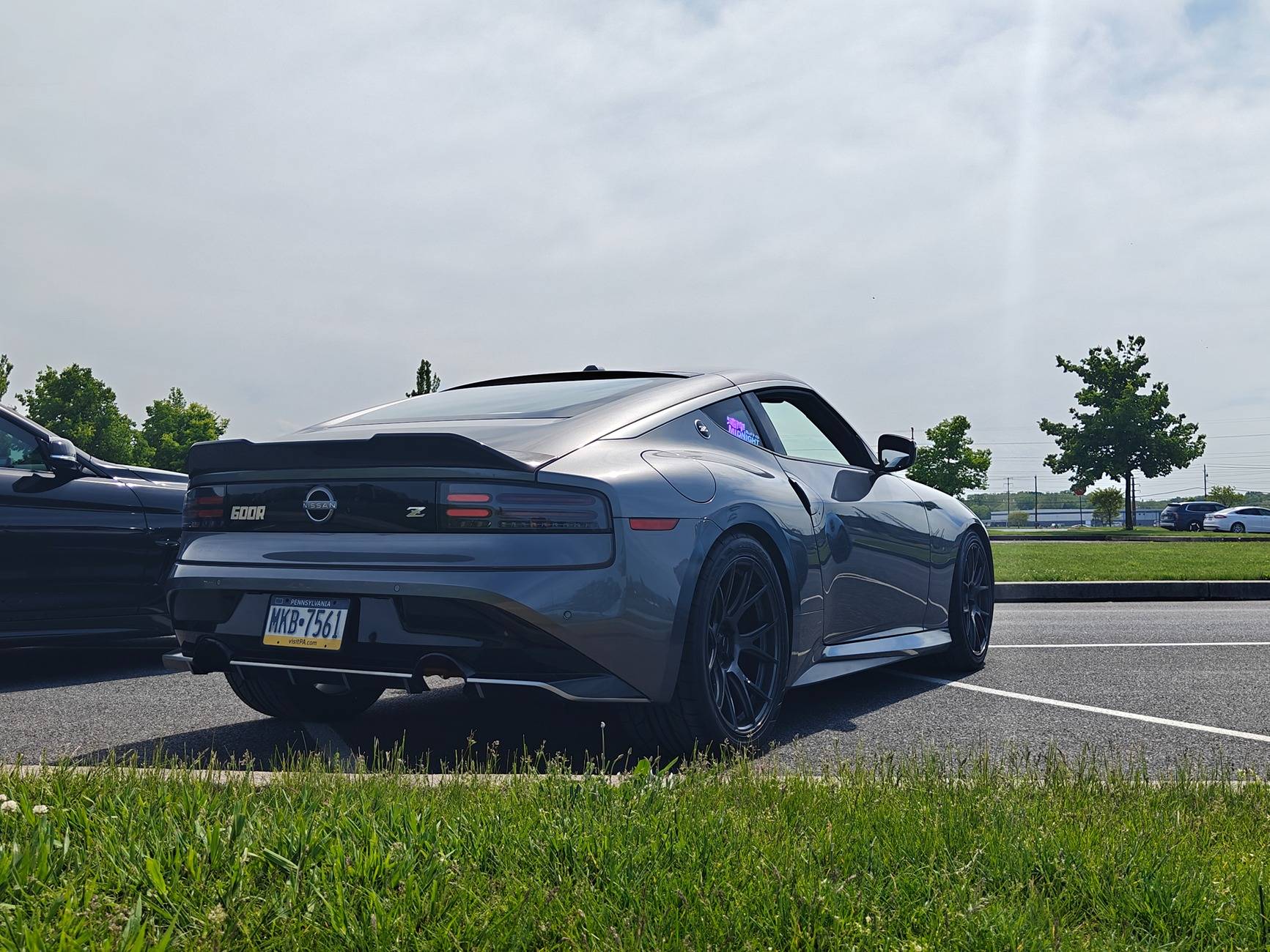

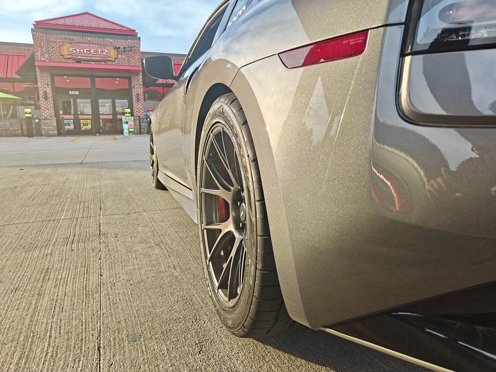

Here is my setup. 305/35R19 on an 10.5” wide wheel...
That looks fantastic! But there's some fishy going on here. If the tire width of the 305s looks the same as the 285s, is it a scam or a gimmick tire you purchased?
Do you have a comparison picture of the 305 and the 285 next to each other? Since, I don't see much of a bulge, I believe the 305 and the 285 got the same width.
I like the last picture! That's a professional photographer right there man.

Thanks! I took those pictures with my new phone lol. I progressively went up in tire size on the rears as I burned through them. I went from 285s, 295s and now the 305s - which I think are perfect.
285s you can see a bit of stretch and the 305s have a bit of bulge? Definitely much wider.

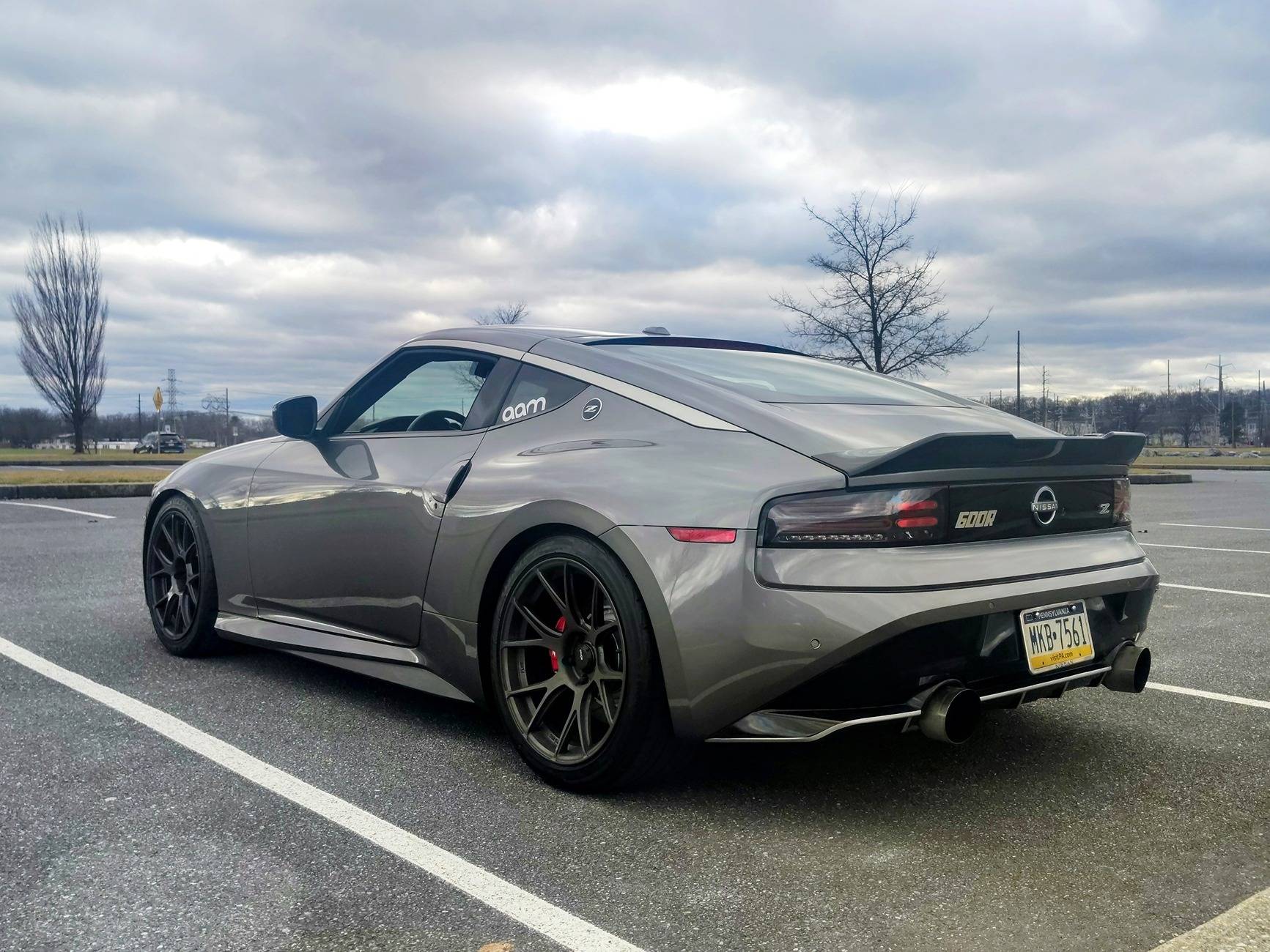

Quick question about the daytime running lights (3rd picture). Do you customize the color of the daytime running lights to light blue?
Where did you get those light blue color daytime running lights?
I saw a new Toyota Supra running around my area with a light purple color daytime running light.

I think that is the cameras doing. In person it looks white. That would be a cool mod though to make it a light blue.
