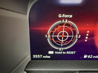

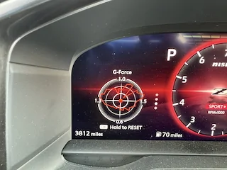

I got 3 national tours (RedHills, Lincoln, Bristol), 3 pro solos (Atlanta, Lincoln, Bristol), and numerous regional events out of them. I counted that I had over 100 runs before they pretty much heat-cycled out for national event use-but they still had tread. They would probably would have been fine for regional events-but I only had one additional set of wheels, and wanted to have new tires so I could try to not embarrass myself (failed).
The RE-71RSs seemed to handle heat pretty well-right up until the last few runs. Oh, and I do have proof of 1.5G lateral on them (two different courses).

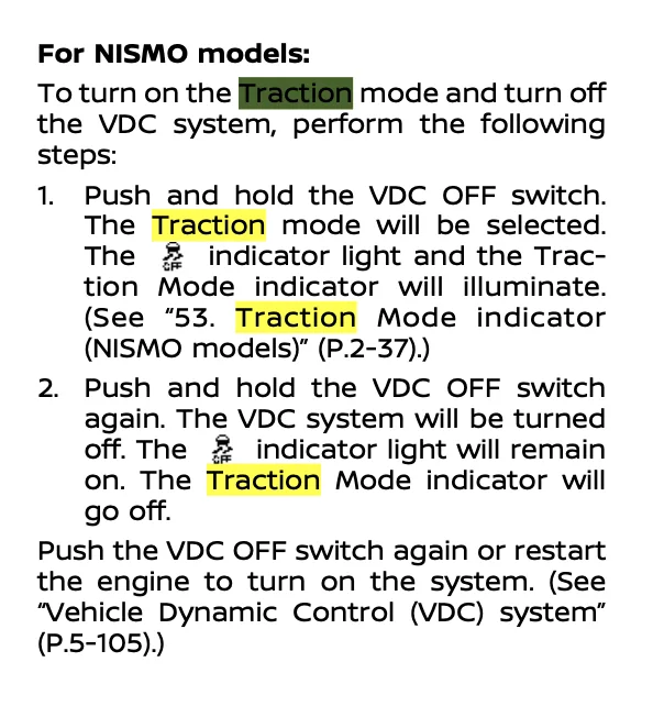

Wow I wish I read this thread last night. Was at CMP today and I finally felt confident to try driving without the Nismo traction mode but turns out I misread the manual and disabled everything. I was pushing it twice... I also didn't realize I still needed to disable the emergency braking because I saw it lit up on the dashboard when I disabled the driver aids. I'm probably an idiot but I feel like they could have worded this a bit more clearly... at the top it says to turn on the traction mode perform the following steps...That made me think you need to follow both steps to get to the traction mode 😬
