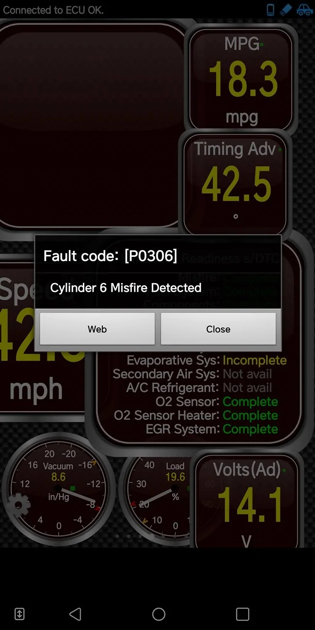

It finally had a solid engine light. A P0306 code, indicating a Misfire on Cylinder 6.

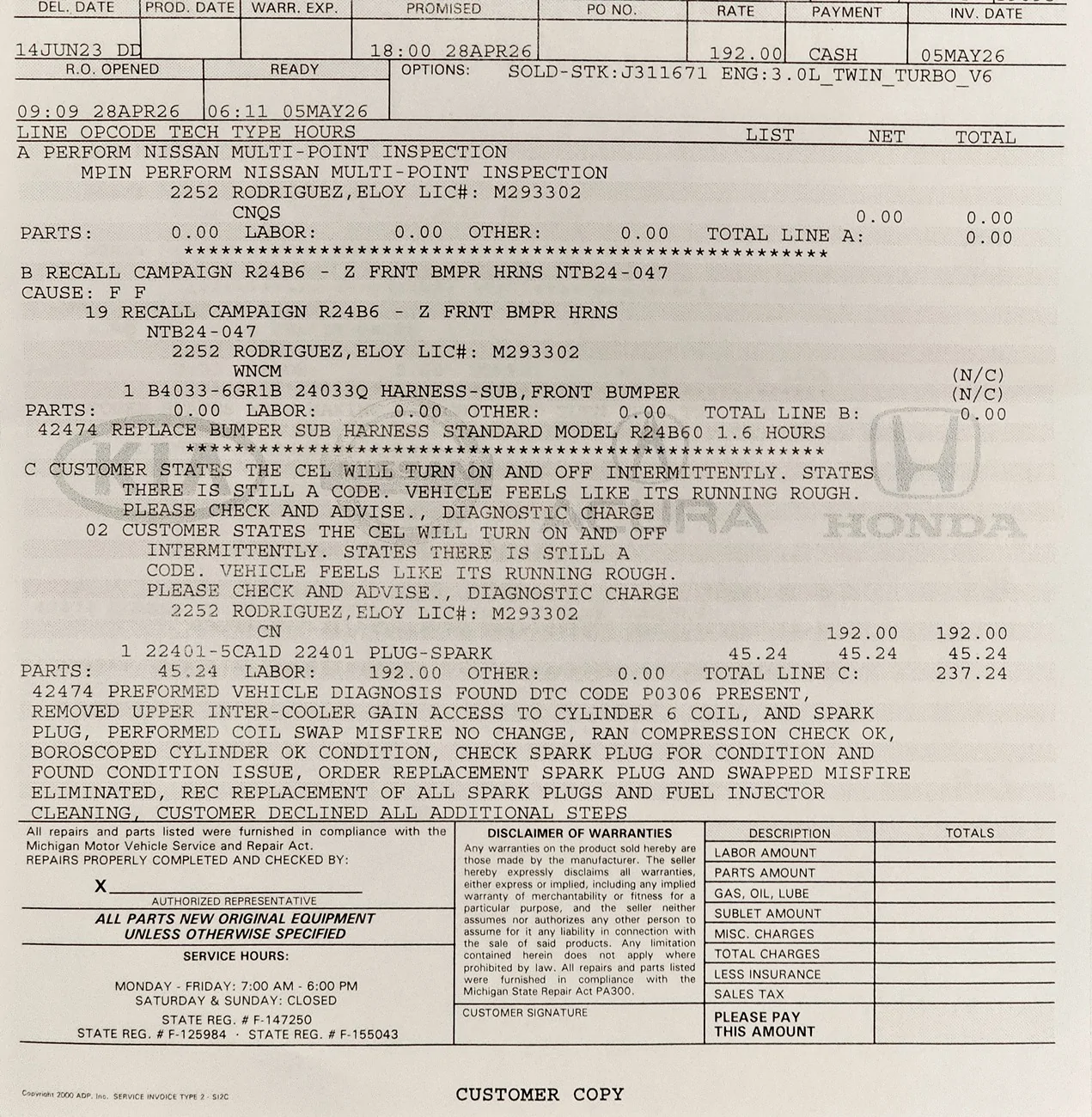

Anyway, after a few days, the service guy called me and said it was the Cylinder 6 Spark Plug. I'll admit, you guys were right.
But the quote was $900 😵. It's a 'wear item', of course, so no Powertrain Warranty.
He said he did a coil swap, but the problem persisted. Then "we ordered and replaced #6's plug and the problem went away. But we would want to replace all of the plugs because they wear the same". He threw in an Injector Cleaning too. Needless to say, I declined.

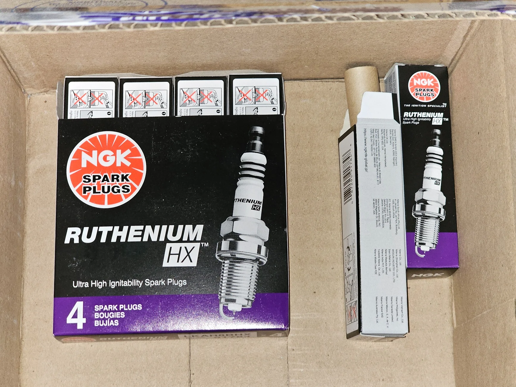

So, I set about doing the plugs myself.
It was actually very easy, once you get passed the intercoolers, and the brace bar, and the stupid zip ties, and the wires deliberately placed tightly over the coils...šŸ˜®ā€šŸ’Ø. But it got done. And I was rewarded! It's got its MOJO back! Zero problems. I'll be sure to drive it harder for the injectors lol.

I forgot to include the service sheet.
