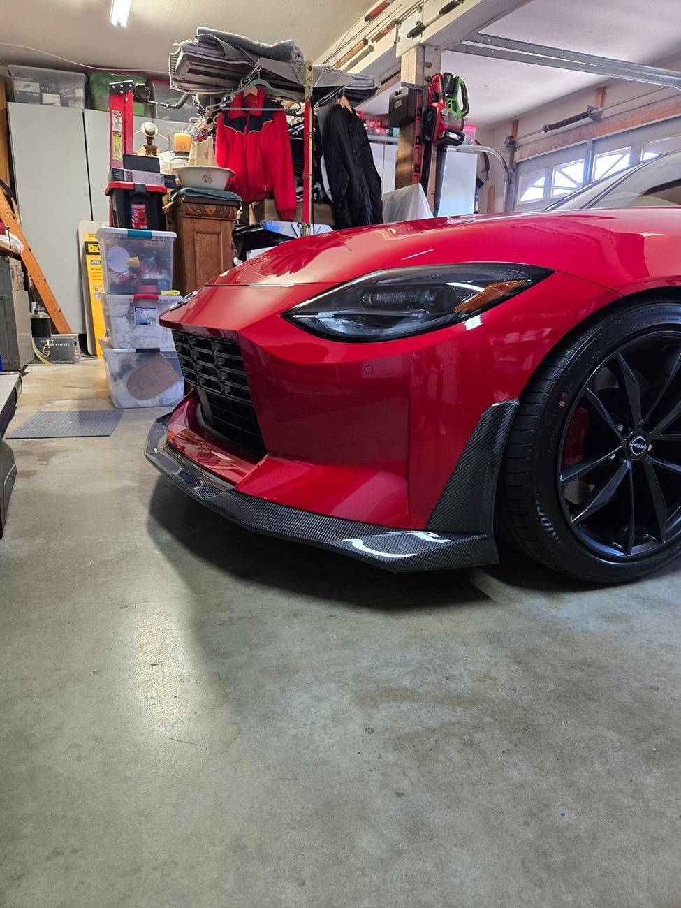

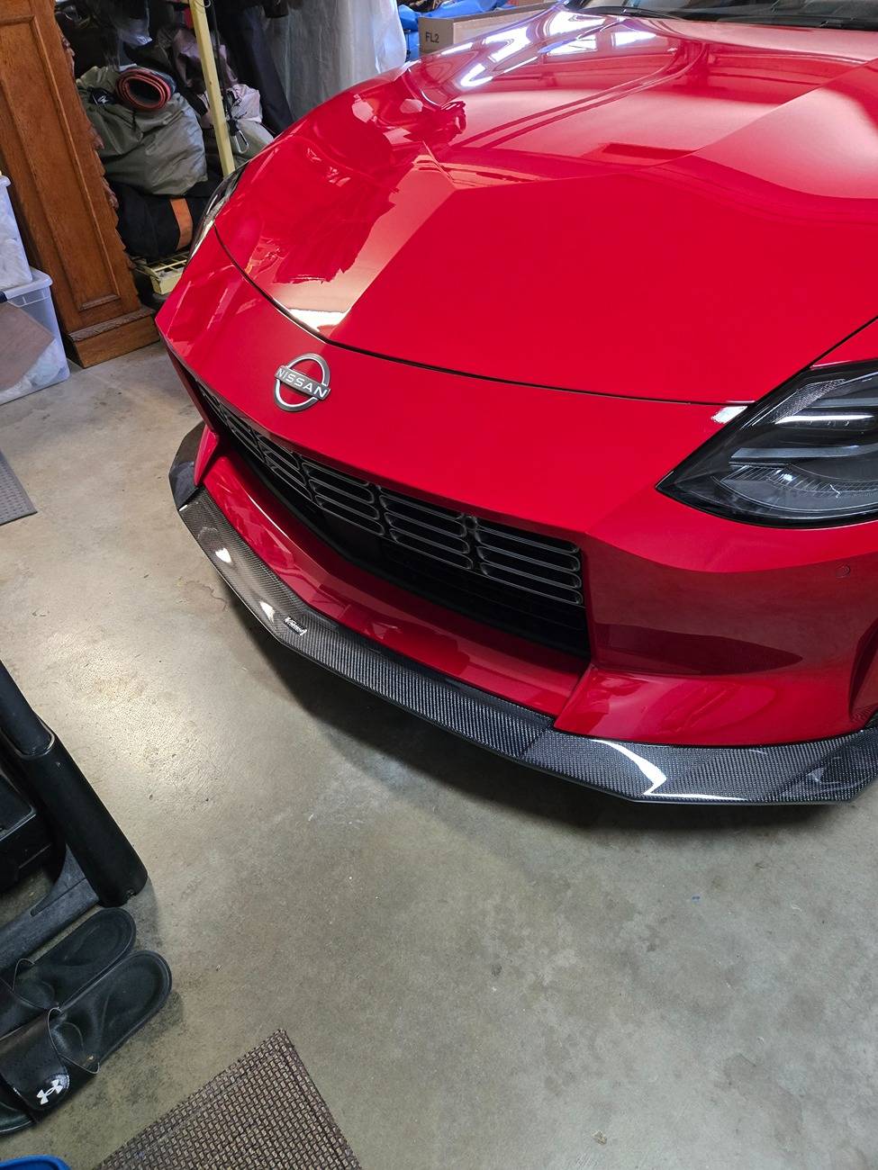

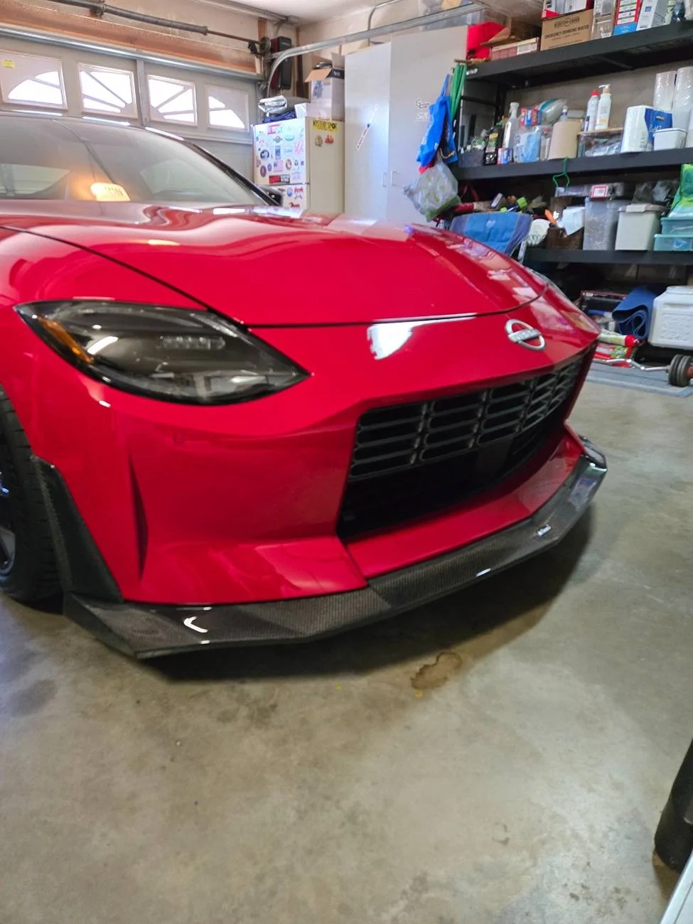

I like the fully blacked out center lower lip thing. Would have done it on my '03 Track if the car hadn't already been black. Looks really good on the RZ34!

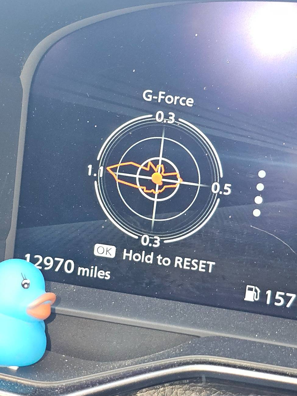

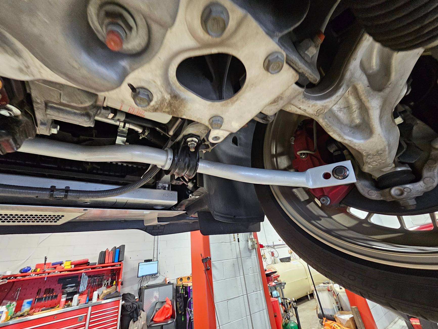

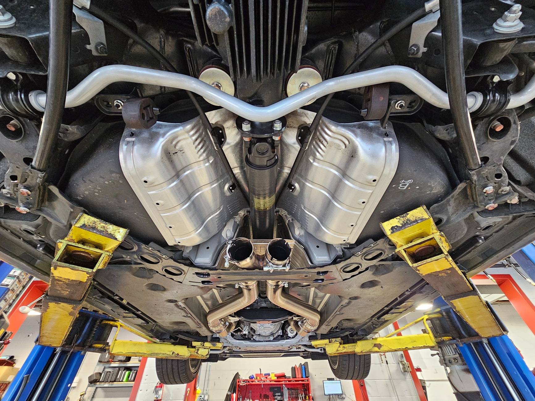

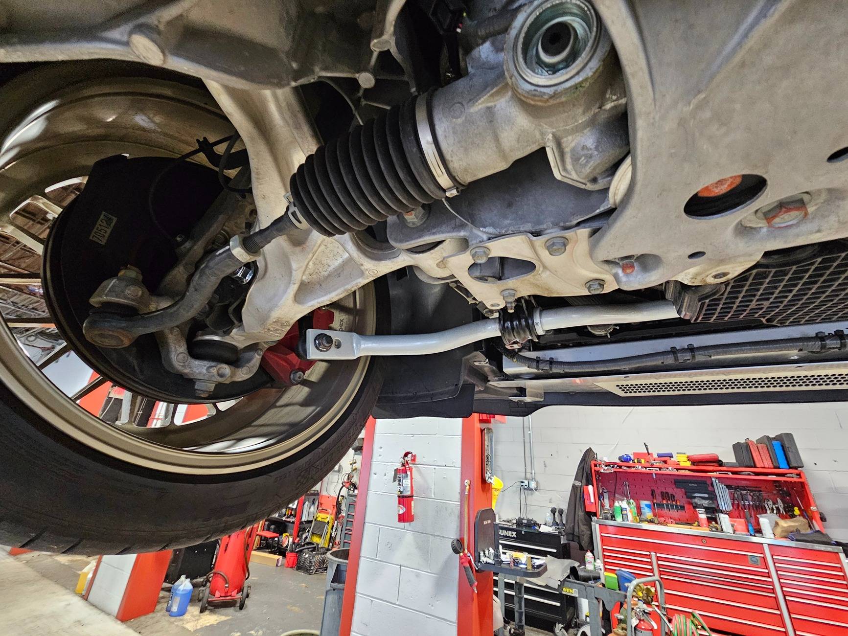

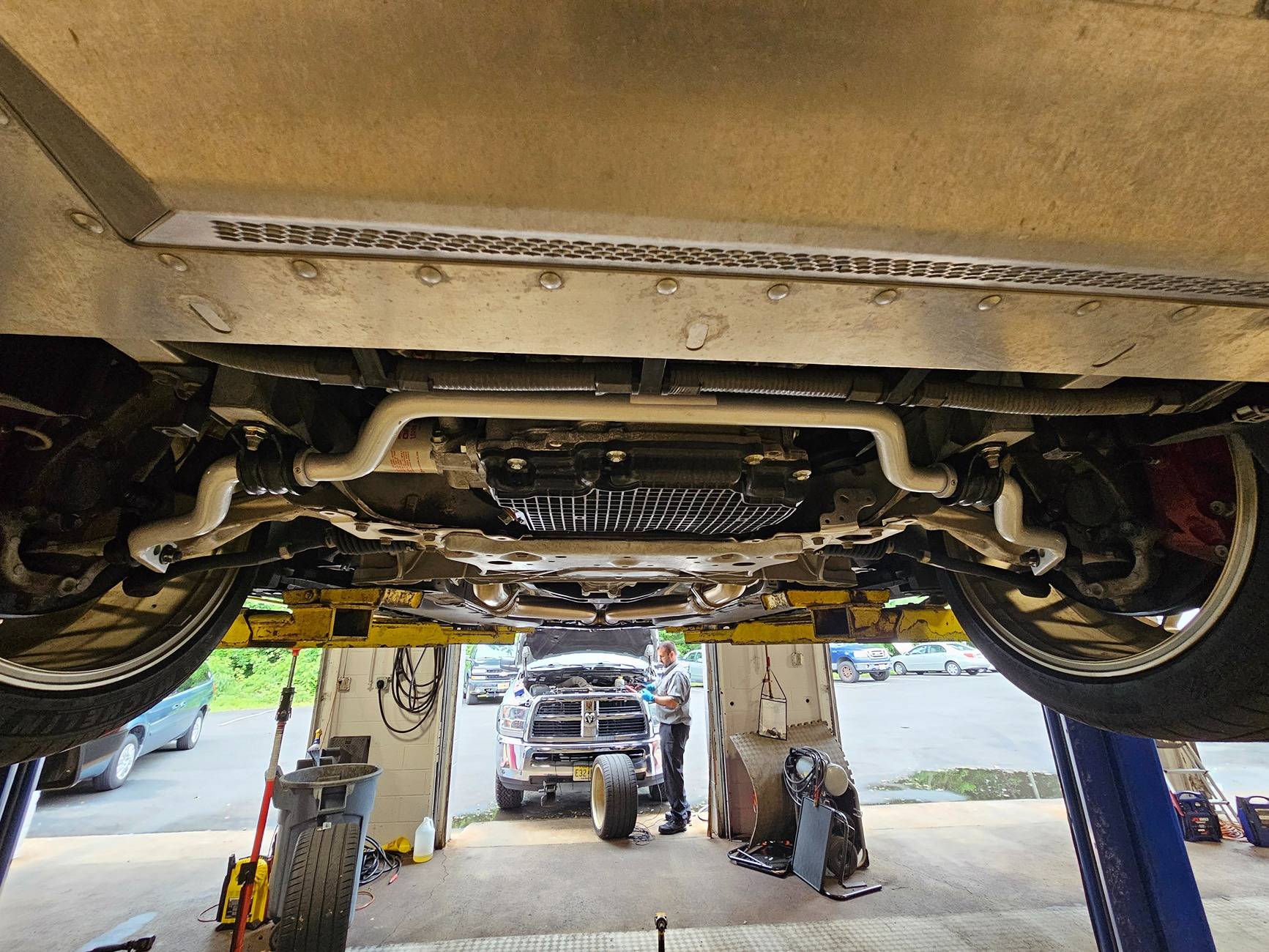

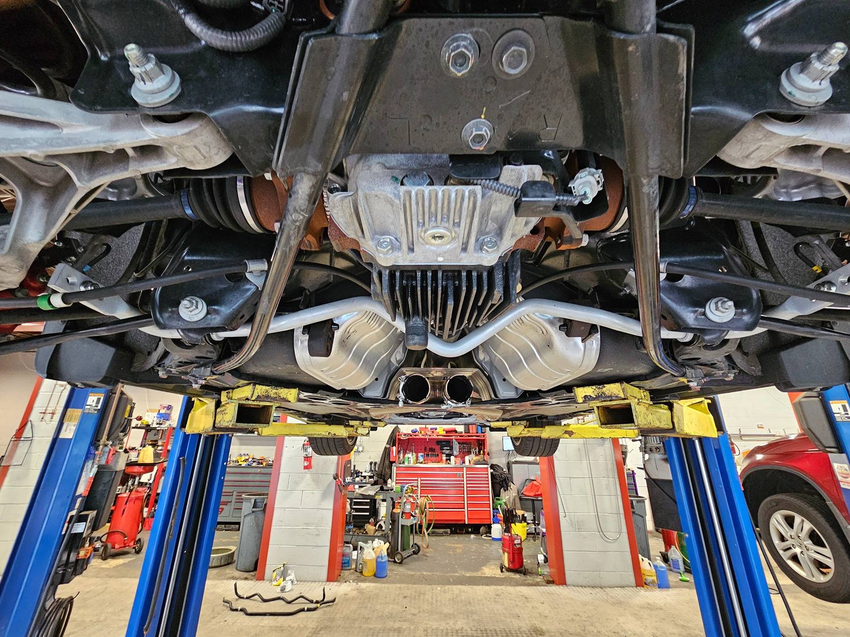

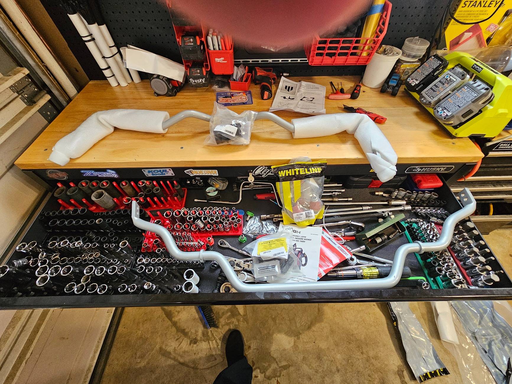

Monday I installed my Whiteline front and rear solid sway bars with end links - 27mmF and 25mmR - not bad at all - 2.5 hours
Tues pulled over 1g on an exit ramp at 80+ not even close to losing grip, no push and minimal body roll. Car feels stiffer - NO NVH at hall.

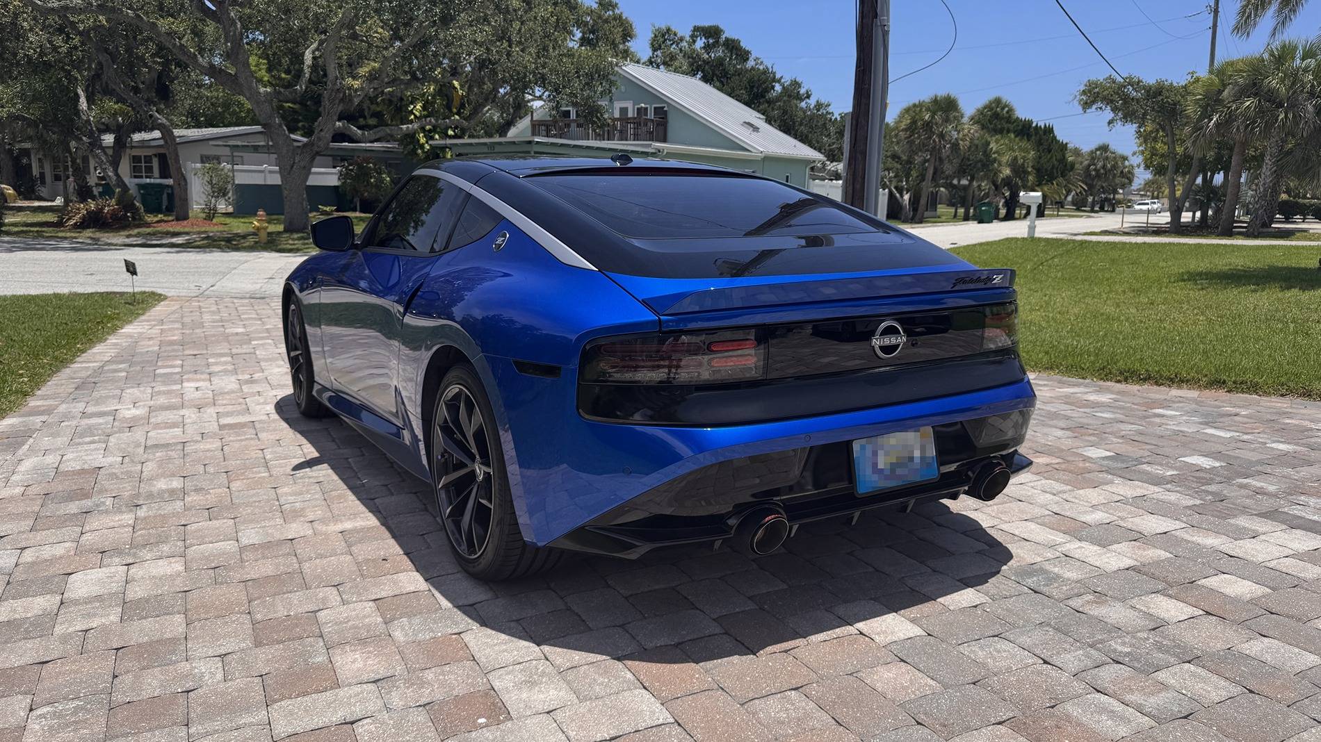

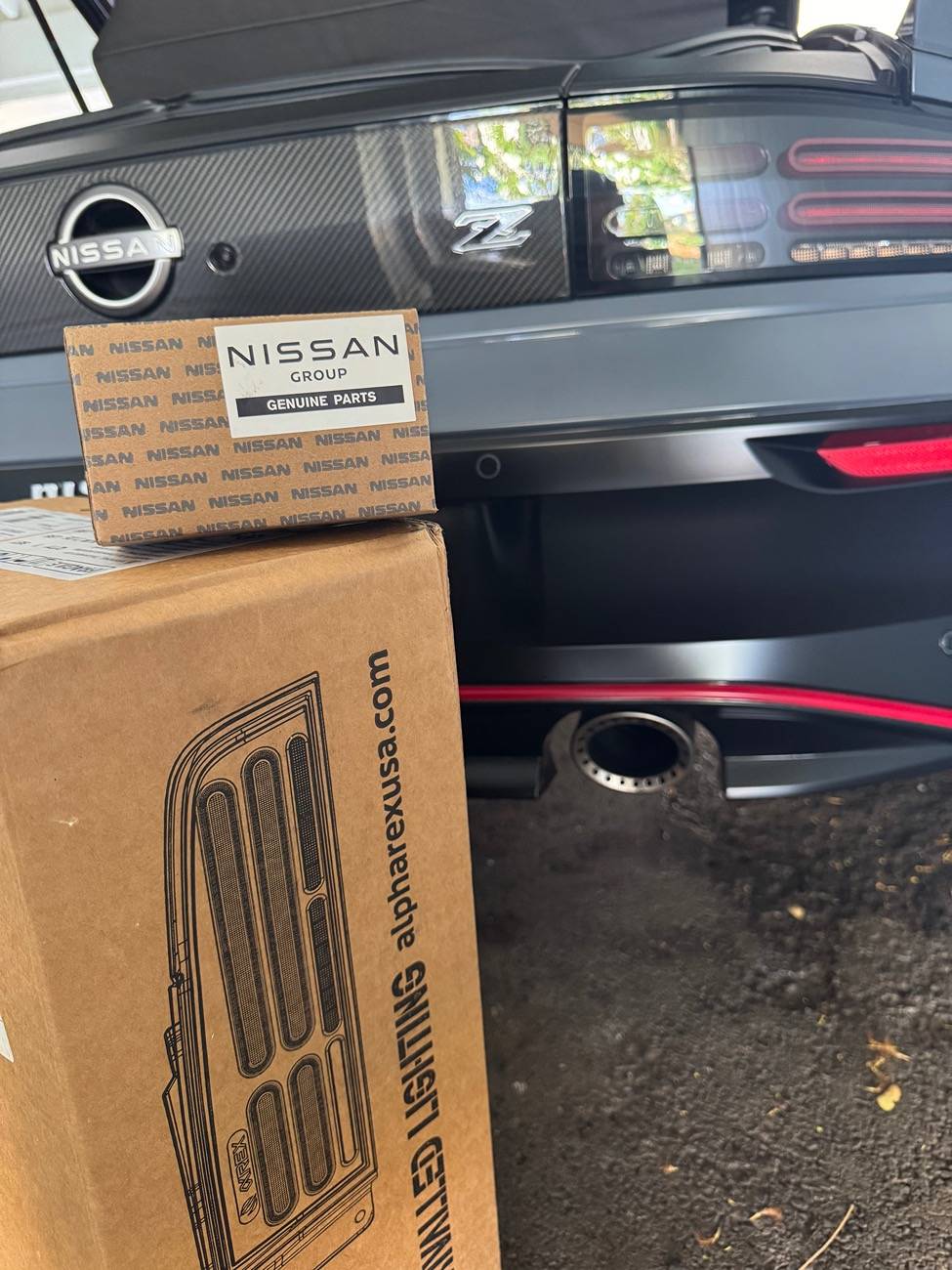

Time for some rear end upgrades!
Upgraded taillights? I’ve also never seen the CF on the center rear panel before either . Looking good!

Yea Boi!!!!! Now it drives like the way it looks! U Like that !!!!! Love it!

Looks like u went mid stiff front and full soft rear.
No front has the 2 options went normal front medium rear. Now that I tried it im going to change to stiff front and rear snd see probs tomorrow

I decided to go full stiff front and full soft rear myself. Let us know how you like it.
CF in all the right places is magical lol
Thx! Just a few gloss CF pieces really pop with the matte wrap.
