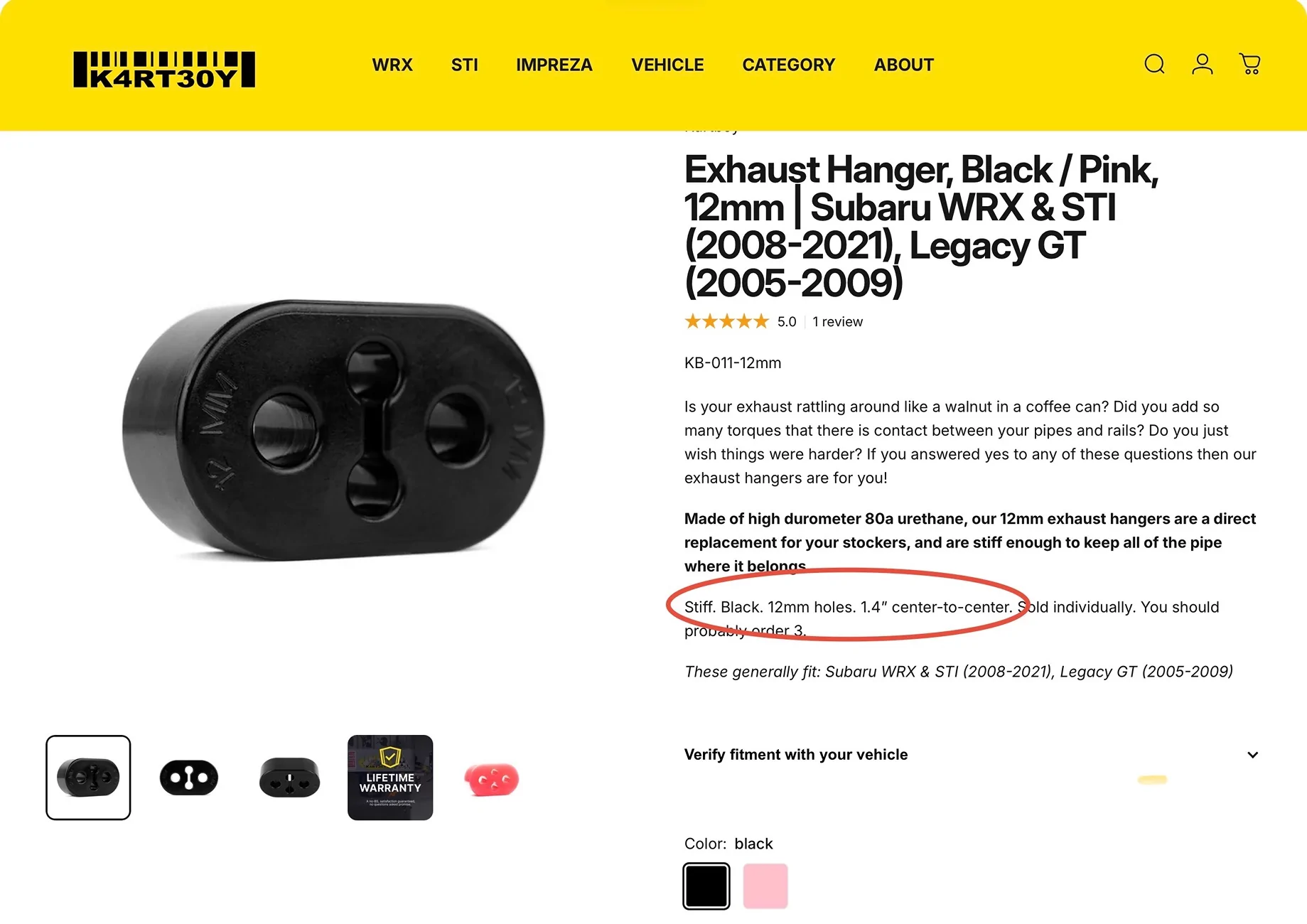

Yes - took care of my issue rubbing on the lower center brace. I‘m guessing it adds ~1/2+ clearance to the lower center brace. They are ~1/8” shorter & much stiffer - they don't sag as much as the stock hangers.
before installing these hangers, i had decent clearance after the “krackaC8” mod but it would still have contact with the lower center brace intermittently.
another option would be to add thick washers or shim plates between the lower brace and body for the four mounting bolts near the cross over end of the brace.

Yes - took care of my rubbing issues on the lower center brace. I‘m guessing it adds ~1/2+ clearance to the lower center brace. They are ~1/8” shorter & much stiffer - they don't sag as much as the stock hangers.
another option would be to add thick washers or shim plates between the lower brace and body for the four mounting bolts near the cross over section of the brace.
before any mods - make sure the x-pipe is parallel (level) to the lower center brace so that both resonator pipes have the same clearance to the brace. After that i was able to hold the resonator sections up by hand with plenty of clearance while tightening the clamps - but they would drop down when i let go because the hangers sagged too much.

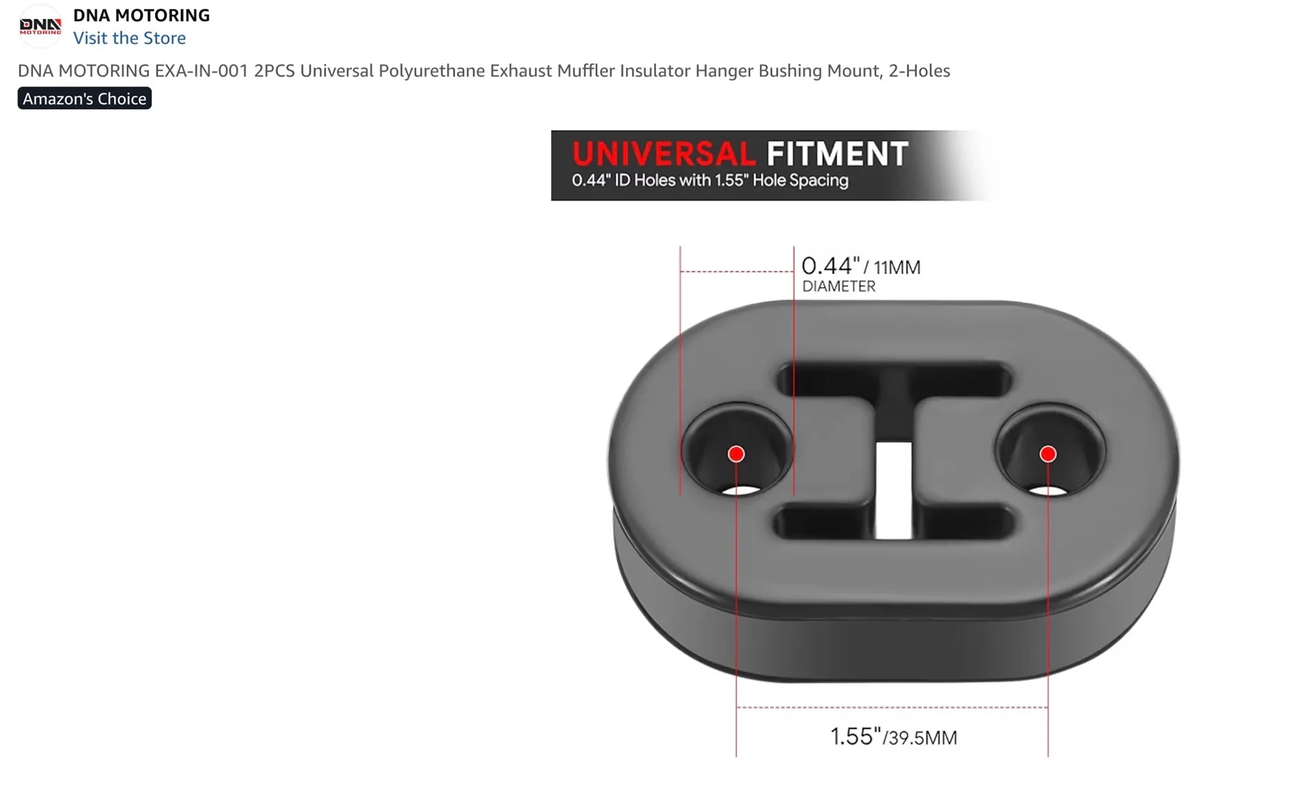

Here are the hangers I'll try:

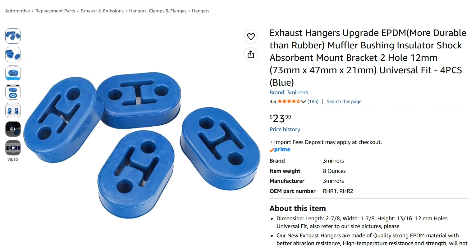

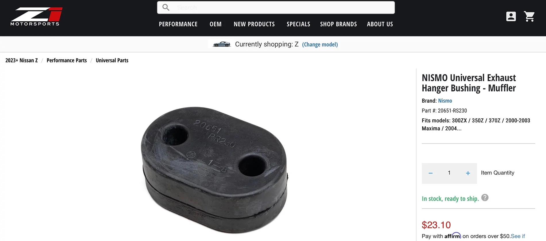

I don't think those will help. I bought a similar set with the stock “H” pattern made from polyurethane and they were flexible same as stock. Polyurethane should be stiffer than EPDM rubber, but I’m not sure.
I also found a nismo hanger @ Z1 that looks good but size was not listed so i bought the ones i posted. The second pic is the ones that were flexible like stock hangers. The third pic is the ones i used - they are shorter and much stiffer than stock.
Thanks again for sharing all this. You likely just saved me from a wasted purchase. I didn't pay attention to the H design but I see what you mean. I cancelled the cheap Amazon ones and I'll be the guinea pig on the hangers from Z1 (they're pricey little rubber blocks for me after currency conversion and shipping). I figure the solid design should have the least amount of play and the size looks to be about the same. Our roads are terrible (condition and debris) so I would like to get the exhaust as high as possible.
