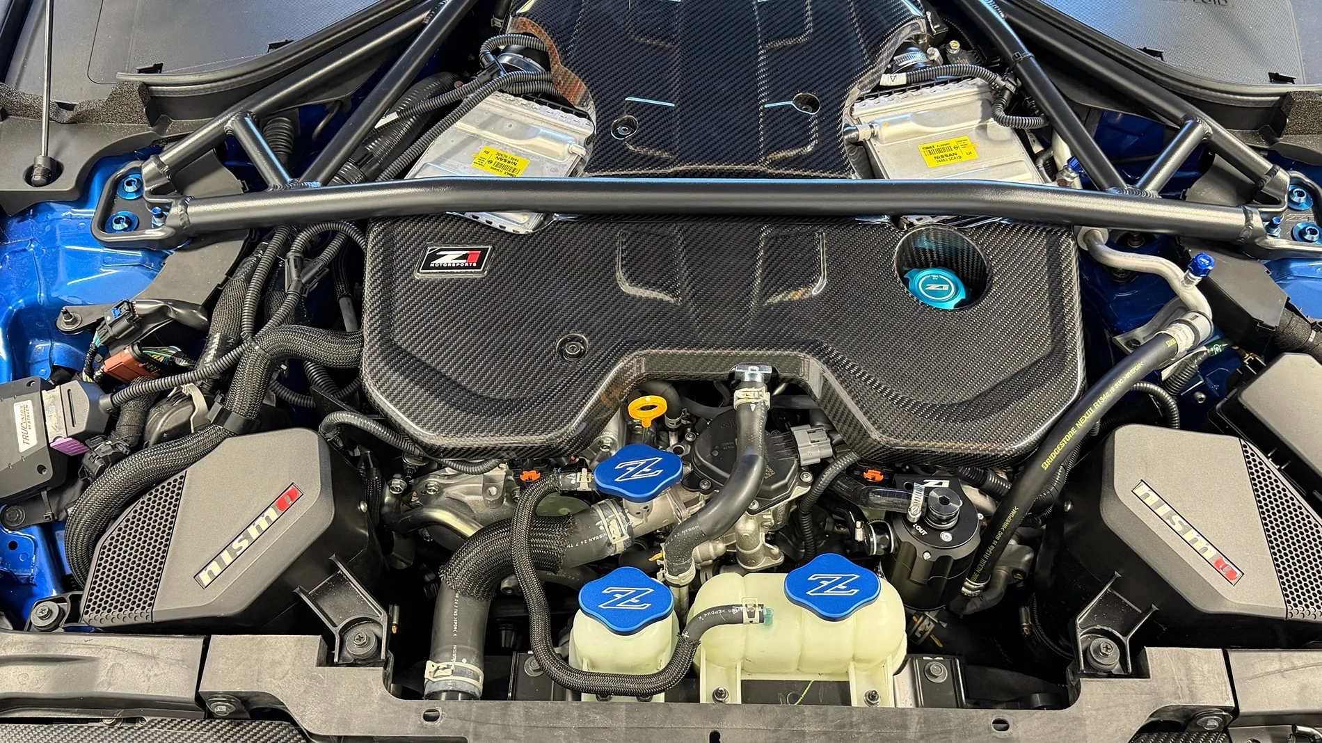

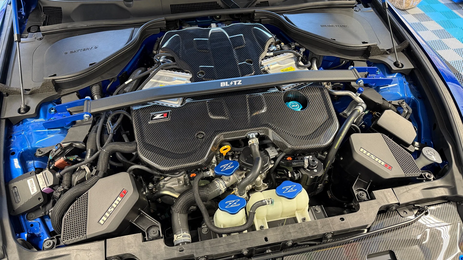

I finally decided to remove my Z1 3-point brace today in favor of the Blitz brace. The Z1 brace introduced near non-stop knocking sounds in the cabin. I’ll be selling the Z1 brace if anyone is interested.
I’m in love with Blitz brace. It looks very basic in pics but the fitment is outstanding, way more room between it and the cover, and no more knocking!
However simple, it does 100% of what it’s supposed to do.
Is the Blitz aluminum?
The OEM bar is HEH-VEE!!!

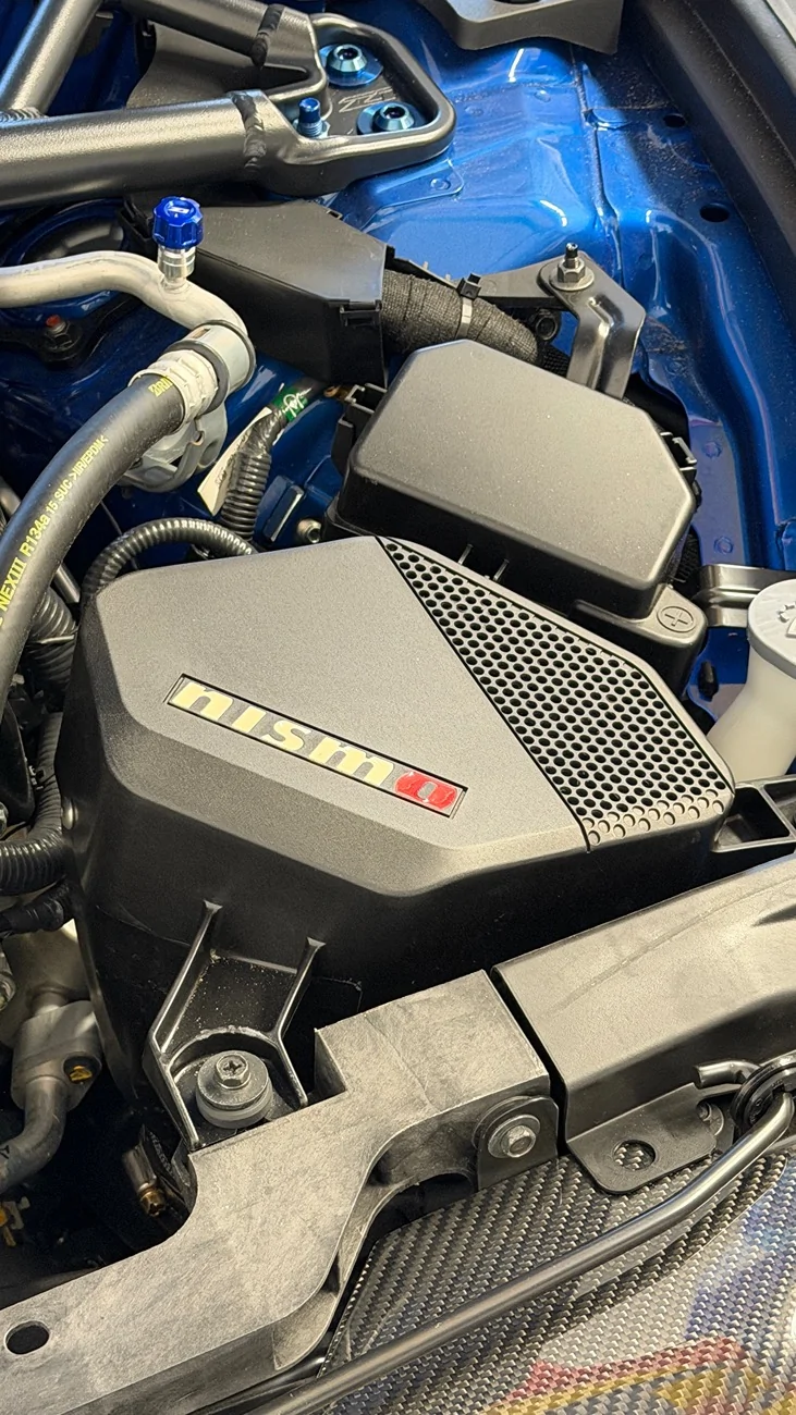

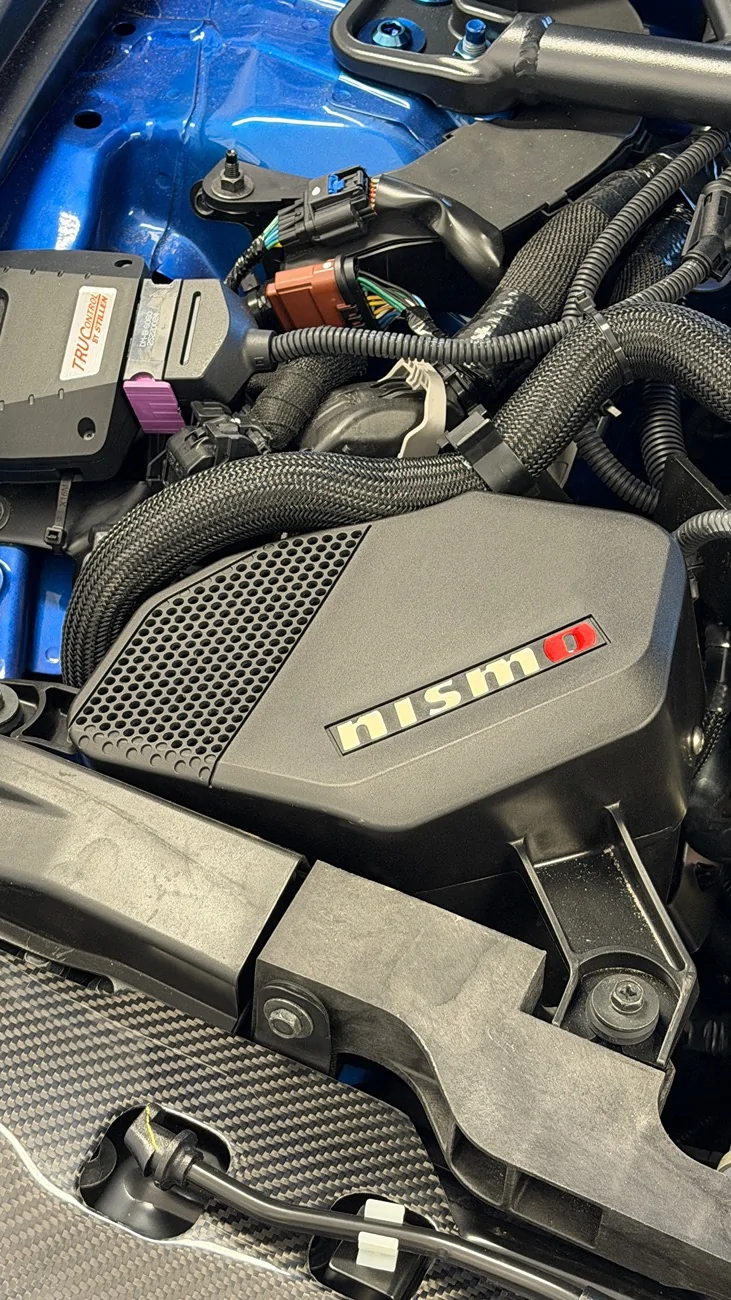

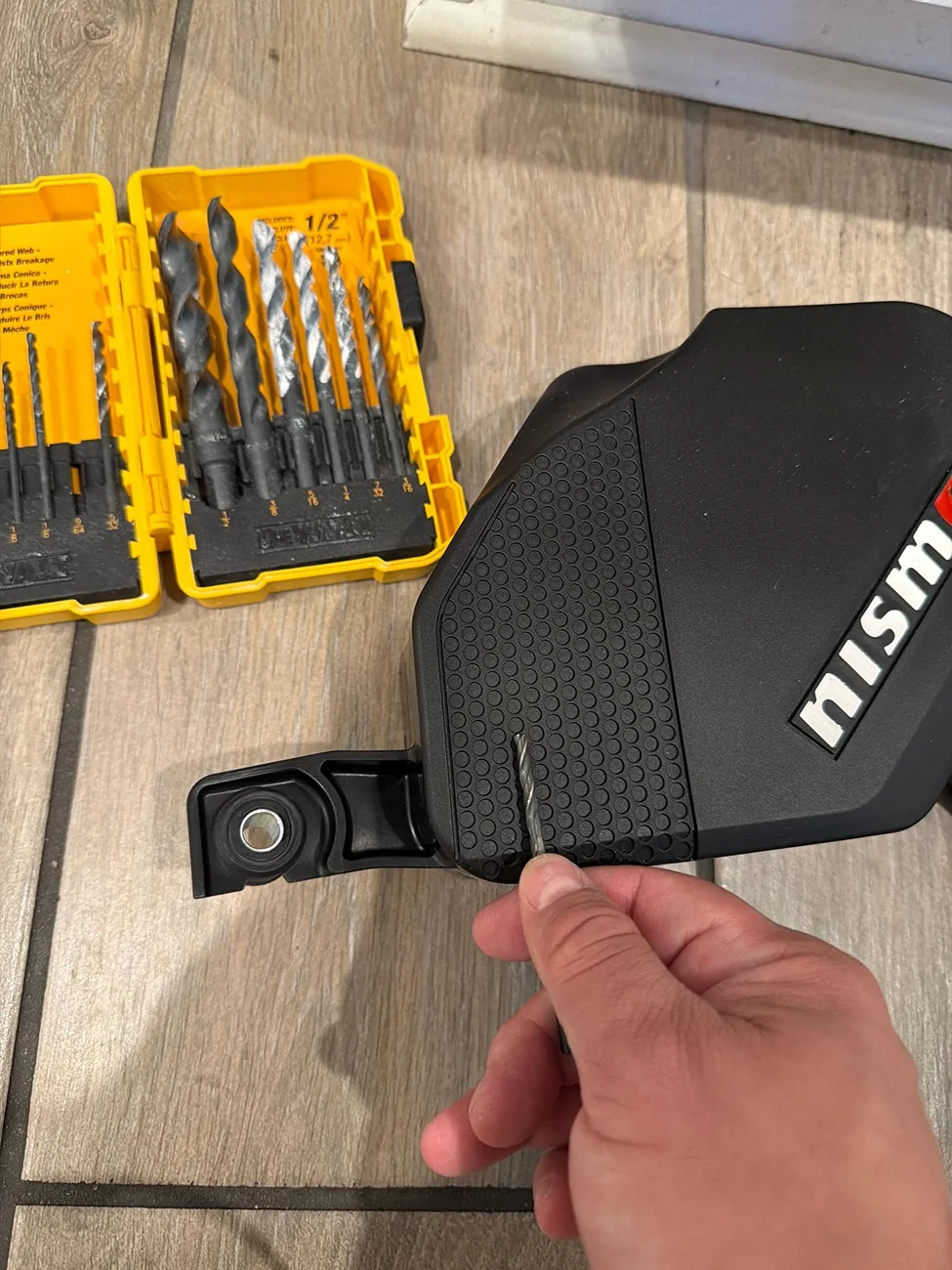

Got one box drilled. Outside came out clean. the dimples are just dep enough to perfectly center the drill bit. Lots of cleanup/deburring on the inside. I’ve done a little. A little being at least 30 min. Probably don’t need baby’s-butt-smooth anyway.
Yep! The Blitz one is also aluminum and WAY lighter than the OEM one.
Drilling out those holes is an exercise in zen. I didn’t worry about something all of it out either. Plastic is going to burr up no matter what you do. Just get very excited for your first ride after! SPOOLY SOUNDS FOR DAYS

Did the induction noise with the holes drilled out increase a lot or just a little? Also what size of drill bit did you use?

Can’t remember who, and I don’t believe there were pics, but someone here said they used a drill bit the same size as the little dimples opposite the NISMO logo and drilled all of those spots out.
I was just curious if the drilled holes made it sound the same without the boxes on. Although I’m into stuff like that with scale modeling and I’m used to using pin vises to drill stuff out, this would be incredibly easy, but seeing traska_rz34’s work is insanely sweet 😍😍😍

I forget the exact size drill but the noise difference was substantially louder with the holes. Without them, it was silent.
Thank you, I record both open and closed boxes yesterday and noticed the difference and was trying to find a happy in between!
my 9/64 mm fits perfectly
