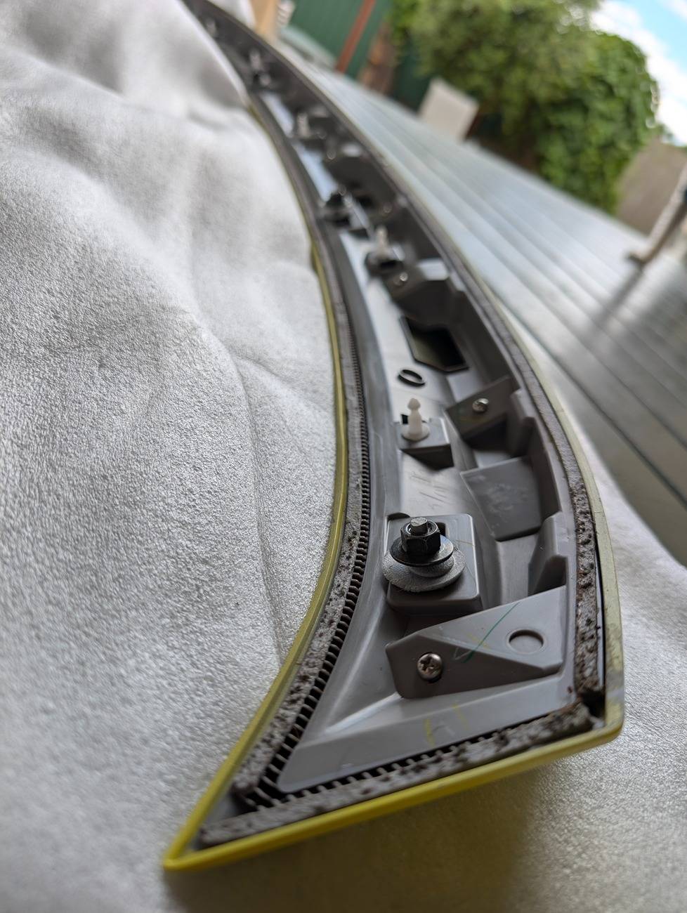

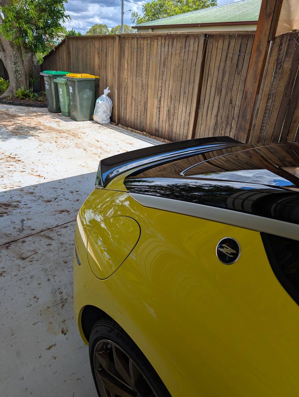

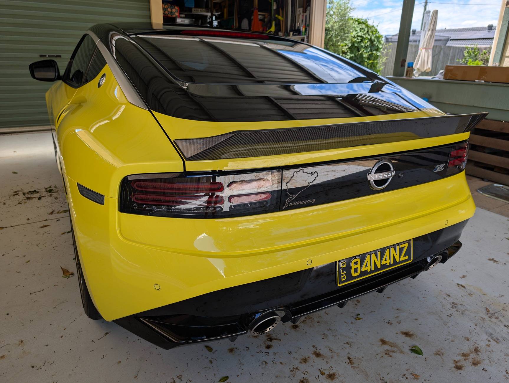

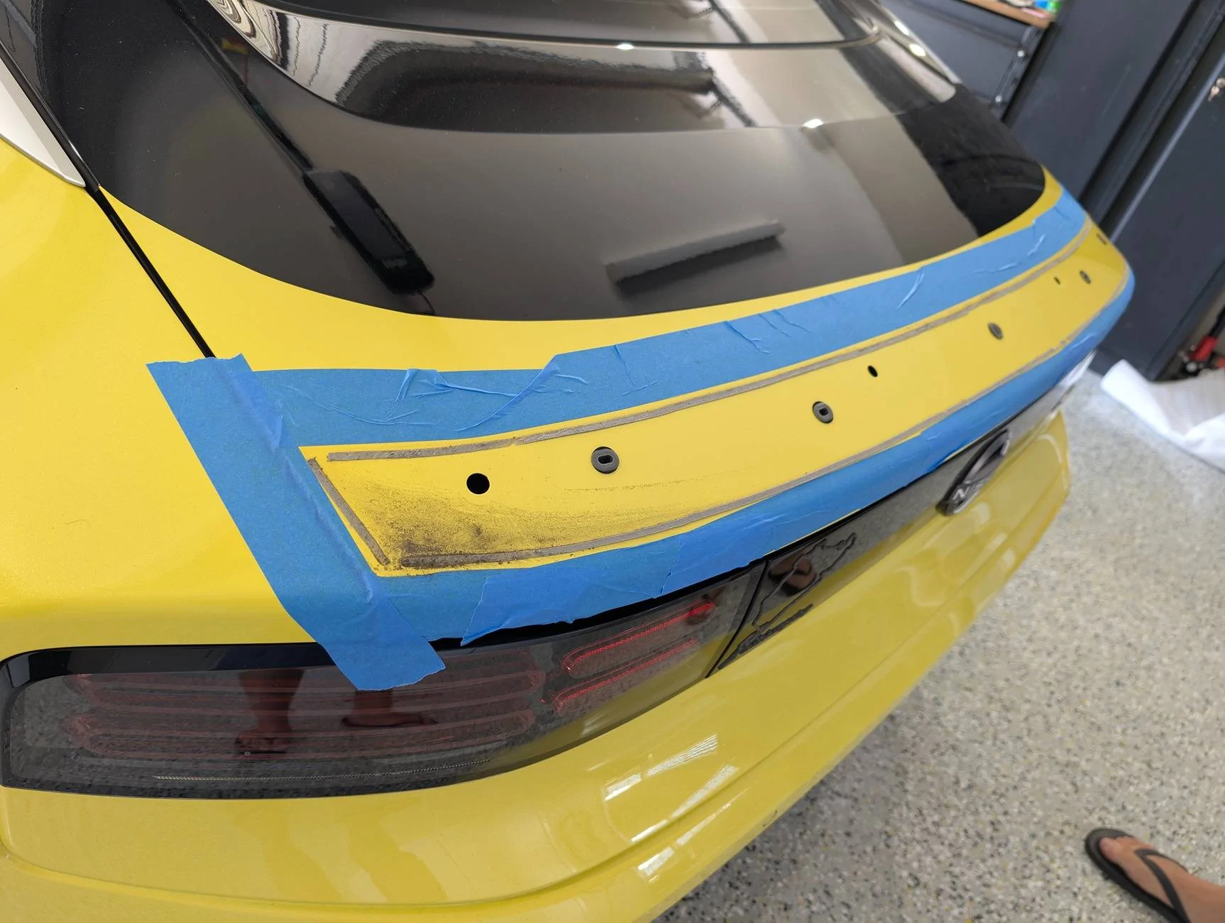

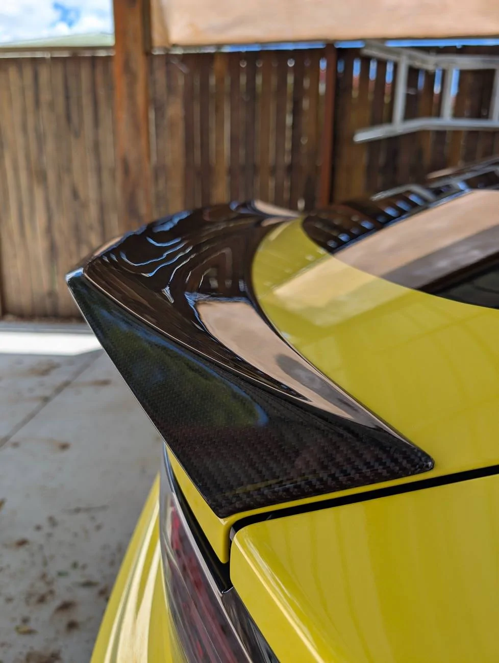

Installed the Boosted 6 Carbon ducktail a few weekends ago. Getting the old one off was fun :crazy:
Also amazing how much crud had already collected under the factory wing.
All in all a nice bit of kit and great quality.

How did you break the two sided tape? I heard fishing line helps.

Saw it today. Looks great in the flesh.

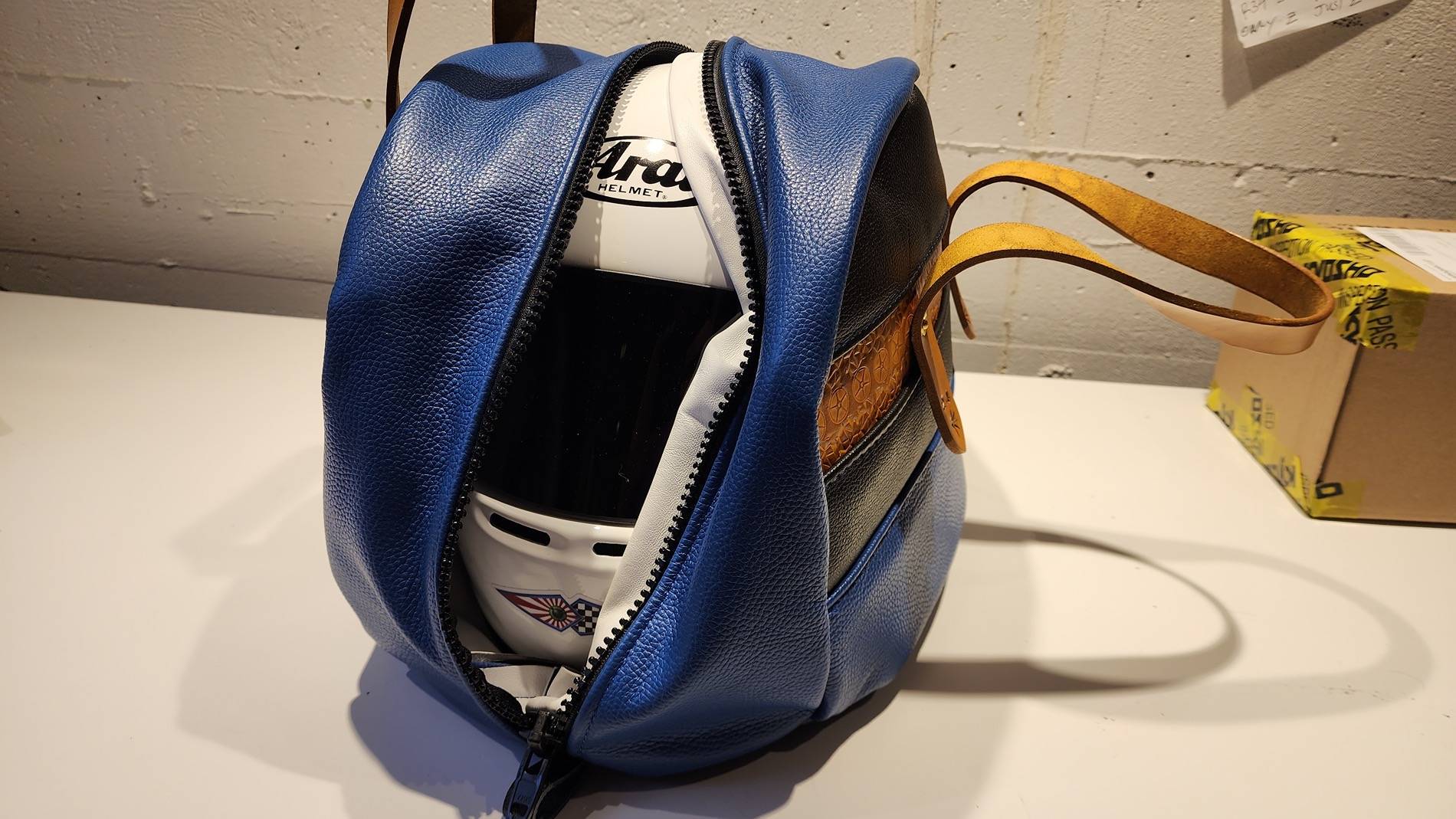

Again, not to the Z but because of it, I made myself a helmet bag.
It’s one way to stay off the streets.
Great idea. Im stealing this. I been using the sock the helmet came it. Carrying by the drawstring sucks lol
Is that a bowling ball bag?
You answered your own question. Fishing line works for all double sides adhesive.
I use a hair dryer to heat up the tape in sections. I been doing it this way for yrs and makes the fishing line cut through like butter
